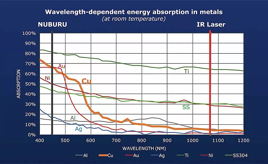

This graph shows how copper absorbs blue light better than infrared and green radiation. SOURCE: NUBURU INC.

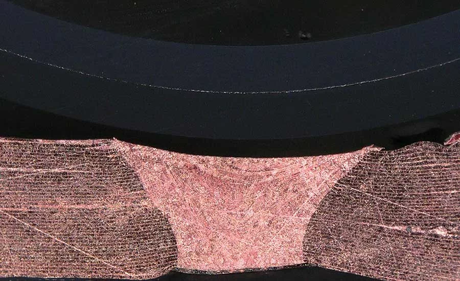

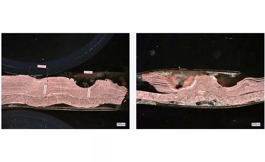

Battery foils are just a few microns thick, which makes them tricky to weld. These photos show a stack of 42 foil layers, each 8 microns thick. These photos show foils joined with ultrasonic welding. PHOTO COURTESY NUBURU INC.
Blue Lasers for Welding Copper
Battery foils are just a few microns thick, which makes them tricky to weld. These photos show a stack of 42 foil layers, each 8 microns thick. This photo shows foils joined with a blue laser. PHOTO COURTESY NUBURU INC.

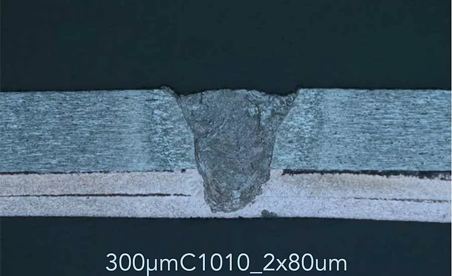

The blue laser inherently allows a wide range of exposure parameters for welding different materials and geometries. This photo shows two copper tabs, 80 microns thick, welded to a cylindrical steel case, 300 microns thick. PHOTO COURTESY NUBURU INC.

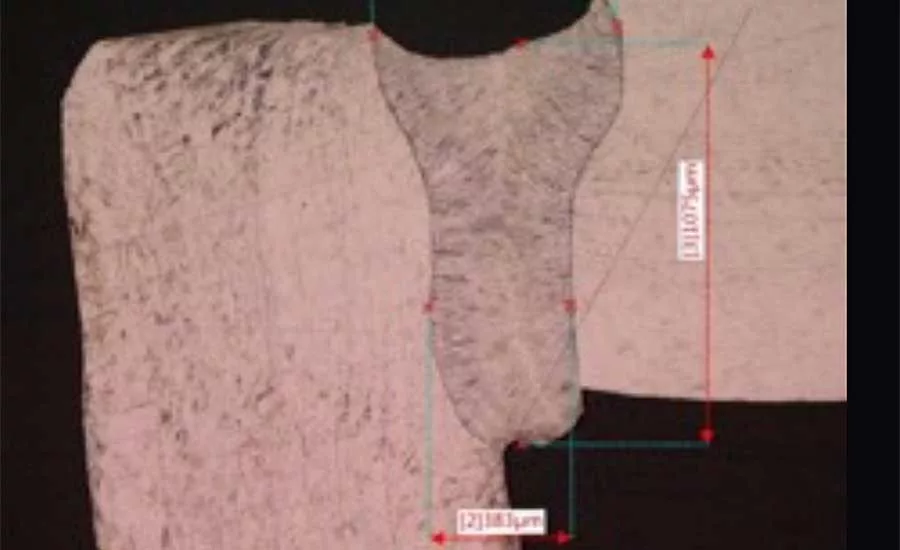

The blue laser inherently allows a wide range of exposure parameters for welding different materials and geometries. This photo shows two steel case components, 1.2 millimeters thick. PHOTO COURTESY NUBURU INC.

It sounds simplistic, but the first step in laser welding is to transfer energy from the beam to the target material. The amount of energy transferred depends on the wavelength of the laser, the composition of the target material, and the state of the material. Solid copper absorbs only about 5 percent of the energy from conventional IR lasers. That means there’s a lot of “extra” energy delivered to the workpiece, which is certainly inefficient. The real problem, however, comes when the copper has absorbed enough energy to melt.
Melted copper absorbs much more IR energy than solid copper. With melted copper, the “extra” energy now creates miniature explosions within the melt pool, degrading both the mechanical and electrical integrity of the joint. For some specific geometries, introducing nonlinear exposure patterns, or “wobbling” the beam, can minimize (although not eliminate) the defects, but that adds to the processing time.
Those problems are not an issue with the blue laser. Copper absorbs blue light 13 times better than it absorbs IR. Just as importantly, liquid and solid copper absorb nearly the same percentage of blue light. The proper exposure parameters to initiate a weld are the same as required to maintain the weld, which inherently leads to a wide process window for rapidly producing high-quality welds.

For example, lithium-ion batteries are built from cells composed of many layers of thin copper and aluminum foils. To generate charge, the foils must be separated by electrolyte, but to collect charge, the ends of the foils must be joined. Although ultrasonic welding can weld these foils, the quality of the joints is poor. The blue laser produces defect-free foil welds. Consumer electronics assembly presents similar challenges, requiring electrically and mechanically reliable joints between relatively thin copper components. Early models of the blue laser, producing up to 500 watts, were able to produce such defect-free joints.
