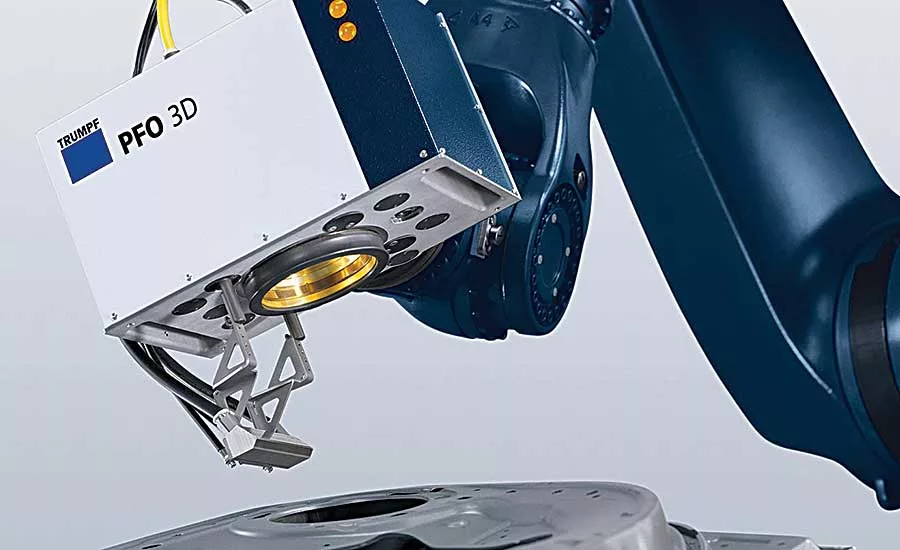

Programmable focus optics allow engineers to use the laser for different types of welds, such edge-filling welds, spot welds or staple-type designs. Photo courtesy TRUMPF Inc.

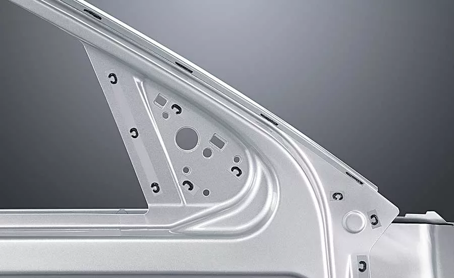

One advantage of laser welding is its ability to produce welds of varying geometries, like the C-shaped welds on this door. That can make for stronger welds and allow engineers to use thinner materials in their designs. Photo courtesy TRUMPF Inc.

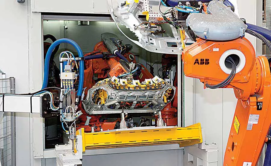

The hood of the MINI Cooper is welded with a laser. Photo courtesy MINI

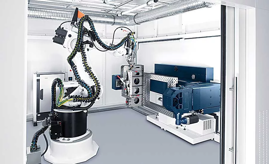

The Trulaser Robot 5020 is a standardized, modular robotic cell for laser cutting and welding. In addition to the laser, optics and robot, the system comes complete with positioning equipment and safety enclosure. Photo courtesy TRUMPF Inc.

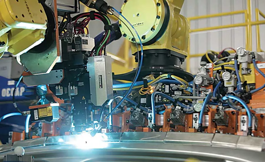

A laser is used to weld the aluminum roof of the Cadillac CT6. Photo courtesy General Motors Co.

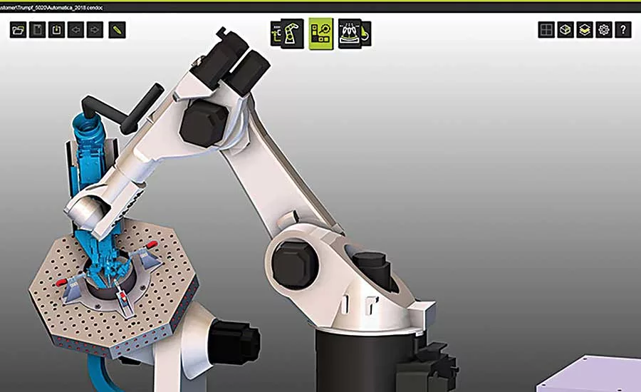

Fastsuite Edition 2 software enables engineers to program robotic laser welding systems from TRUMPF and other vendors. Photo courtesy CENIT North America Inc.

Another advantage of laser welding is its ability to produce continuous seam welds, parallel welds, and C- or S-shaped welds. That can make for stronger welds and allow engineers to use thinner materials in their designs. It is especially useful for high-stress areas where spot welding has traditionally been used.
For example, laser stitches can replace the resistance spot welding seam used to join the upper roof frame and lower rocker panel. For the A or B pillars, continuous seams can replace stitches and eliminate the need for additional reinforcements.
“For a lap weld, instead of just a straight line running across the joint, imagine doing the weld with a zigzag pattern or a swirl pattern,” explains Harris. “Or, imagine making a line of stitch welds, each 5 millimeters long, and spaced however you want. It happens very fast.”

A key enabling technology for robotic laser welding of auto parts is TRUMPF’s Programmable Focus Optics (PFO), which position the laser beam within the processing field using two mirrors. The mirrors change direction in a precise and highly dynamic way. The technology allows the laser beam to be positioned anywhere within the processing field. It can also guide the laser beam along any desired contours. Process sensors monitor the material surface and direct the PFO to adjust the beam path.
Since neither the workpiece nor the optics have to move, PFO enables a high degree of productivity. And, due to the plane field lens, the focusing conditions—and therefore the processing quality—are identical at every point in the processing field.
PFO technology is especially well-suited for welding large workpieces, such as vehicle doors.
“PFO allows you to create different weld geometries and different types of welds,” says Harris. “It may be may be a fillet weld, a spot weld, or a staple-type design. It allows for a lot of creativity in designing welded joints, especially for enclosures.”

3D Simulation and Offline Programming for Robotic Welding
Fastsuite Edition 2 software from CENIT North America Inc. enables engineers to program and simulate robotic arc welding and laser welding operations. The software creates accurate, error-free, homogeneous welding programs for everything from single-robot setups to complex welding cells, regardless of the robot brand or model, including multiple robot environments with a multitude of components.
Engineers can import data from any CAD system, including STEP, IGES and JT-integrated, direct interfaces to CATIA, NX and SolidWorks. Weld-line definitions can be created directly from 3D CAD data, including automatic approach and retract motions. Process parameters, such as weld line offsets and gun distance to part are easily adjusted through a user-friendly interface. Engineers can select a “welding procedure specification” from a customizable database of approved weld parameters.
The software also provides for automatic positioning and interpolation of external axis and workpiece positioners.
Recent upgrades enable engineers to program the TruLaser Robot 5020 or TruLaser Weld 5000 from TRUMPF Inc., the FLW 4000 M3 laser welder from Amada America Inc., and other systems.
