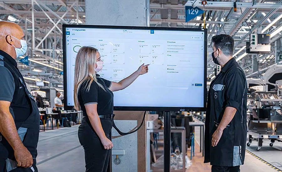

The MO360 system enables engineers and managers to optimize production based on key performance indicators. PHOTO COURTESY MERCEDES-BENZ

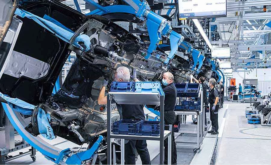

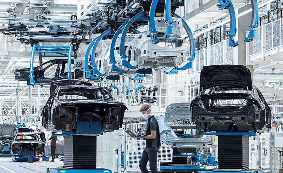

Vehicles on the line are brought into the most favorable working positions for assemblers by a rotating overhead conveyor. PHOTO COURTESY MERCEDES-BENZ

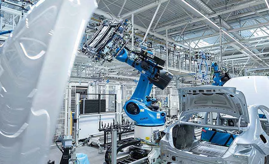

New models—from compact cars to SUVs, gas, hybrid and electric—can be integrated into series production in just a few days. On just one level, Factory 56 can perform all assembly steps for vehicles of different designs and drive systems. At first, the new generation of the Mercedes-Benz S-Class sedan and long-wheelbase version will drive off the assembly line. Later, the Maybach S-Class and the EQS, the first all-electric S-Class, will also be assembled on the same line.
What Mercedes calls “TecLines” serve to avoid fixed points in the assembly process. The traditional assembly conveyor has been replaced by driverless transport systems. To integrate a new product or process, engineers only need to change the route of the automated guided vehicle (AGV). More than 400 AGVs traverse a pair of TecLines at the factory.
The plant also rethought the “marriage process,” in which the vehicle body is connected to the chassis and drive system. The factory’s “Fullflex Marriage” lines consist of several modular stations that easily convert from one vehicle model to another, thereby avoiding long production interruptions for changeover.

The MO360 system enables engineers and managers to optimize production based on key performance indicators. It also makes individual, needs-based information and work instructions available to each employee in real time. Major elements of MO360 are already in use at more than 30 plants around the world.
In Factory 56, a new, digital infrastructure with a high-performance WLAN and 5G network provides the basis for full digitization. This enables the plant to take advantage of Industry 4.0 applications, such as smart devices and data analytics.
Digital production technologies have been implemented everywhere. For example, Factory 56 is completely paperless. Thanks to digital tracking of each vehicle on the line via a positioning system, the vehicle data that are relevant to employees are displayed on the line in real time, using digital devices and display screens. All totaled, this will save about 10 tons of paper each year.
Machines and production equipment are interconnected throughout the entire factory; most of them are already Internet-of-Things capable. Digital technologies such as virtual and augmented reality were used during the development and planning of Factory 56, and also help to make series production more flexible and efficient. In cooperation with suppliers and transport service providers, various tracking and tracing technologies allow material flows to be traced digitally around the world.
“Factory 56 is our most advanced automotive production facility worldwide,” says Jörg Burzer, manager for production and supply chain at Mercedes-Benz. “Everything here places people at the center of things. Thanks to MO360, we are making production processes in Factory 56 even more transparent and setting milestones in digital production.”

Ergonomics were an important factor in designing Factory 56. All assembly stages were evaluated for ergonomics at an early stage. Vehicles on the line are brought into the most favorable working positions for assemblers by a rotating overhead conveyor or the mobile platforms. All workstations are height-adjustable.
