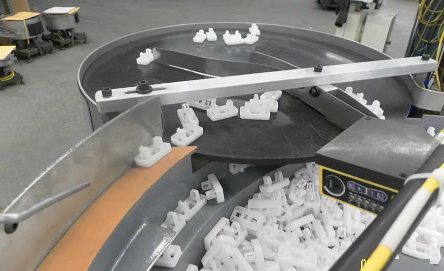

This flexible feeder that combined a simple cascade-style vibratory feeder with an indexing disk that presents parts to a vision-guided robot for pickup. Photo courtesy Vibromatic Co. Inc.

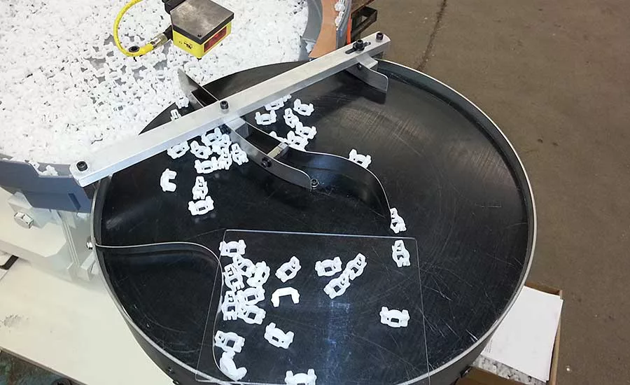

Made of plastic in various colors, the disk is easily swapped out so the vision system can readily detect dark-colored parts on a light background or light-colored parts on a dark background. Photo courtesy Vibromatic Co. Inc.

The manufacturer contacted Vibromatic Co. Inc. in Noblesville, IN, for help. Vibromatic developed a flexible feeder that combined a simple cascade-style vibratory feeder with an indexing disk.
This system presents the parts to the pick area for a vision-guided SCARA robot. After the robot picked up all of the available parts, the disk would index and repopulate the pick area with fresh parts for the robot to pick. Any parts not picked by the robot would be returned to the vibratory bowl to start over again. Made of plastic in various colors, the disk is easily swapped out so the vision system can readily detect dark-colored parts on a light background or light-colored parts on a dark background.
