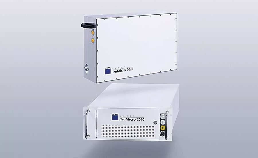

The TruMicro 2000 can create corrosion-resistant marks with a permanent high contrast appearance even on medical devices made from highly reflective materials. Photo courtesy TRUMPF Inc.

For example, the TruMicro Mark 2000 from TRUMPF Inc. produces extremely short laser pulses (0.4 to 20 picoseconds) of high energy (up to 20 microjoules). It produces corrosion-resistant marks that maintain their high contrast appearance even after repeated cleaning and sterilization.
The pulses emitted by the TruMicro Mark 2000 are short enough to enable cold material processing. In other words, the time taken to absorb the laser energy is shorter than the time required to heat up the surrounding material, so the machining of the material is completed before thermal processes can take effect. To mark the medical device, the high-power laser pulses initially produce a nanostructure on the device’s surface. This rough surface then creates a kind of light trap that significantly reduces the diffuse scattering of the light, causing the mark to take on a permanent dark black hue, a process known as black marking.
A major advantage of this method is that it allows the protective chromium oxide layer of the steel to re-form after processing, preventing the onset of corrosion. Black markings are ideal for rust-free stainless steels, aluminum, titanium, copper, brass and chromed plastics.
