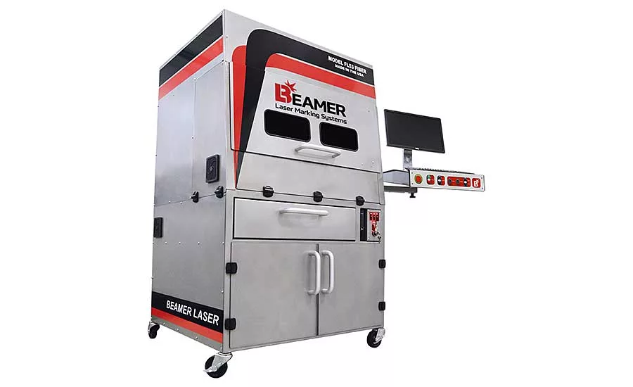

GMI chose the Model FL53 machine because it produces a higher quality mark with a better visual appearance than dot peening and engraving. Photo courtesy Beamer Laser Systems

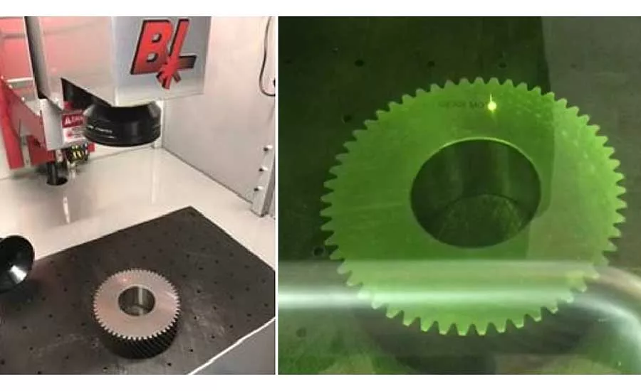

Prior to 2019, however, GMI had to send all the gears it made to a third party for laser marking. This is because the company only used dot peening and engraving to mark parts. To better serve its customers, company management purchased a Model FL53 fiber-laser marking machine from Beamer Laser Systems and installed it at the company’s Nixon Gear Division in Syracuse.
The FL53 produces a higher quality mark with a better visual appearance than dot peening and engraving. This benefit is particularly desirable for customers that resell their gears at retail. The laser machine also enables GMI to provide data-dense marking—as is found in 2D bar codes and QR codes—for customers that require it.
Another benefit is the machine streamlines the gear manufacturing process by making it quicker and more efficient. In addition, GMI is now able to offer laser marking of gears as a separate service, to further expand its business.
The FL53 uses a 50-watt, high-powered LED laser to quickly and safely mark products in a wide range of intensities. It offers a 12.5-inch-by-26-inch marking area, and can accommodate parts up to 3.5 feet long with side panels attached. Larger parts can be marked when the panels are removed. GMI uses an optional 5C collet indexer for radial marking of cylindrical parts.
