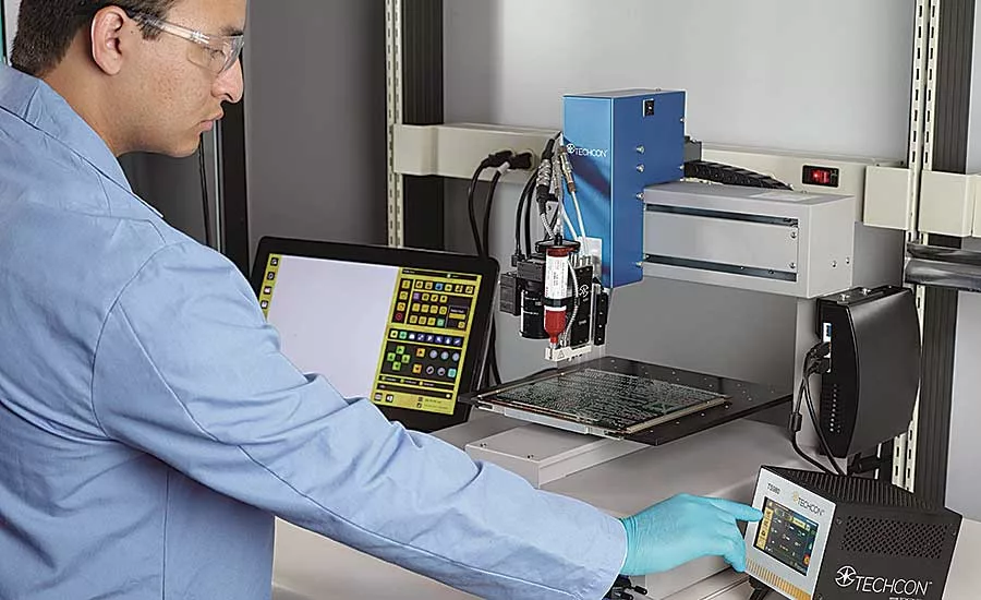

Techcon Systems launched its TS9800 Series jet valve dispensing system last fall. The system includes the TS9800 piezo-actuated jet valve and TS980 smart controller. PHOTO COURTESY TECHCON SYSTEMS

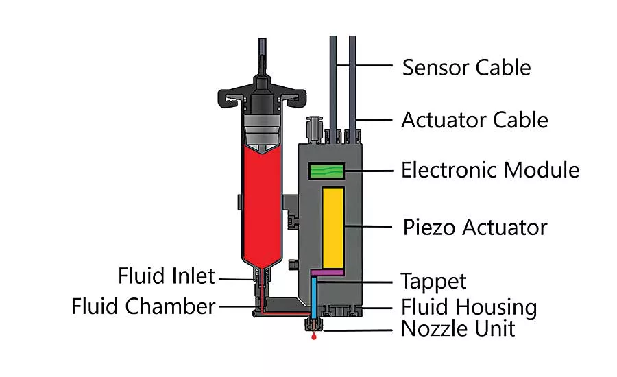

In a piezo-actuated jet dispensing valve, kinetic energy is supplied by a piezoelectric actuator, which dispenses the fluid under carefully controlled pressure to form a dot or bead of material at the target location. PHOTO COURTESY TECHCON SYSTEMS

In a PAJDV, the fluid is held between the tappet (piston) and the nozzle. The piston is connected to a piezoelectric actuator. When an electric charge is applied to the actuator, it oscillates up and down at a high rate of speed to generate kinetic energy. The actuator precisely and repeatedly dispenses the fluid under carefully controlled pressure to form a dot or bead of material at the target location.
The dispensing cycle only lasts milliseconds and involves five steps:
  • Rising time. This is the total time for the tappet to move to the open position.
  • Open time. This is the total time that the valve stays open.
  • Falling time: This is the total time for the tappet to move to the closed position.
  • Needle lift: This is the stroke length, which is based on the material’s viscosity.
  • Delay time: This is the time that the valve stays closed, waiting for the next cycle.
All of these steps occur sequentially and repeatedly up to 1,500 times per second. In the real world, the exact number of drops dispensed per second is determined by factors such as desired shot size, material viscosity and horizontal movement speed of the substrates being assembled.
