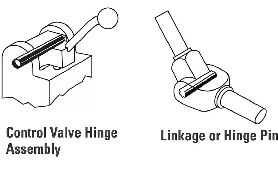

“Dowel pins are widely used for alignment, but can also work great as a bearing surface for rotation,” explains Mike Apsey, director of product engineering and development at Driv-Lok Inc. “Another benefit is they can be removed and replaced by the end-user without distortion.”

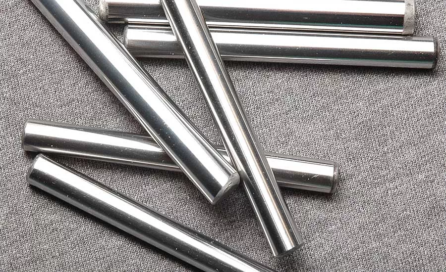

The dowel pin is a smooth cylinder of metal, although it may be chamfered at each end to aid insertion. This pin is typically hardened and manufactured to precise fractional diameters and lengths, and used as a hinge, shaft or pivot to locate or hold parts together.
The dowel pin withstands the most shear force of any fastening pin. It is preferred for high-production assembly because it requires no extra fastening hardware for insertion or secondary operations.
The grooves of a grooved pin are formed by a swaging operation in which three tools penetrate the nominal diameter of the pin metal at 120-degree intervals, according to Apsey. This penetration displaces a controlled amount of metal to each side of the grooving tool, forming a raised portion along the side of each groove.
“This type of pin is great for permanent joints or those that require pivoting or rotation, as well as for part location,” says Apsey. “Many manufacturers prefer using groove pins to screws in assemblies that are regularly exposed to high vibration.”

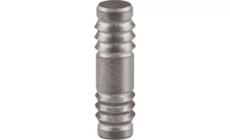

Designed for use in plastic and soft metal, depending on the pin for the latter material, barbed pins have external raised barbs that are angled backwards or opposite the direction of insertion. As the pin is being inserted, the host material backfills into the area around the barbs, resulting in maximum resistance to axial force and a secure, tamper-resistant assembly.
SPIROL introduced its Press-N-Lok barbed pin last fall. According to Jones, the pin has opposing barbs on each end that permanently retain two plastic components to each other. The key limitation of the pin is it is not appropriate for brittle plastics or those containing a high percentage of glass fillers.

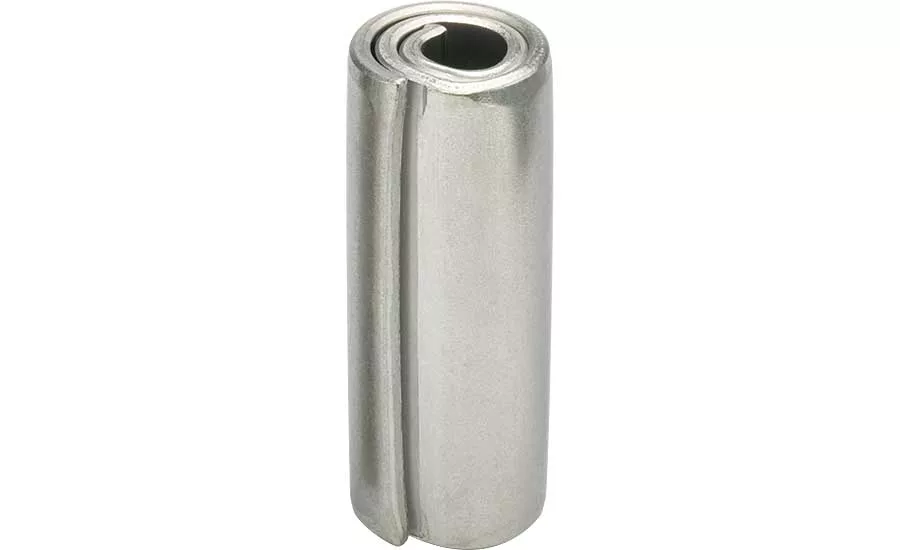

The coiled spring pin consists of a 2-1/4 helical wrap of carbon, stainless or alloy steel. Its outer diameter ranges from 0.03125 to 0.75 inch, and its standard length is usually no more than 6 inches. The pin’s outer diameter is slightly larger than the hole diameter to ensure retention, notes Mike Pasko, an application engineer at SPIROL.
When correctly sized and installed, the pin offers a minimum of 270 degrees of radial contact in the hole. Another benefit is the ability to resist shock and vibration. This isolates the hole material from the forces, and contributes to the prolonged useful life of the assembly.

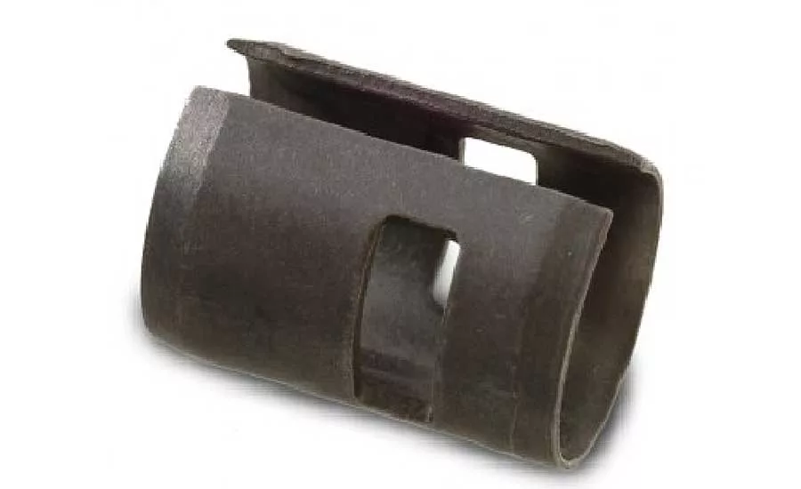

Slotted spring pins are economical, shear-type fasteners that are self locking. Apsey says their oversize dimension exerts radial forces upon insertion to firmly hold the pins in place. Common uses include being spacers, stop points and hinges in thousands of demanding, but nonprecision, industrial applications.

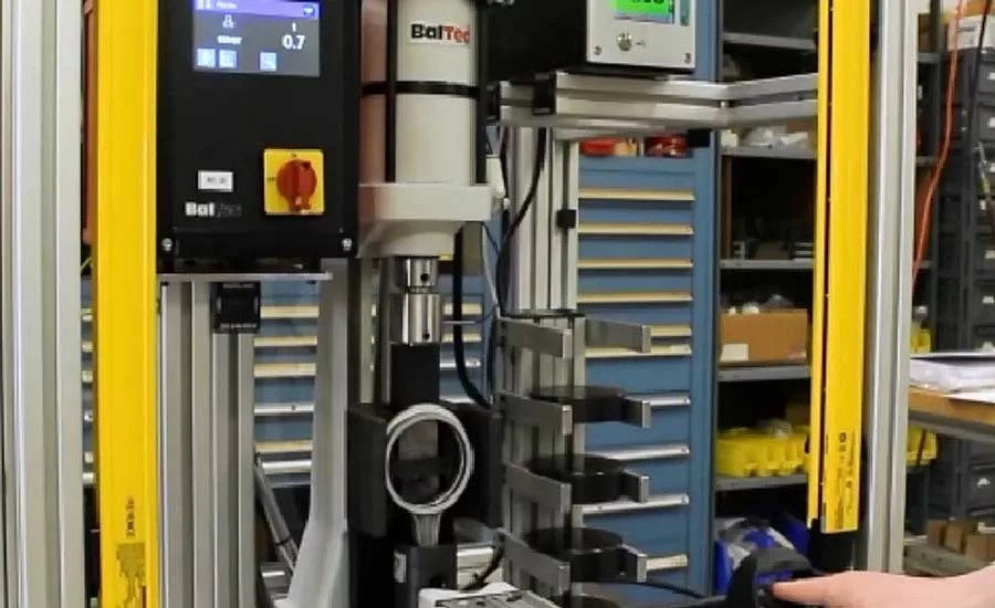

“For pins and dowels, press-fit is the standard installation method,” says Chuck Rupprecht, general manager at BalTec Corp. “Installation may be permanent or temporary, and is a simple process that is typically done with a benchtop manual, pneumatic or hydraulic press. Automated pressing is done as well, although in that situation you need to have an extremely high volume for a reasonable ROI.”
Straight-acting presses are preferred over toggle presses. The amount of force required to press parts together depends on the hardness, slipperiness and surface finish of the materials; the size, thickness and geometry of the parts; and the amount of interference between them, that is, the difference in size between the inserted part and the hole.

According to Rupprecht, pins that require less than 4 kilonewtons of force can be installed with a manual press. This type of press usually has an anti-lock mechanism to ensure proper pin insertion. The mechanism requires the operator to fully complete pin insertion before the press ram comes to a hard stop.
Pins that require 4 or more kilonewtons of force for insertion should be installed with a pneumatic or hydraulic press. Rupprecht points out that, although more expensive upfront, these presses allow for press monitoring of the force-distance curve.
The DA series of direct-acting pneumatic presses from BalTec are modular and can be exactly sized for any pin- or dowel-insertion application. Standard stroke lengths range from 40 to 120 millimeters in 20-millimeter increments, although special lengths may be requested. The presses utilize two-handed control, produce a constant force over the whole stroke length and can be integrated with the company’s IPC controllers for individual workstations. A right-angled gearbox allows for simple height adjustment of the press head. The presses are quiet (less than 75 decibels) and practically maintenance-free, as all moving parts are mounted in bearings.
