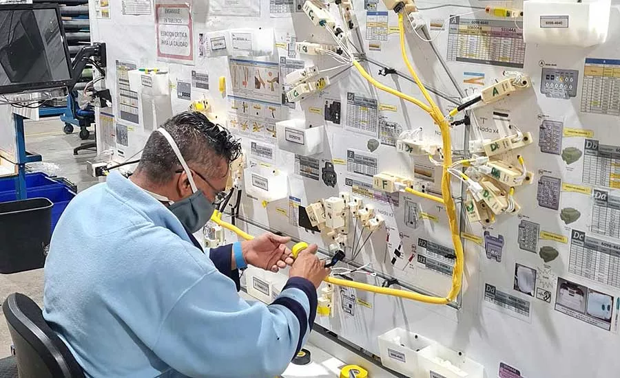

Assembly/test boards are part of the process controls at ALTEX that lead to zero defects and reduce cost through high efficiencies. Photo courtesy ALTEX Inc.

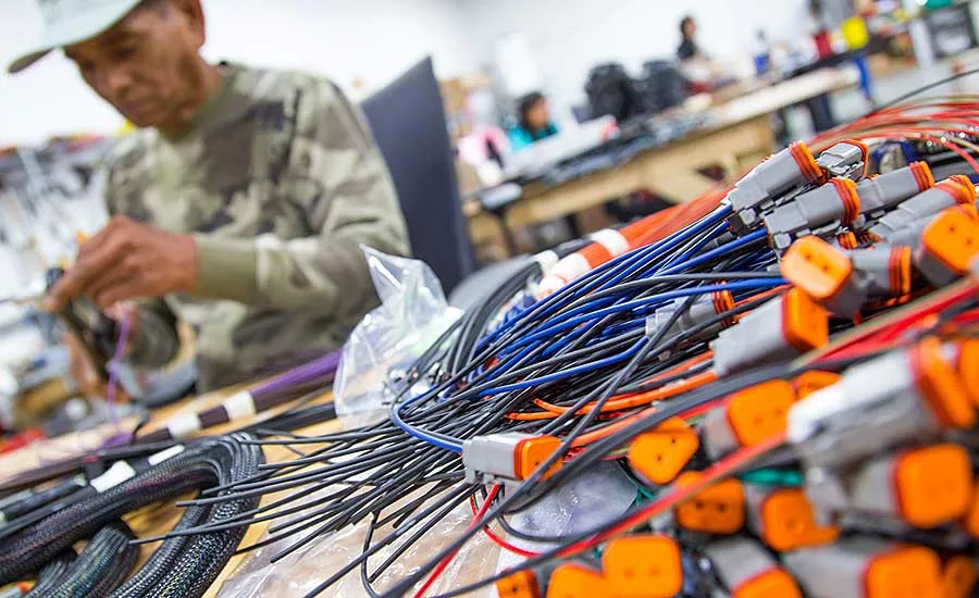

A harness builder at EMSCO completes subassemblies prior to placing the harness onto a form board. Photo courtesy EMSCO

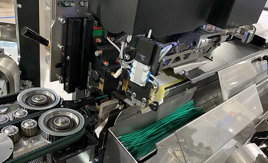

Crimp centers are designed to cut, strip and terminate wire at a high rate without quality risks. Photo courtesy ALTEX Inc.

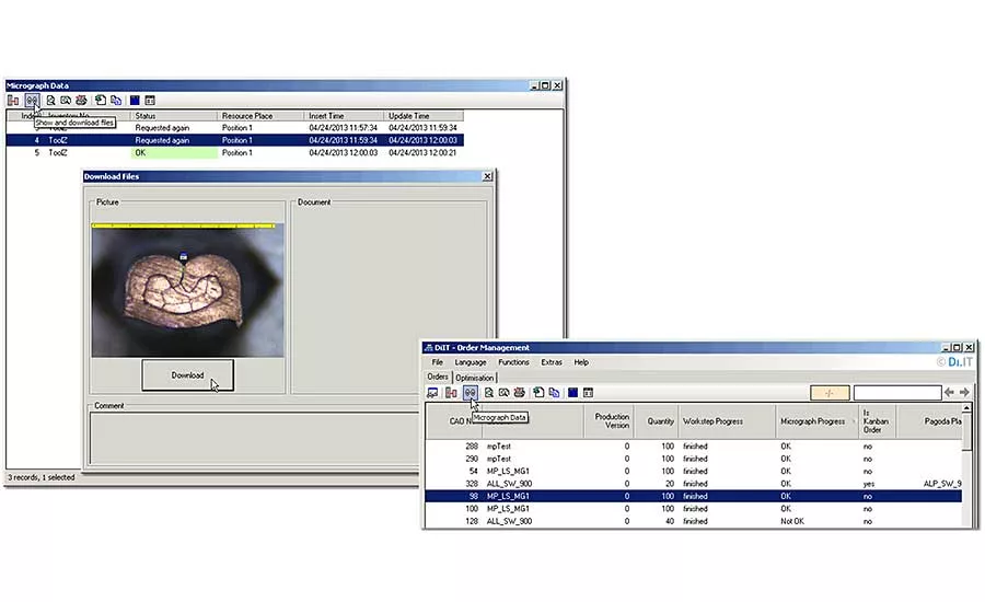

The 4Wire Cutting and Assembly Optimization manufacturing execution system gives an accurate picture of what’s really going on in each wire processing machine within a plant. Photo courtesy Schleuniger Inc.

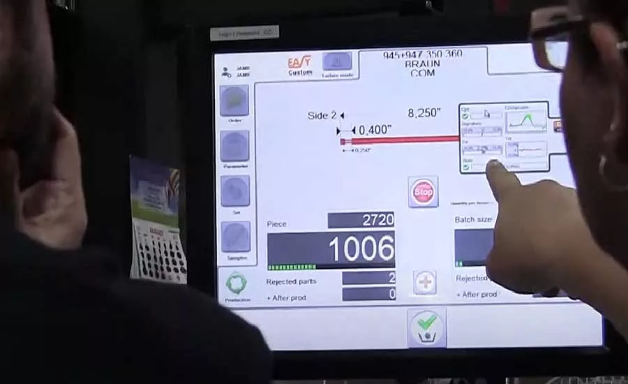

Machine operators at ALTEX carefully review wire processing data that is displayed on a crimp center monitor. Photo courtesy ALTEX Inc.

EMSCO has about 30 employees, all of whom are cross-trained on multiple aspects of harness assembly, testing and shipping. Most workers can build a harness from start to finish. This includes operating the automation equipment, to completing all wire processing--from the beginning, through to testing/quality assurance and packing, and then labeling the final box for shipment.
“The more complex harnesses are usually done by the most experienced workers to optimize efficiency,” says Garret. “They know best how to have all the needed parts available and then quickly build the harnesses.”
At the EMSCO facility in Ashland, VA, all wire and cable is processed on fully automated cut-strip-and-terminate machines made by Komax Corp. and Schleuniger. The machines, which were purchased a few years ago, handle wire and cable from 30 AWG to 750 MCM.
“The real cost challenge of equipment isn’t buying it when it’s practical, based on current workload, but when it’s aspirational, based on a hoped-for future workload,” explains Garrett. “When we began as a company [in 2001], we used semiautomated cut-strip machines and crimping presses. The problem was, this setup involved long changeover times, which is costly. With the fully automated machines, our changeover time to switch from 14 AWG to 12 AWG, for example, went from 20 minutes down to just over 7 minutes. That’s a big increase in efficiency.”
ALTEX also operates a wide range of automated and semiautomated wire processing equipment, including benchtop models and several CrimpCenter machines from Schleuniger. Hand tools are not used for wire processing, although workers do occasionally solder wire to connectors.
“Equipment ROI is pretty straightforward for us,” notes Bromm. “We aim for a multiyear payback because of our large number of long-term clients.”
Schleuniger regularly improves its equipment to increase wire and cable processing productivity. Boyd points to internal operating software that lets operators easily network to other equipment; quickly sort, set up and complete high-quality processing of wire and cable; and obtain key data related to cutting, stripping and crimping.
“Our Di.IT division makes a manufacturing execution system, called 4Wire Cutting and Assembly Optimization (CAO),” explains Boyd. “By digitalizing the value chains, the CAO’s innovative software optimizes and controls complex manufacturing and logistics processes and supports quality assurance and traceability. The system gives an accurate picture of what’s really going on in each machine to maximize its overall equipment effectiveness (OEE).”
Despite being a Schleuniger product, CAO’s interface allows it to be used with all wire processing equipment made by Komax Corp., Schaefer Megomat and Artos Engineering. Several manufacturers of automotive harnesses have greatly reduced costs by using CAO, according to Boyd.
One such company is now able to assign projects to wire processing machines using an electronic kanban system instead of a physical one. The earlier method required the operator to decide on the production orders for a full shift using his own criteria, which was often inconsistent and inefficient across workstations. Now, the number of transmitted orders are automatically sequenced based on an optimization algorithm, and limited to the next 2 hours of production. The benefits include reduced changeover time and increased OEE.

Harness manufacturers concur that assembly and testing accounts for the largest percentage of overall costs. Bromm says assembly and testing at ALTEX can be quite costly because the company custom-builds its unique fixtures for complex assemblies on which both processes are completed.
“The fixtures are expensive, but they enable us to train workers faster, and they make our operators more efficient,” says Bromm. “High-quality assembly of the harnesses is assured as well, thanks to a lockdown feature that activates once the harness is electrically connected. The harness must receive a green light during testing, or it can’t be removed from the fixture.”
ALTEX has used these custom fixtures for more than five years, and the company operates about 20 of them throughout their facility. Each takes two to three weeks to build, but it lasts for years and can be modified for similar types of harnesses that may be of a different length or require an additional one or two terminals or connectors.
EMSCO relies on untraditional build tables to optimize its harness assembly process. The company currently uses more than 50 such tables, which encompass nearly 600 linear feet of space.
“We use an internally designed system to optimize the cost-effectiveness of building and testing our harnesses,” explains Garrett. “A detailed drawing is generated from CAD, then printed and placed on a build table. Magnets are then positioned on the drawing where traditional posts would be. Setup is completed in minutes, and the magnets can be easily moved as necessary. One or more mobile carts loaded with processed wires and other harness components are then brought to the table so the assembler has everything he or she needs to build the harness or harnesses.”
EMSCO tests harnesses throughout the build process to find and fix problems as early as possible, and limit later rework. Garrett says that a big cost factor related to testing is initial setup time (i.e., programming the computerized tester and building a test fixture) for a specific type of harness. There is no setup time to test additional harnesses of the exact same type.
“Testing is inspection, so it is by nature extra work beyond harness building,” acknowledges Garrett. “But, it can be done more efficiently and cost-effectively.”
