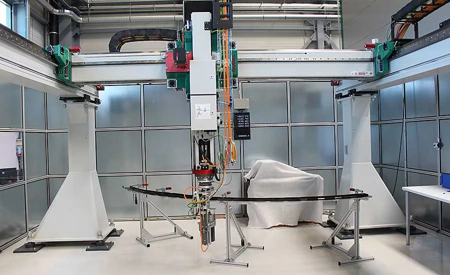

“The cleats must be picked up automatically and fed to the frame,” Brieskorn points out. “To rivet the frame and cleat together, it is then necessary to drill through both components. We achieved this by equipping the frame with the cleats using our newly developed high-precision end effector. In addition, the frame was fitted to the fuselage shell without any gap.”
Flexible System

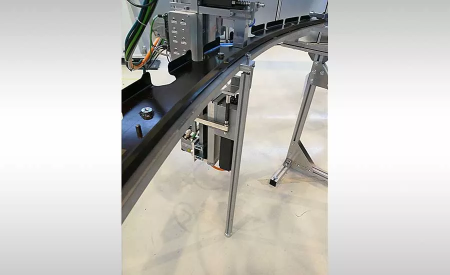

The Fraunhofer IFAM engineers developed a positioning and drilling end effector that receives different cleats, positions them on different integral frames and simultaneously double drills both components. A compact end effector can be picked up by the gantry system used in the Tempo project, as well as by standard industrial robots.
“The integral frame is stretched on stilts under the portal and can be oriented in space using several mechanical adjustment options,” says Brieskorn. “The end effector has a symmetrical holder that enables it to pick up cleats of different orientations and clamp them to the holder. Using spring-damped mechanical stops, it approaches the respective joining positions with local precision.”
While the cleat stiffening element is placed on the integral frame surface from above and both components are clamped using a built-in mechanism, the drilling process is carried out from the back of the frame to prevent CFRP parts from fraying.
An extraction system picks up the resulting drilling dust. Once the components have been drilled, the positions of the cleats on the frame are defined. The cleats can then be riveted to the frame.
“The end effector, which can be controlled via a PLC, receives its global position data from imported CAD data of the components,” explains Brieskorn. “The new assembly [is tested] via a quick upstream measurement using a laser tracker. The innovative technology enables reliability and high positioning accuracy.
“Except pressing the start button on a control panel, everything is running automatically,” claims Brieskorn. “A user-friendly operator interface with self-explanatory images to facilitate input allows even inexperienced employees to quickly familiarize themselves with the control of the system.”
By making appropriate modifications to the cleat pick-up, the end effector can also mount slightly different cleats and position them precisely on different types of integral frames. The accuracy of the automated filling is ±0.1 millimeter.
“The measuring technology integrated in the positioning and drilling end effector [provides] the required contact pressure of 200 newtons, as well as many other parameters for monitoring optimal conditions for the pre-assembly of the cleats” says Brieskorn. “This ensures quality. The measurement of the joint gaps between the integral frame and the fuselage skin showed that they were all smaller than 0.3 millimeter, making additional gap filling unnecessary.”
