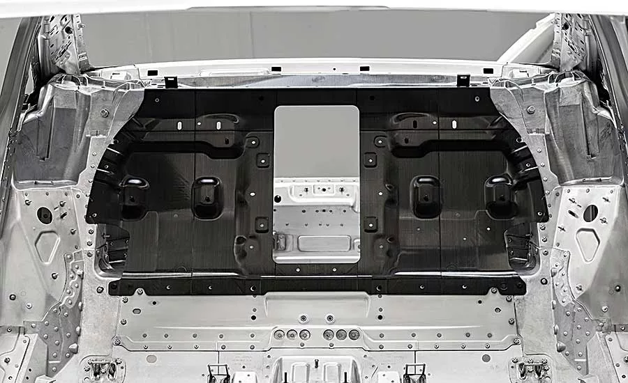

This carbon-fiber composite rear wall structure is bonded to an aluminum body structure. Photo courtesy Audi AG

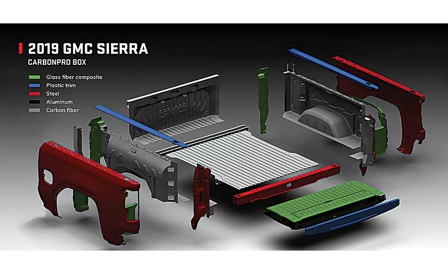

Carbon-fiber composites are an increasingly popular lightweighting option in the auto industry. Illustration courtesy General Motors

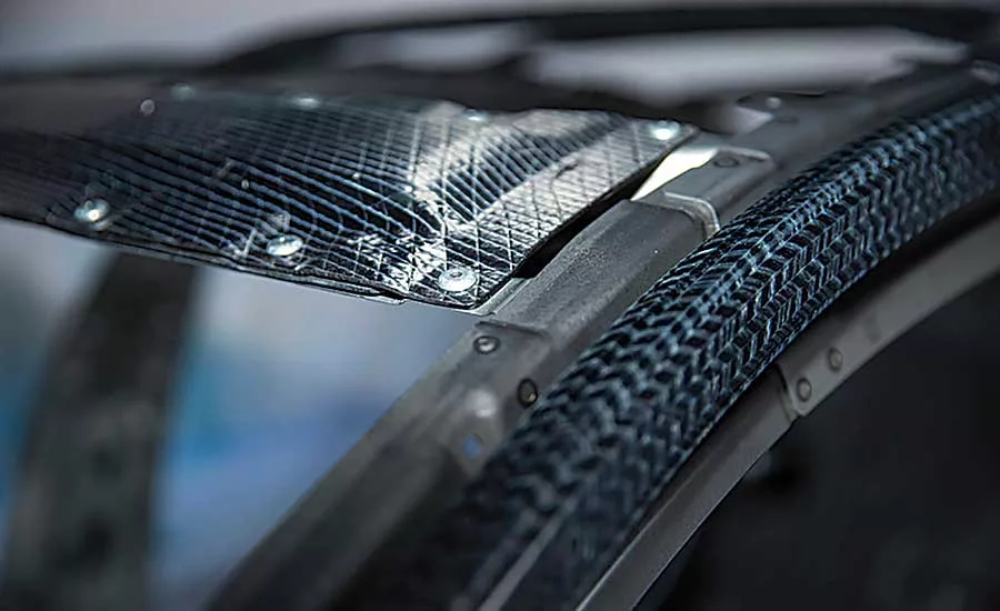

Fasteners are used to attach some carbon-fiber composite parts to dissimilar materials. Photo courtesy BMW AG

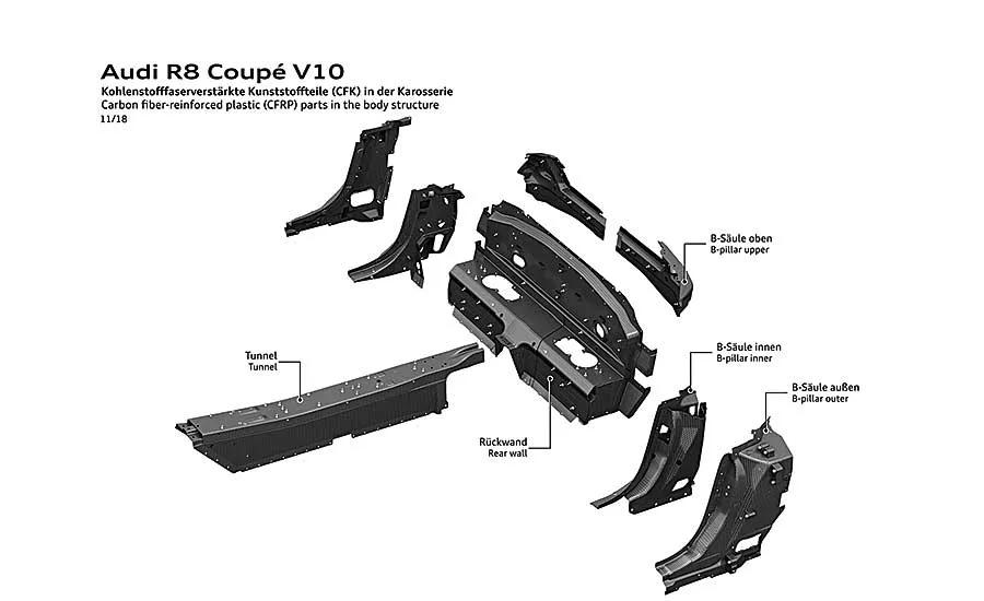

Structural auto parts made from carbon-fiber composites include B and C pillars, rear walls, roof arches and tunnels. Illustration courtesy Audi AG

Mechanical Fastening
When applications require disassembly and repair, fasteners are typically the best assembly alternative. But, spreading loads over a large surface is a key concern of carbon-fiber composites.
Delamination and fracturing can be detrimental to the structural integrity of the material. That’s why some applications combine bonding and fastening to address the issue.
“The biggest mistake that engineers make is not spreading the load through the structure sufficiently,” says Mowins. “They tend to go back to what they know from traditional mechanical joining in metallic structures where you don’t have the cracking and delamination that you see in composites.
“It’s important to understand how composites work,” warns Mowins. “Engineers should always avoid creating undo stress in the joint area. Traditional plastics tend to be able to deform and don’t crack or be as brittle as carbon-fiber reinforced materials.
“Our new point drive thread end recess product and our designs with large underhead bearing surfaces are typically used to join carbon-fiber composite parts to metallic structures,” explains Mowins.
“A fastener solution that is well aligned with composite joint requirements can significantly reduce complexity and related assembly costs, while providing serviceability,” adds Brandt Ruszkiewicz, Ph.D., lead development engineer at Semblex Corp. “In critical applications where adhesives may be considered or required, the use of mechanical fastening provide additional peel strength that adhesives may not provide on their own. This is especially critical for high-impact or ‘crash’ scenarios.”
One challenge to joining composites is the risk of galvanic corrosion. Since carbon is a strong cathodic material, it corrodes when coupled with anodic materials such as low-carbon steel. To address that issue, engineers should consider using alternative materials for fasteners and coatings.
Another challenge that engineers may encounter, especially with thread-forming or self-drilling fasteners, is material flaking or dusting during assembly. That can create potential contamination in the joint.
Semblex offers several products that address these issues. For instance, the FlowPoint DELTA PT fastener (designed and licensed by EJOT GmbH & Co.) is ideal for joining CFRP to thin metals such as aluminum.
“This product creates its own hole and forms threads during installation with minimal material flaking,” explains Ruszkiewicz. “In addition, we have expanded our technical and product development teams to focus on new solutions and technologies for next-generation lightweight materials, such as thermoset CFRP.”

Another product designed for bonding composite parts is DuPont’s Betaforce 9050M. The two-component polyurethane is used for joining multimaterial structural parts in heat-accelerated and ambient temperature cure processes and gap filling applications.
“Betaforce 9050M provides increased load bearing capability and increased static and dynamic stiffness,” claims Andreas Lutz, R&D director at DuPont. “It offers particularly stable physical properties over a large temperature and ambient moisture content range, which helps ensure performance in all climate conditions.”
The adhesive is used by Audi to attach lightweight parts, such as the carbon-fiber composite rear wall structure in the A8 sedan.
“The ultra-high strength, torsional ridged rear panel contributes significantly to the lightweight design of the vehicle,” says Lutz. “It [provides] an additional 33 percent of the overall torsional stiffness of the vehicle and a 24 percent improvement compared to its predecessor.
“The adhesive can undergo heat-accelerated cure without compromising adhesion properties and performance,” explains Lutz. “This enables cycle times of around 1 minute, while providing a significant reduction of takt times as currently applied in the manufacturing of the rear panel parts.”
