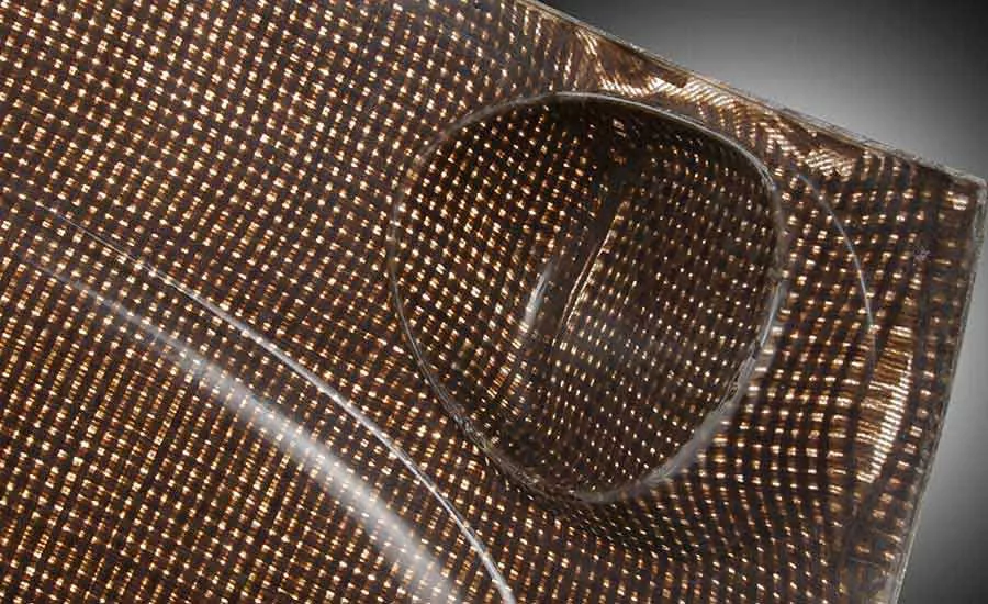

Elium is a liquid thermoplastic resin for manufacturing composite parts. It has mechanical properties similar to thermoset resins, but it acts like a thermoplastic, which means it can be thermoformed, recycled and joined with ultrasonic welding. Photo courtesy Arkema

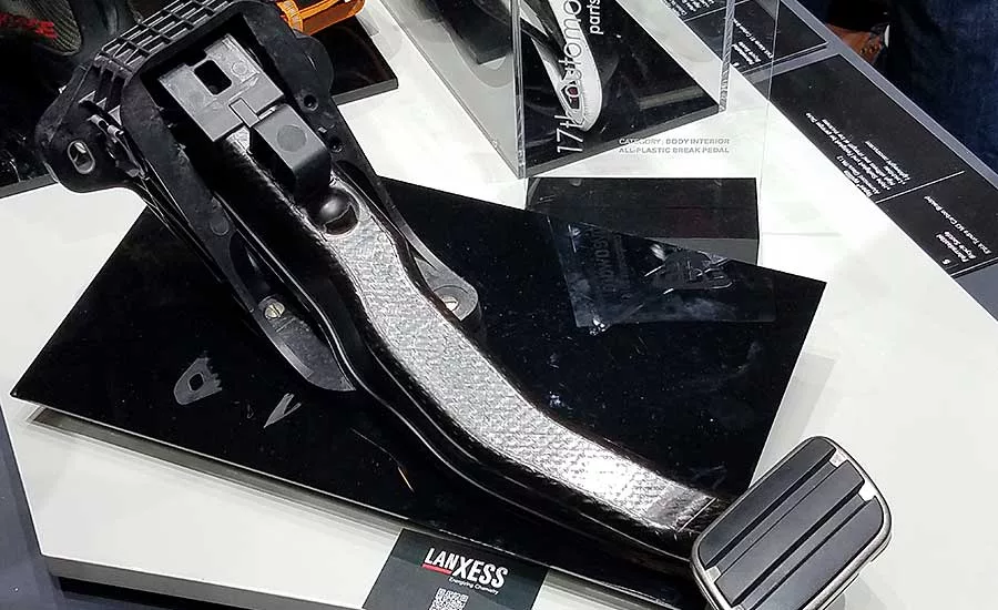

This brake pedal is made from fiber-reinforced polyamide 6. Photo courtesy LANXESS

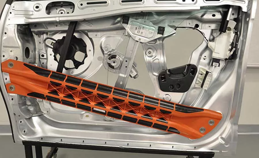

This side-impact door beam is made from polyamide 6.6 thermoplastic reinforced with continuous fiberglass strands. It is 60 percent lighter than a comparable part made from ultra-high-strength steel. Photo courtesy DuPont

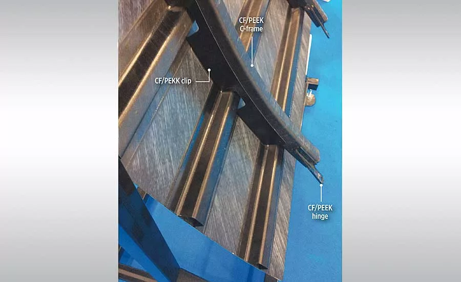

Ultrasonic spot welding was used to attach hinges and clips to C-frames in this aerospace assembly demonstration project. All the parts are made from carbon fiber-reinforced PEEK. Photo courtesy Clean Sky

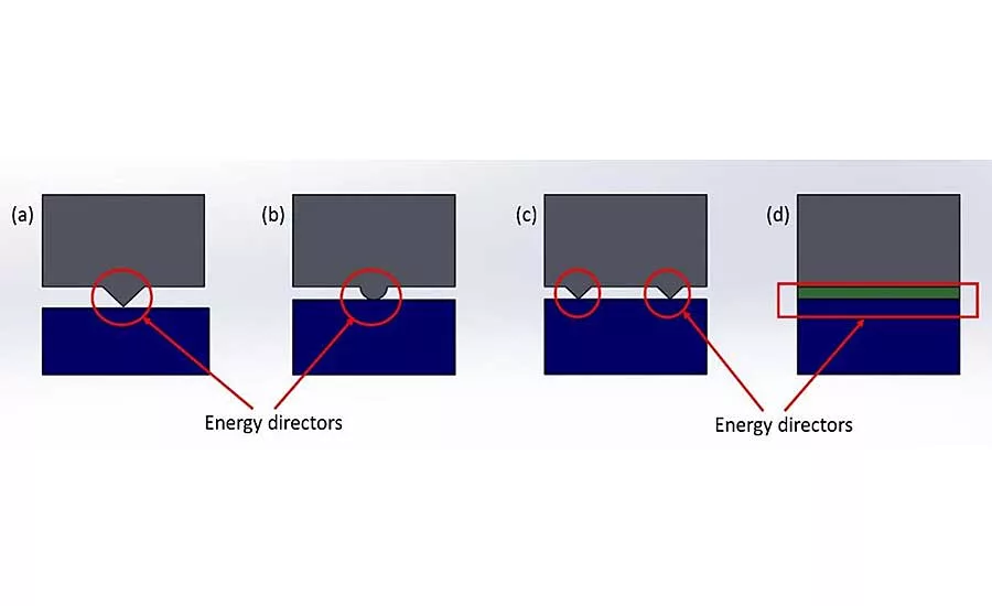

The size and shape of an energy director (ED) can influence weld quality. EDs can be semicircular, triangular or flat. Due to the differences in stiffness between a “neat” polymer and a fiber-reinforced composite, a flat ED is usually sufficient for welding composites. Illustration courtesy Nanyang Technological University

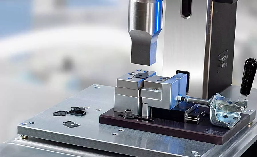

A third option is ultrasonic welding. This process offers myriad benefits:
  • Ultrasonic welding is the fastest joining method and is ideal for automation.
  • Filler materials are not required. Spot and seam welds are possible.
  • Surface damage is minimal, since the heat is generated at the joint interface rather than the top of the surface.
  • It is a clean process. It does not generate fumes or sparks.
Ultrasonic welding has limitations, too:
  • The process is limited to overlap and shear joints, and maximum part thickness is limited to around 3 millimeters. It can be difficult for ultrasonic vibrations to penetrate thicker parts.
  • Materials with high stiffness, hardness and damping ability can impede the ability to convert vibration into thermal energy.
  • Ultrasonic welding works on the principle of transmitting mechanical vibrations to the joint interface, so the process may produce high-pitched audible noise. In addition, due to vibrational cyclic loading, there is an increased risk of the part failing in fatigue.

There are two types of joints for ultrasonic welding: energy director joints and shear joints. An energy director (ED) is a protrusion molded into one of the parts. Butt joints and lap joints commonly use energy directors. With shear joints, the direction of vibration transmission is parallel to the welded interface, and heat generation occurs due to the frictional shear force at the interface. Shear joints are used when a strong structural or hermetic seal is required. They are also useful for welding semicrystalline resins.
The ED is an important physical parameter in ultrasonic welding. It helps to increase viscoelastic heating by concentrating energy at the joint interface. The size and shape of the ED can influence weld quality. EDs can be semicircular, triangular or flat. They can also be oriented parallel or perpendicular to the joint. Due to the differences in stiffness between a “neat” polymer and a fiber-reinforced composite, a flat ED is usually sufficient for welding composites.
With the right process parameters, thermoplastic composites can be welded without an ED. However, it’s better to have an ED than not. One study showed that an ED is more important to weld quality than force or vibration time when joining nylon 6 composites. Another study found that, when welding carbon fiber-reinforced PEEK, lap shear strength was 50 percent higher in joints with an ED than those without one.

Ultrasonic welding quality is governed by several parameters, including vibration amplitude; power; input energy; weld time; vertical displacement during welding; applied force before, during and after welding; and hold time.
Weld quality depends most on input energy. Input energy can be calculated by the equation: E = F x f x A x t, where E is input energy (in joules), F is welding force (in newtons), f is the frequency (in hertz), A is the amplitude (in microns), and t is time (in seconds).
Optimum joint strength is closely related to total energy input. For example, a study of fiber-reinforced nylon 6 found that a total energy input of 200 to 1,000 joules increased joint strength, but energy over 1,000 joules decreased strength due to the introduction of pores in the joint.
Welding time is another key parameter. One study involving carbon fiber-reinforced PEEK found that weld quality increased with an increase in weld time from 0.7 to 0.8 second. Longer weld times (1.1 second or more) created cracks and voids at the interface. Ultimately, 0.9 second was found to be the optimum time for good weld quality.
Frequency also plays an important role. For example, one study found that amplitude and time were more important that force when welding glass fiber-reinforced polypropylene.
