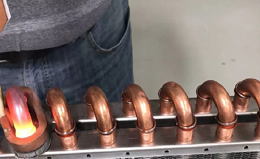

A worker at an automotive heat-exchanger-tube manufacturer uses the MiniMICO to induction braze a return bend onto each tube. It takes less than 30 seconds to complete the process. Photo courtesy eldec LLC

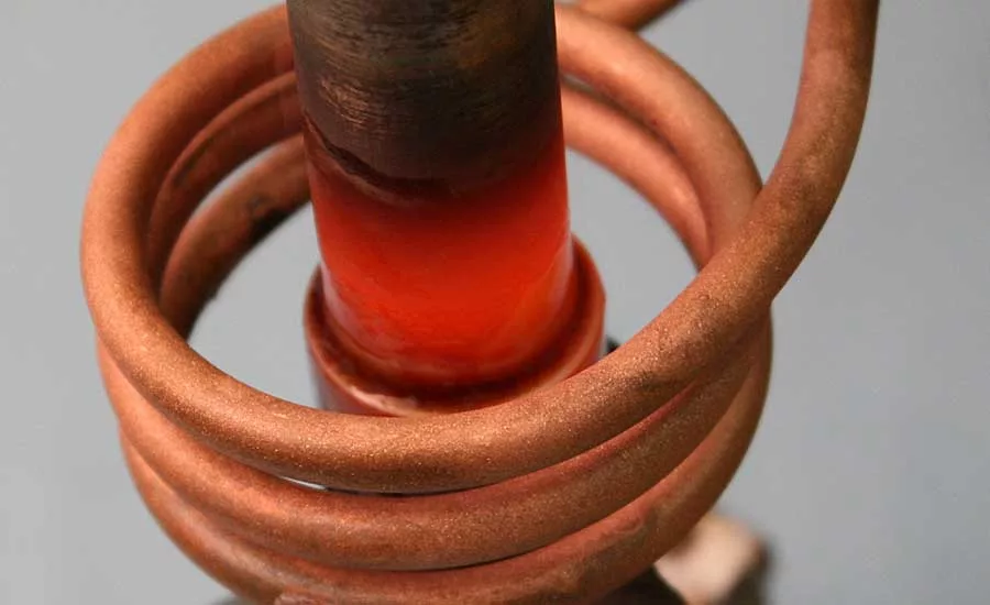

The heat for brazing can be supplied by a torch, a furnace or an induction coil. During induction brazing, an induction coil generates a magnetic field that heats the base materials to melt the filler metal. For a growing number of assembly applications, induction brazing is proving to be the best option.

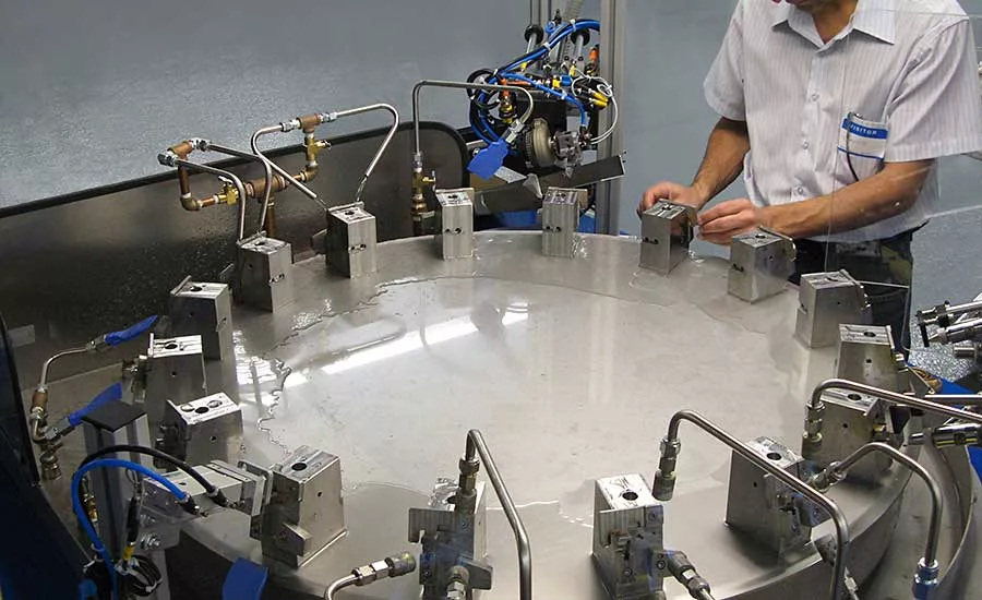

A few years ago, Fusion developed a fully automated six-station machine to assemble 10 types of carbide burrs used for metalworking and toolmaking. The burrs are made by joining tungsten carbide blanks that are cylindrical and conical in shape to steel shanks. Production rate is 250 parts per hour, and separate part trays hold 144 blanks and shanks.
“A four-axis SCARA robot takes a shank from the tray, presents it to the paste dispenser and then loads it into the fixture nest,” explains Anderson. “The robot then picks a blank from a tray and places it onto the pasted shank end. Induction brazing is performed with an electric coil that vertically surrounds the two parts and brings the silver filler metal to a liquidus temperature of 1,305 F. After the burr assembly is aligned and cooled, it is ejected via a discharge chute and collected for further processing.”

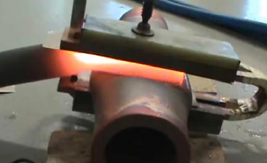

The operator then positions the induction coil, which comes in many designs. A helical coil is round or elliptical and fully surrounds the part, whereas a fork (or tong) coil is positioned down each side of the joint, and a channel coil hooks over the part. Other coils include internal diameter (ID), ID/outer diameter (OD), pancake, open-ended and multi-position.
Uniform heat is essential for a high-quality braze joint. To achieve this, the operator needs to make sure the vertical distance between each induction coil loop is small, and the coupling distance—the gap width from the coil OD to ID—is kept even.
Next, the operator turns on the power to begin the process of heating the joint. This involves the rapid transfer of a medium- or high-frequency alternating current from the power supply to the inductor to create an alternating magnetic field around it.
The magnetic field generates an induced current in the surface of the joint, which generates heat to melt the filler metal so it flows and wets the metal parts’ surfaces, resulting in a strong bond. With a multi-position coil, this process can be simultaneously performed on multiple parts at the same time.

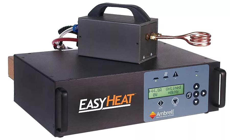

All six EasyHeat systems from Ambrell have a frequency range of 150 to 400 kilohertz, making them ideal for induction brazing of small parts with various geometries. The compact models (0112 and 0224) offer power control within a 25-watt resolution; models in the LI series (3542, 5060, 7590, 8310) provide control within a 50-watt resolution.
Both series have a movable workhead that can be located up to 10 feet from the power supply. The systems’ front-panel controller is programmable, allowing end-users to define up to four different heating profiles, each with up to five time and power steps. Remote power control is available for contact or analog inputs, or an optional serial data port.

Fusion sells custom rotary systems that can induction braze 100 to 1,000 parts per hour. The higher volume is possible for a single type of part or a specific family of parts, according to Cukelj. These parts can range in size from 2 to 14 square inches.
“Each system incorporates an indexer from Stelron Components Inc. with eight, 10 or 12 stations,” explains Cukelj. “Some stations are for brazing, while others are either for inspection, using a vision camera or laser measurement device, or pull testing to ensure a high-quality brazed joint.”

Eldec also makes the portable MiniMICO power supply, which is easily moved around a plant and has a 10 to 25 kilohertz frequency range. Two years ago, an automotive heat-exchanger-tube manufacturer used the MiniMICO to induction braze a return bend onto each tube. One person did all the brazing, with each tube requiring less than 30 seconds to be assembled.
