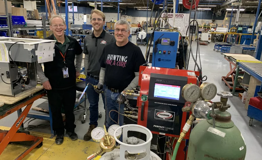

Standardizing the brazing process across three Delfield facilities has been an important outcome from the DCR that has allowed the company to achieve repeatable brazing results. This is possible due to the Harris Perfect Flame, a gas delivery system designed for high-production brazing operations. Built-in software analyzes the flame, measuring chemistry, flow rates, temperature, BTU and flame types to achieve the ideal flame for the particular brazing project being performed.
These settings, which are defined by Delfield’s production management, are stored and can be reproduced anywhere throughout Delfield’s operations where a Perfect Flame has been installed. Brazing staff simply select the project setting, light the torch, and then proceed to braze without the need to make any adjustments to their torch settings.

The quality of a brazed joint can vary widely depending on the experience and skills of the technician, but with the new system in place, Delfield has been able to drastically reduce braze inconsistencies seen with newer trainees while also saving time on the production floor.
With guidance from a technical team at Harris, Delfield initially implemented the Perfect Flame system at one location, and then at two additional sites. Harris sent staff to each facility and conducted training sessions to make sure the process went smoothly.
Waldorf is keenly aware that introducing new technology can backfire if employees are opposed to it, and he did have concerns that this could happen with the new brazing process and equipment being introduced.
“Many of our operators have been here a long time and are proud of the work they do. As it turned out, they were very receptive, especially when they saw how it saves setup time and reduces training time for new brazers,” he says. “There’s not a lot they have to do to prepare the torch.”
Besides not having to adjust the flame every time they lit the torch, production staff also saw the benefits of improved workflow and a new tool to help them succeed in their brazing work.
Delfield has a dozen or more workstations at each of their locations, with at least six different flame settings required.
“We tailored the Perfect Flame settings around the more seasoned operators’ preferences, as well as the applications and the temperatures required. We were able to determine the best flame for each project,” Waldorf says.
