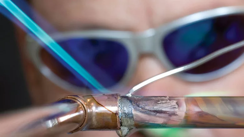

Delfield switched from a 5 percent silver alloy to Harris’ Safety-Silv 50N flux-cored rod, which reduces the potential for failures on thermal expansion valves. Photo courtesy Harris Products Group

Prior to making a recommendation on the type of alloy Delfield should use, Harris brought multiple valve samples to its in-house metallurgical lab to evaluate brazed joints.
In the braze lab, Harris staff replicated the flame used in the Delfield plant. Following this testing, Harris evaluated cutaways of the brazed joints. This led to the recommendation to use a flux-cored silver alloy to ensure the highest quality brazed joint.
Delfield made the recommended switch from a 5 percent silver alloy to Harris’ Safety-Silv 50N flux-cored rod, which reduces the potential for failures on thermal expansion valves.
