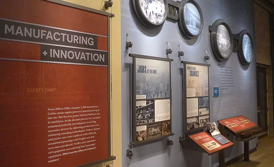

Displays at the Pullman National Monument visitor’s center educate the public on manufacturing processes that were once used to assemble rail cars. Photo by Austin Weber

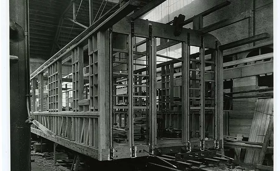

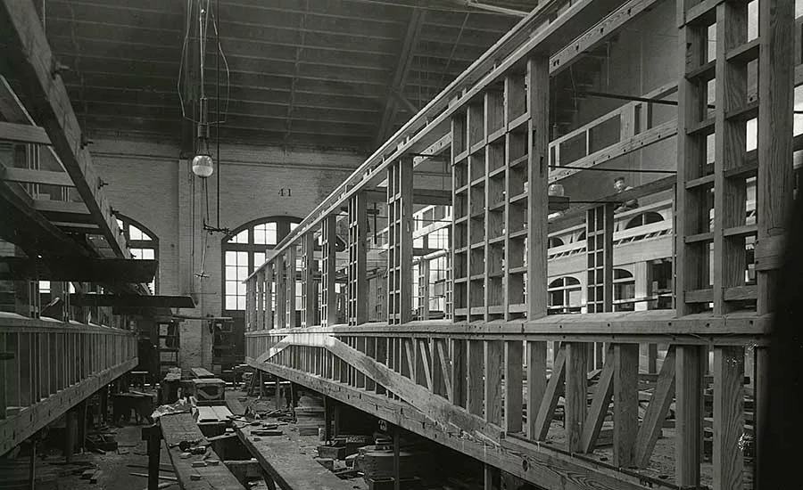

Up until the early 1900s, Pullman passenger cars were made out of large quantities of wood. Photo courtesy Pullman Palace Car Co. Photographs, Archives Center, National Museum of American History, Smithsonian Institution
Manufacturing History Comes Alive in Pullman
The design and construction of wood railroad cars peaked in the mid-1890s, when skilled craftsmen perfected the art of building a system of spidery trussing. Photo courtesy Pullman Palace Car Co. Photographs, Archives Center, National Museum of American History, Smithsonian Institution

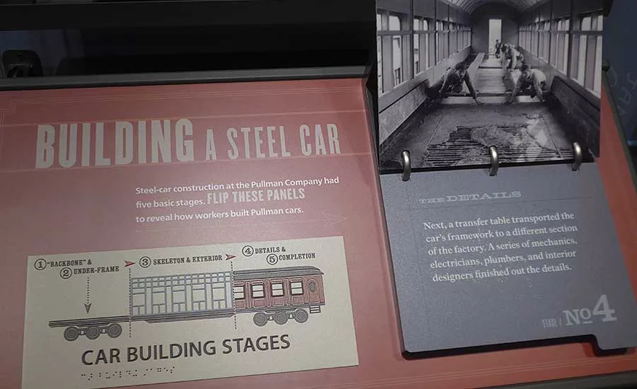

The shift from wood to steel radically changed the process of building passenger rail cars in the early 1900s. Photo by Austin Weber

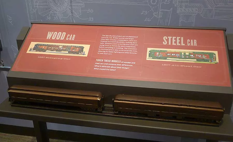

Displays at the Pullman National Monument visitor’s center explain how steel rail cars were assembled. Photo by Austin Weber

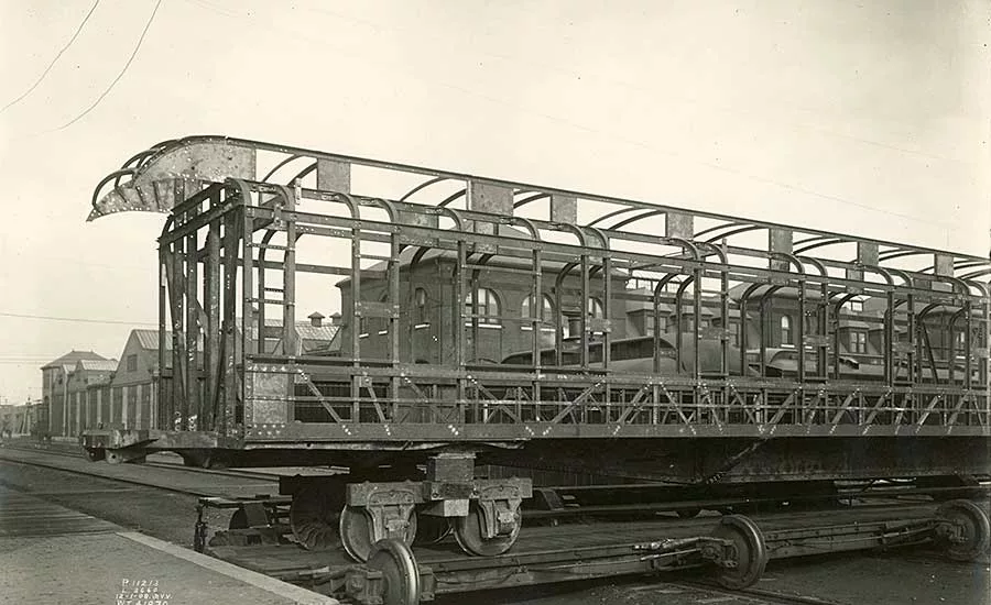

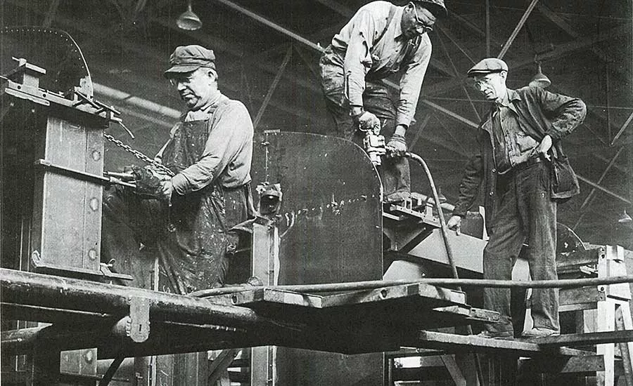

The switch to steel car construction in the early 1900s required Pullman workers to adopt new production tools and techniques This photo shows the steel frame of a passenger car sitting on one of the factory’s transfer tables. Photo courtesy of the Pullman State Historic Site
Pullman pioneered railroad car construction techniques, such as riveting. Photo courtesy of the Pullman State Historic Site

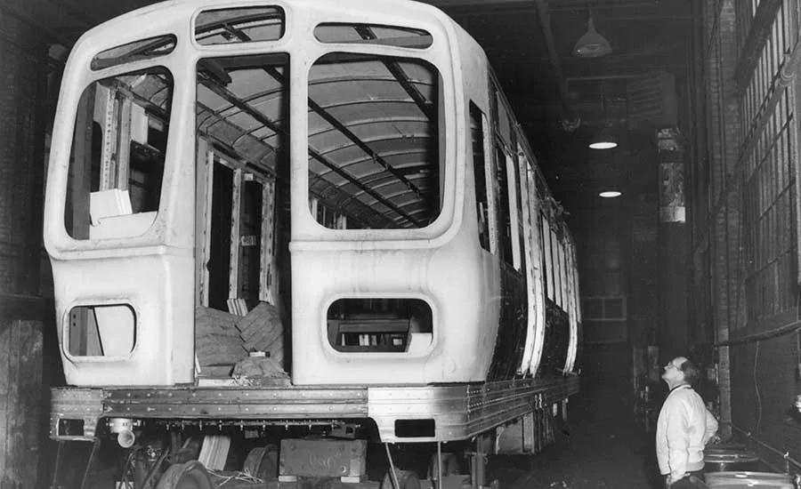

In the early 1960s, Pullman engineers experimented with new ways to mix lightweight materials, such as aluminum and fiberglass. This car is being built for use on the Chicago Transit Authority’s “L” system. Photo courtesy of Krambles-Peterson Archives

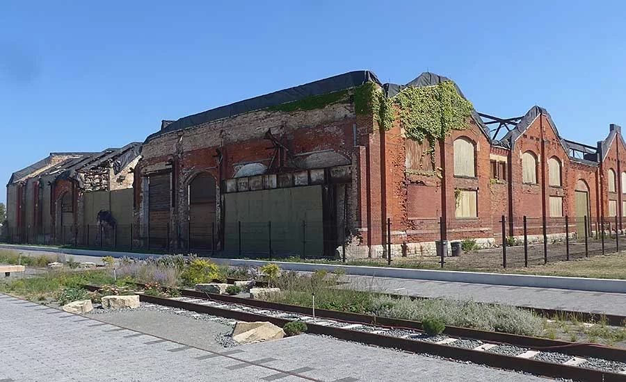

Pullman rail cars were once assembled within these factory walls. However, this derelict building is still awaiting renovation. Photo by Austin Weber

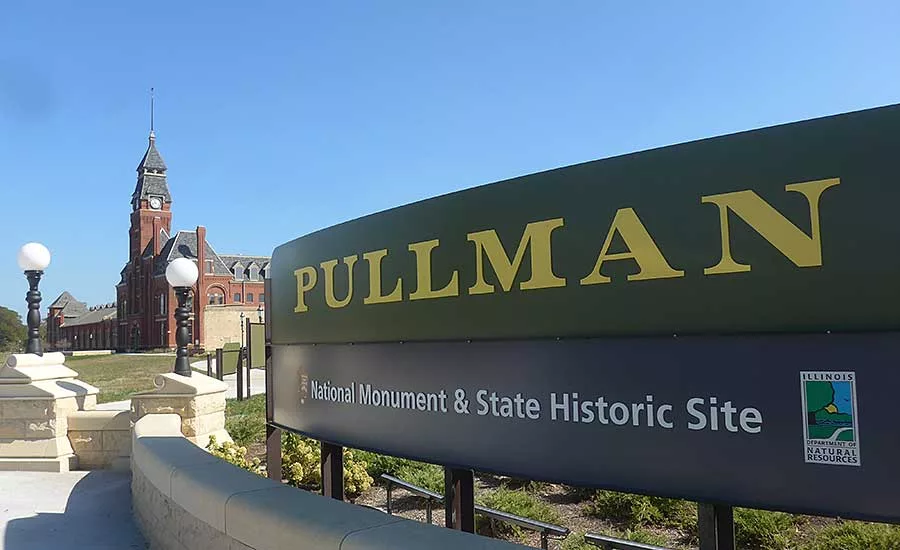

America’s newest national park recently opened on the South Side of Chicago. The Pullman National Monument celebrates the unique history of a company that mass-produced freight and passenger rail cars at the site from 1881 to 1981.
In addition to playing an important role in manufacturing, Pullman had a leading hand in both the organized labor and the civil rights movements. All three achievements are celebrated at the visitor’s center, which is housed in a red brick Romanesque-style building that formerly served managers and engineers at the vertically integrated production complex.
The Administration Clock Tower Building forms the centerpiece of the 12-acre national monument grounds, which features several historic Pullman buildings. Unfortunately, much of the manufacturing complex, located near the intersection of 111th Street and South Cottage Grove Avenue, was destroyed by a fire several decades ago.
However, numerous brick duplexes and row houses remain standing a few blocks away, and most are still inhabited in one of Chicago’s most unique neighborhoods. They were once part of a controversial “model town” that was built to house rail car workers and their families. The utopian community, which contained homes, churches, parks, shopping areas, a hotel and a library, plus an innovative sewage system, was once hailed as the “world’s most perfect town.”

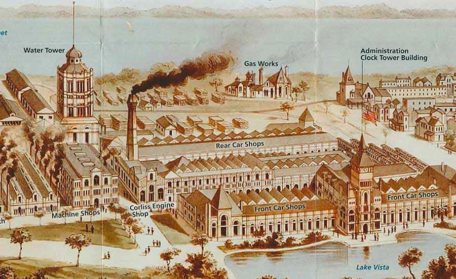

One of the highlights of the Pullman complex that most visitors were enamored with was a giant stationary steam engine that powered equipment through a network of line shafts and belts. The 1,400-horsepower Corliss machine was 45 feet tall and weighed 56 tons. It was the star attraction of the 1876 Centennial Exhibition in Philadelphia.
After the world’s fair ended, the steam engine was purchased by Pullman, dismantled and moved to Chicago in 35 freight cars. It was in operation for 30 years until the company switched to electricity in 1910.
The backbone of the huge manufacturing complex was 3,268 feet of main power shafting that ran in tunnels approximately four to five feet underground. The mechanical network consisted of 13,000 feet of overhead shafting, 3,000 pulleys and more than 89,000 feet of leather belting that ran 900 machines in the factory.
In addition to the Corliss engine, a variety of smaller machines provided supplemental power to various parts of the facility. For instance, machinery in the freight car shops, which produced more than 40 boxcars and other pieces of rolling stock a day, was powered by a 900-hp engine.
Metal used in Pullman cars was machined in a three-story facility that contained boring machines, drills, grinders, lathes, planes, punches and other state-of-the-art devices. Hydraulic presses were used to attach 350 wheels a day to axles.

A key feature of the Pullman factory were several transfer tables that enabled workers to laterally move cars from one bay to another to complete the assembly process. In 1882, a mechanical engineer named Norman Robinson invented a device that used a small steam locomotive to roll a table between shop stalls.
Each transfer table locomotive was operated by an engineer and two helpers, who worked a clutch, cables, pulleys and a hook that pulled each car off the movable table into a stall for further assembly. One machine and three men could perform a task that formerly required 40 men. The steam-powered transfer tables kept operating until about 1918, when they were replaced by electric power.
Contemporary accounts of Pullman manufacturing processes, such as an article in the April 30, 1892, edition of the Railroad Car Journal, indicate that the progressive assembly of railroad cars typically involved four to five movements on the transfer table.
Each car was built in a stationary position, with “gangs of builders” moving from car to car to perform their specialized functions, such as “roofers” who applied roof boards and moldings, “tinners” who put on tin roof covers, and “trimmers” who installed bronze or plated trimmings on blinds, doors, sash and walls.
“The work is so systemized that as soon as one gang finished its work, another comes along,” explained the article. “In that way, the tinsmiths, steam-pipe fitters, carpenters and painters all work speedily without being in each other’s way. When a car has been completed, it is drawn out, and the trucks for a new one are placed on the erection tracks.”

Early assembly operations at the Calumet Shops relied on a custom manufacturing process that was carried out at individual stations where each car sat for a number of days. According to the Michigan Tech report, “materials were brought to [the car] and it was in no way an assembly line process.
“The car assembly process was a combination of batch production and station work. Each order —whether it be for one car or two dozen—was its own unique thing. The car length, compartmentalization, layout, amenities and virtually every detail could be specified by the ordering railroad.”

As railroad car construction switched from wood to steel, Pullman engineers developed new production tools and adopted new assembly processes, such as riveting. That shift caused a major change in the company’s labor force. Skilled craftsmen who specialized in cabinet making and wood carving claimed they could not “stand the racket” of riveting and were replaced by a new group of workers who required less training.
“At one fell stroke the old order changed to the new,” says Joseph Husband, author of The Story of the Pullman Car (A.C. McClurg & Co.). “An army of steel workers, Titans of the past reborn to fulfill a modern destiny, fanned the flames in their furnaces and released the leash of sand blast, air hose and gas flame.”
Many wood-era Pullman workers were immigrants from Germany, Holland and Sweden. Their replacements were primarily new arrivals from Czechoslovakia, Hungary, Italy and Poland.
However, despite new production tools and equipment, passenger car manufacturing remained relatively complex, because each railroad wanted its rolling stock to have a different look and feel than competitors. While cars often looked the same on the outside, each interior often had different amenities and layouts.

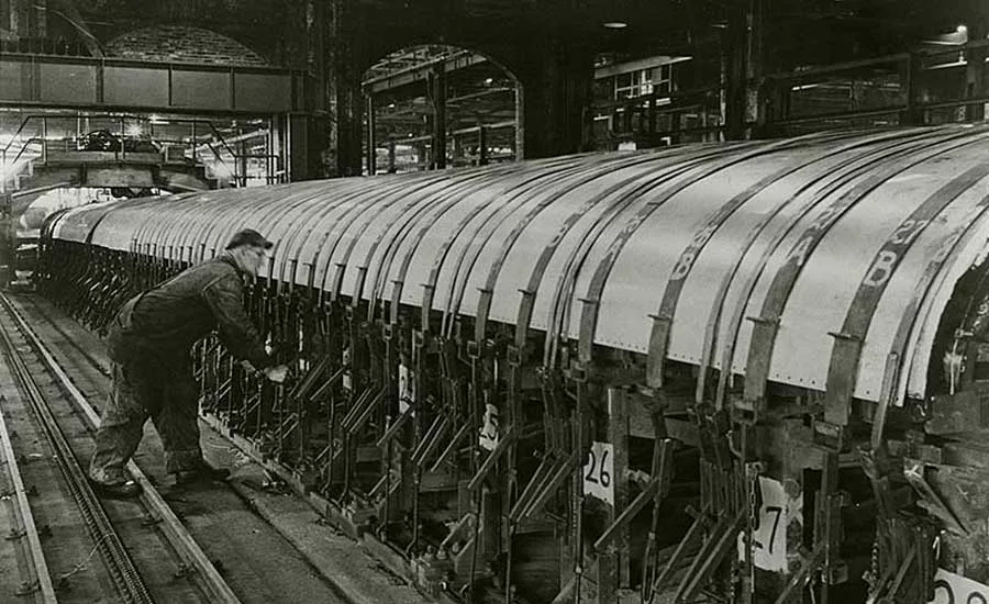

The introduction of lighter, streamlined cars also sparked new assembly processes, such as welding. Arc welding was used on the underframe and side frames of cars, with electric spot welding used to join side panels and roofs. Engineers discovered that the skin of a car could serve as an integral part of the structure, resulting in greater strength with less material and less weight.
Each side of a car was formed of 15 separate pieces with hundreds of corrugated stiffeners welded to them. Pullman engineers developed a 45-ton spot welder operated by a “magic eye” that could make 1,400 welds per minute. A total of 28 stainless steel sheets were formed over a frame as the traveling bridge made 8,000 spot welds while simultaneously seaming sheets together to form a continuous 85-foot roof for each car.
Once these and the ends of the car had been prefabricated, a team of assemblers would “lay down the car,” installing components such as interior trimmings, plumbing and wiring. Inside each car, Pullman used aluminum walls, window frames and vestibule doors.
Pullman engineers also pioneered multimaterial designs and lightweight materials such as fiberglass, plymetal (metal-faced plywood) and prestwood (a forerunner of particle board).
