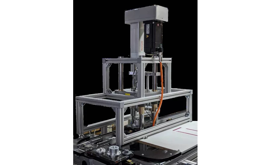

The Smart Function Kit from Bosch Rexroth has enabled Sensata to cost-effectively produce 1,000 or 10,000 versions of a sensor in small batches on this assembly line. Photo courtesy Sensata Technologies Inc.

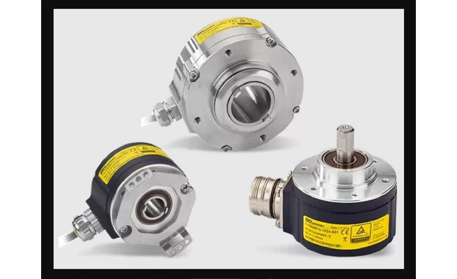

Sensata makes a wide range of rotary encoders, including incremental, absolute and functional. Photo courtesy Sensata Technologies Inc.

For the past year or so, SMF has enabled Sensata to cost-effectively produce 1,000 or 10,000 versions of a sensor in small batches on one assembly line, rather than several. These sensors are used in the manufacturer’s rotary encoders, which determine position and distance in products like self-propelled transport shuttles.
On the assembly line, the sensor’s PCB and disc are placed in a housing and fixed with a lid. The SMF electromechanical cylinder, in turn, quickly, precisely and reliably presses three distance bolts into the housing flange to join both components. The cylinder has a force range from 2 to 30 kilonewtons, with an accuracy of ±0.02 millimeter.
Also included in the kit are a force sensor, a servomotor, a drive controller and an industrial PC with intuitive HMI software. The software performs automatic parameterization of the servo drive, and it also acts as a support wizard to ensure fast, easy commissioning. It is device-independent, runs on any browser and can be operated via tablet.
Separate linear motion software, called LinSelect, helps engineers select and size the correct kit for an application. After the end-user selects the proper-size components, he downloads CAD files for each component and designs the system with an online configurator. This desired configuration is then ordered via the Bosch e-shop, with all components being delivered as one complete package.
A key benefit of SMF for Sensata engineers is being able to use visual programming instead of coding line by line. This involves selecting predefined software blocks and creating a sequential workflow via drag and drop, according to Marc Hubsch, engineering manager in the encoders division at Sensata.
To define the individual processes in the joining procedure, the engineers simply enter the associated parameters. Overall engineering time is reduced by up to 95 percent.
“For monitoring purposes, status information and process results, including a force displacement curve, are shown and recorded live,” says Hubsch. “All data is transferred straight to our IT system, where it is stored and analyzed for quality assurance purposes. This means much greater transparency during production.”
