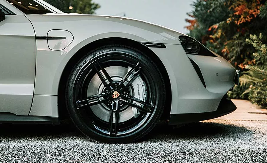

Electric vehicles such as the Porsche Taycan demand a new breed of tires that reduce rolling resistance. Photo courtesy Pirelli

According to Misani, new products aimed at EVs, such as Pirelli’s P Zero Elect tire, need to be designed holistically using innovative materials that reduce rolling resistance, while at the same time reducing wear without altering the thickness of the tread pattern. This is developed alongside a structure that supports the vertical load and can also adequately put extra torque on the ground in all sorts of driving conditions.

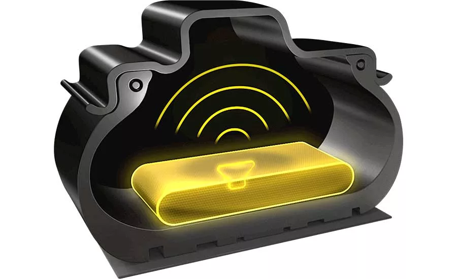

“All this without compromising on acoustic comfort, which we achieve by reducing road noise thanks to a specific design of tread pattern and other technologies such as the Pirelli Noise Cancelling System (PNCS),” explains Misani.
PNCS technology consists of a special sound-absorbing material that is placed within the tire. It helps deaden air vibrations that would otherwise be transmitted to the inside of the vehicle. The benefits of this system can be felt both inside and outside of an EV.

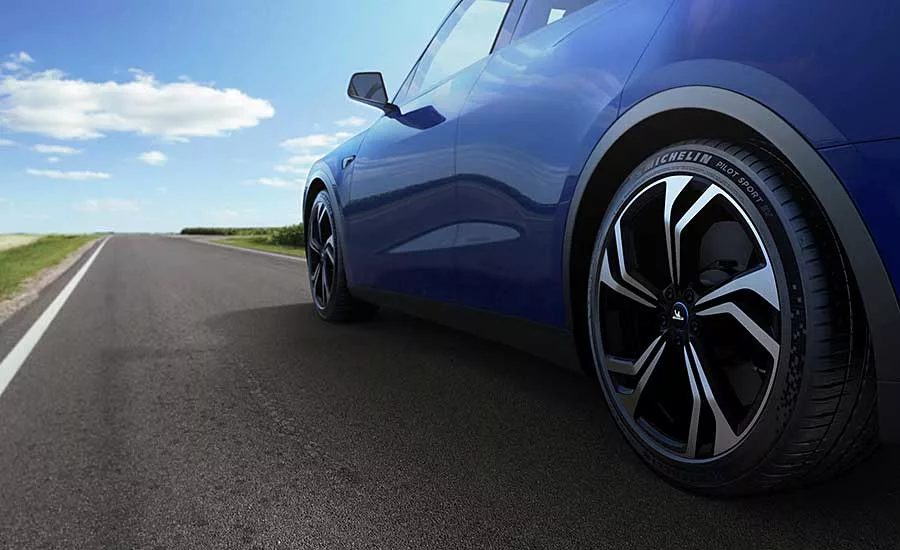

The company’s Pilot Sport EV tires, which are being used on the Tesla Model Y, benefit directly from the progress Michelin has achieved over seven seasons of Formula E competition. It incorporates ElectricGrip Compound technology that features a hard compound for the center of the tread to provide the grip required to cope with the high torque characteristics of electric cars.
The Pilot Sport EV line of tires use two tread compounds and represents the company’s first full line that is made to maximize the performance of EVs. It was developed as an EV tire and supports high torque loads, addresses noise and improves range. In addition, there is a separate tread compound on the shoulders, which is designed to lower rolling resistance.

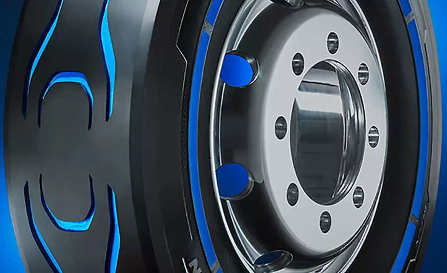

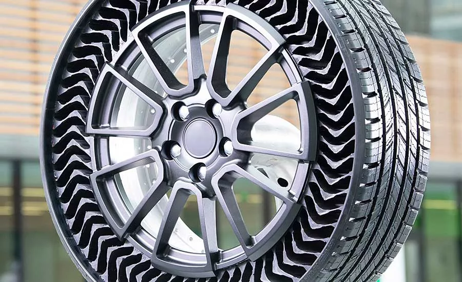

Michelin engineers also recently developed a Unique Puncture-proof Tire System (UPTIS) prototype, which is a combined airless tire and wheel assembly for passenger cars. It has already been successfully tested on the Chevrolet Bolt, and General Motors plans to equip other vehicles with the airless tire in 2024. UPTIS features an aluminum wheel and a flexible load-bearing structure made from glass-fiber reinforced plastic.

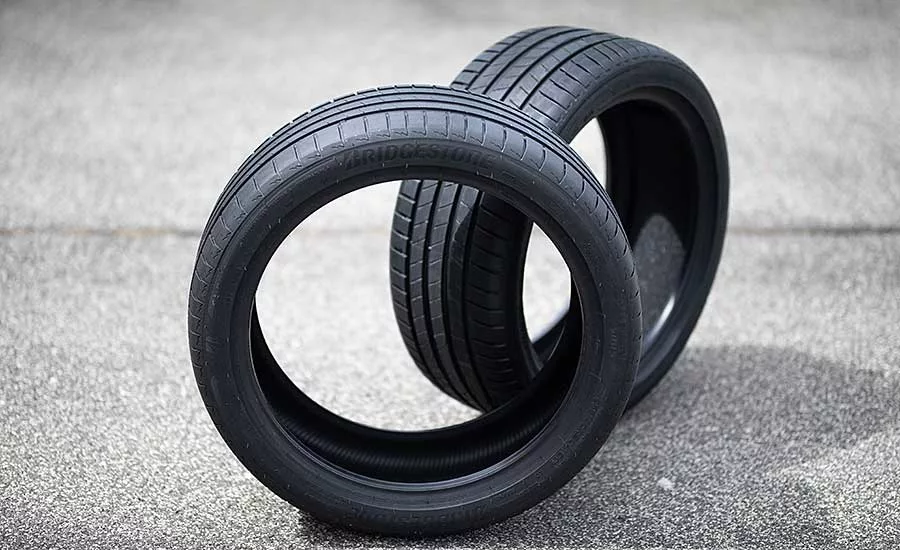

According to Buxton, Bridgestone’s ENLITEN technology reduces tire rolling resistance by up to 30 percent and decreases overall tire weight by up to 20 percent. It also extends the driving range of EVs and contributes to reduced environmental impact, thanks to improved resource productivity. The tires are currently used on vehicles such as the Audi e-tron and Q4 e-tron, the Fisker Ocean, and the Volkswagen ID.3 and ID.4.

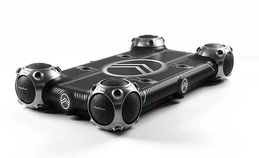

Goodyear recently unveiled what the tire of tomorrow may look like. Its Eagle 360 spherical concept is a ball-like tire that was showcased on the Citroën Autonomous Mobility Vision prototype vehicle, which features an electric multidirectional platform. The Citroën Skate can accommodate multiple types of pods, allowing it to cater to a variety of mobility applications.
“The Eagle 360 prototype is compact and its shape makes it agile and maneuverable, ideal for future urban and autonomous mobility [uses],” claims Hans Vrijsen, managing director for original equipment at Goodyear.

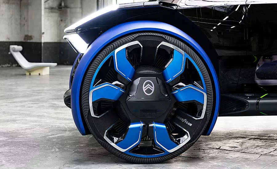

Goodyear engineers also worked with Citroën on an autonomous vehicle concept to mark the French automaker’s centennial. The Citroën 19_19 is equipped with Goodyear C100 prototype tires.
Each C100 tire is nearly 1 meter in diameter, compared to 60 centimeters for an average tire. This larger diameter would lower rolling resistance to increase the energy efficiency and range of the vehicle.
The C100 features a nature-inspired tread design that provides both comfort and handling benefits. With nearly 100 more blocks in its tread band than an average tire, the C100 would deliver a far quieter ride. In addition, the tread groove compound is inspired by the attributes of a natural sponge.
