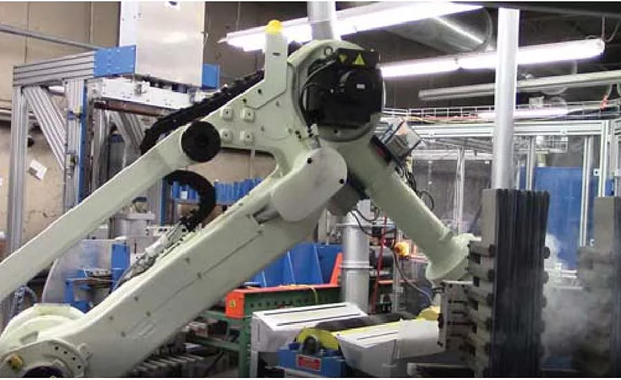

Here, a large robot runs battery plates over a large bristle brush to remove any lingering debris from the end connectors (called lugs). Photo courtesy Kawasaki Robotics U.S.A. Inc.

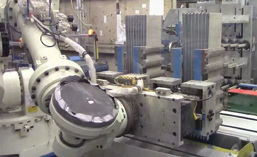

The semifinal assembly step involves dipping lugs into tin and then into molten lead (shown). Photo courtesy Kawasaki Robotics U.S.A. Inc.

From there, the robot picks up the plates and runs them over a large bristle brush to remove any lingering debris from the end connectors (called lugs). After the lugs are dipped into tin and then into molten lead, the robot places the plates into the casing.
