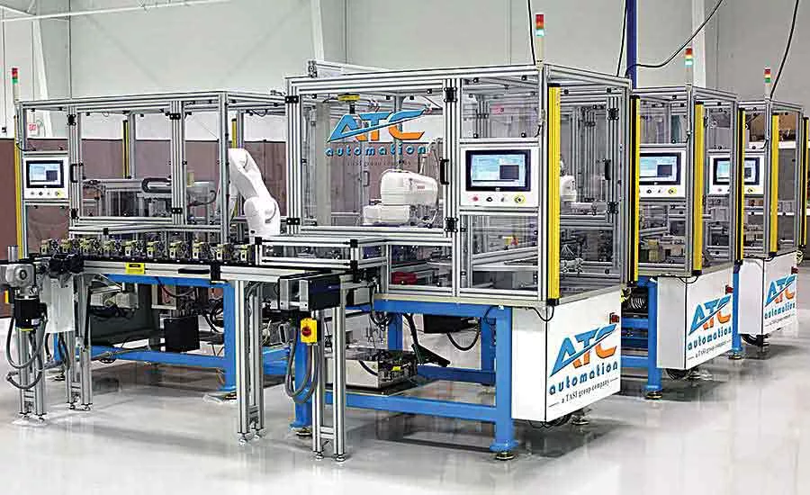

To ensure the success of a capital equipment project, engineers should choose a systems integrator wisely. Photo courtesy ATC Automation

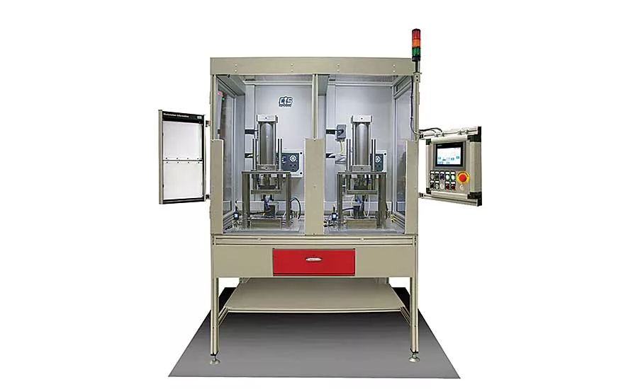

The best strategy for a runoff is to get your team involved in establishing the criteria for equipment acceptance. Photo courtesy Cincinnati Test Systems Inc.

Poor vendor selection is the No. 1 reason capital projects fail. Just because a company meets the budget does not mean they qualify as a competent vendor. Selecting a vendor is akin to marriage. After you commit, a piece of equipment will result from the marriage. Choosing the wrong partner will result in a nightmare, because there is no easy way out after the project has begun.
I have had customers select vendors simply because they were located nearby, and their engineers could live at the vendor’s facility if necessary. The flaw in this thinking is that you don’t control the vendor’s resources. Just because your engineers show up at the vendor every day does not mean it will comply with your expectations.
Choosing the lowest bid is another excuse I have heard many times, and these customers always get what they pay for. When you buy cheap, you get cheap.
“They can meet our timeline” is another common excuse for poor vendor selection. Some potential partners whisper sweet nothings in your ear to win your business, but know that they won’t meet the delivery requirements.
How do you avoid making a poor vendor selection? Get clear on the type of company you want to work with and don’t compromise during the selection process. The right fit is out there, but it often requires vigilance to find it.

The sixth major reason for capital disaster is a lack of a detailed runoff plan. The best strategy for a runoff is to get your team involved in establishing the criteria for equipment acceptance. The quality engineer should provide a quality plan and all necessary gauging. The materials group should have all the necessary parts shipped to the equipment builder. The equipment builder should provide an inventory upon receipt of parts to make sure all parts are accounted for and ready to go. The safety team should have already been to the supplier to sign off, ensuring the equipment meets safety standards. The maintenance team should have been to the builder several times to identify any concerns regarding specification compliance. The operations group should have been alerted as to the number of operators that will be required for runoff, and all travel arrangements should be made. There should be a detailed onsite plan to prep, train, and qualify the equipment to ensure that the operators are used efficiently so they can return to your plant as soon as possible.
How do you avoid not having a runoff plan? Make a plan well ahead of the actual runoff. You will want to have your team members provide you with plans for their areas of responsibility. Reviewing the plan before and during runoff is critical to keeping things running smoothly!
