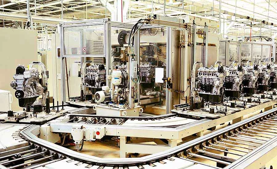

A good URS lays down context and background and works as a roadmap to connect the dots from preconception to postproduction. Photo courtesy EU Automation
