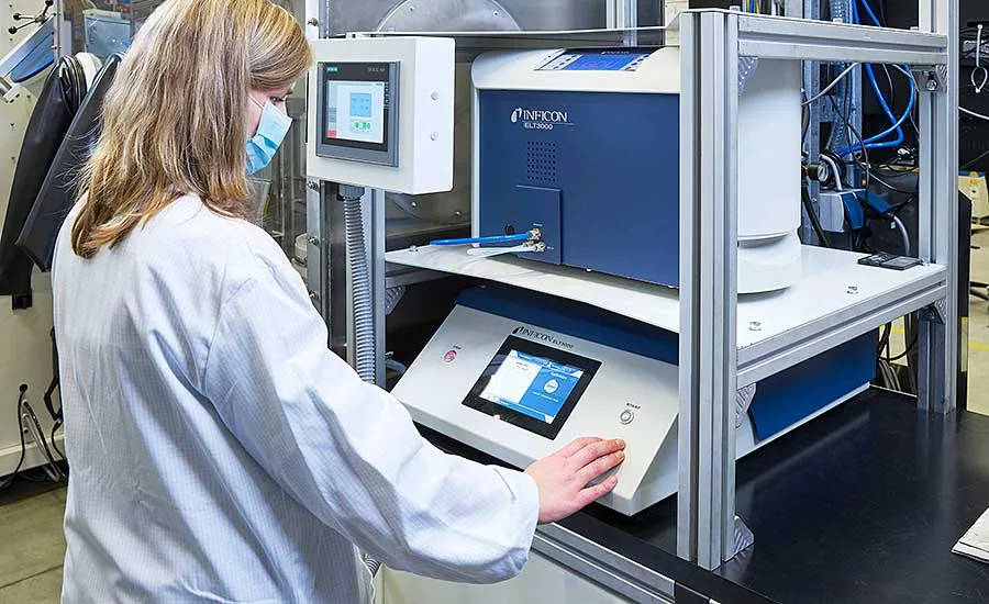

According to Parker, empty hard-case battery cells currently can be checked by filling the cells with helium test gas to detect leaks in a vacuum chamber. Electrolytes are not inserted into a hard-case cell until after it has been dry tested.
Helium bombing is an alternative approach. In this case, battery cells are placed in a vacuum chamber and exposed to helium under pressure. The helium is able to enter through existing leaks, then can be measured when it escapes back into the vacuum chamber.
However, neither test method has provided the reliably consistent results needed to establish industry-wide standards for battery-cell leak detection.
“Tracer-gas test methods are the most suitable for most testing tasks for alternative drive components,” says Parker. “In fact, tracer-gas tests can detect leaks that are 1,000 times smaller than air tests currently in use.”

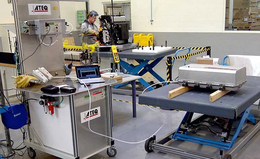

Manufacturers use both in-process and end-of-line leak testing. The former tests components and subassemblies during various steps in the production cycle. The latter is the last checkpoint before a finished product leaves the factory floor. When a test correctly identifies a defective unit, it must be reworked or scrapped.
“In-process leak testing catches any quality problem early at component level before putting together a full battery module or pack,” says Anne Marie Dewailly, technical director at ATEQ Corp. “An end-of-line test guarantees that the final assembly of the cooling circuit does not leak coolant inside the battery and that the enclosure is protecting the inside of the battery against water, mud or other types of splashing moisture.
“For EV batteries, there are multiple solutions and no standard practice exists,” explains Dewailly. “The whole battery pack is tested with air after assembly, but its components are tested differently. For instance, the cooling circuit is leak tested with air, while the battery cells are tested with either tracer gas or ionized air methods.
“An in-process leak test is [necessary] to check every battery subassembly, such as cells, cooling plates, cooling circuits, venting valves, trays and covers,” Dewailly points out. “In-process leak tests are fast and provide instant feedback about the processes that affect the leaks. Some components inside the battery, like the cells, are not accessible after final assembly and have to be leak tested beforehand. For cost reasons, you want to know if a battery tray is leaking before putting cells and modules into it.”
“In-process tests enable you to discover things such as defective electrical feedthroughs, cooling circuit piping and tubing, heat exchangers or lids,” adds Inficon’s Parker. “One type of leak test cannot replace the other. You just can’t do in-process testing on individual components and not do a final test on the finished battery pack.
“The biggest benefit of end-of-line leak testing is keeping defective product away from the consumer,” says Parker. “If you don’t do a good final test, the next testing station is going to be at the dealership. Consumers are already weary of EVs, because of range anxiety and fire risks. If you don’t catch a problem in the plant, the end users will catch it at their dealership or in their garage.”
Typically, two leak tests are done on battery packs. First, the cooling circuit is tested before the battery modules are inserted into the tray. The second test is done after the cover or lid is attached.
“The coolant test is typically 1 to 5 sccm (standard cubic centimeters per minute) with cycle times in the 180 to 200 second range,” says Cincinnati Test Systems’ Hagyard. “The battery pack test has a wide range of specifications from as low as 10 sccm to 500 sccm. Cycle times for the battery pack test are in the 15 to 500 second range, depending upon the size of the battery and the leak rate.
“The in-process test is essential, because a leak in the coolant circuit will not be caught while the cover leak test is being performed,” explains Hagyard. “The two tests are essential in verifying the integrity of the battery pack assembly process.”
“In-process testing allows easier repair and replacement of leaking components prior to the completion of a final assembly and finds leaks before more value is added into the product,” adds Splete. “Final assembly testing may still require non-water leak rates, which become more challenging as the assembly is larger than subassembly testing.”
