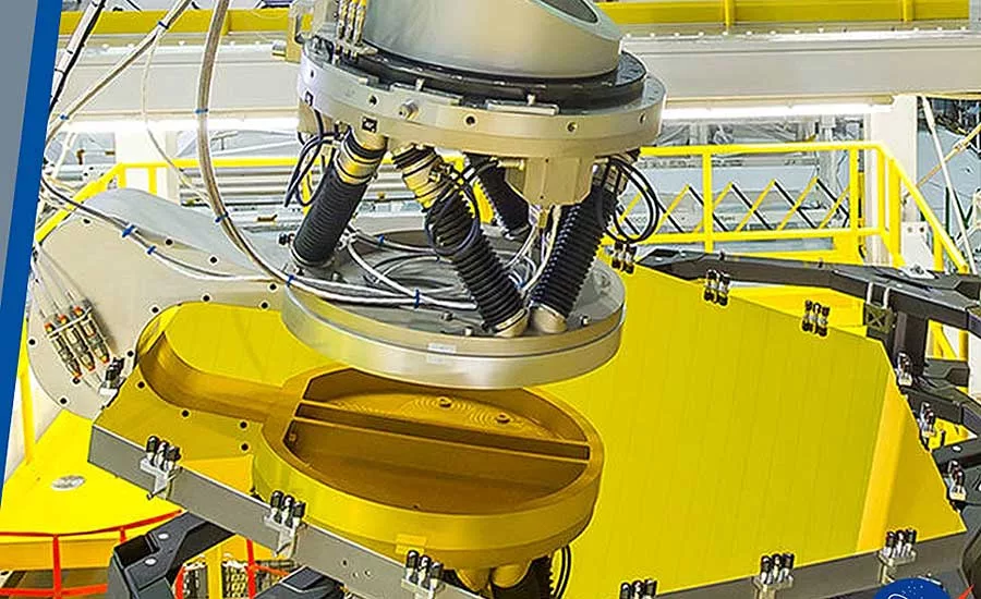

The Stewart Platform, a custom hexapod, precisely controls the Primary Mirror Alignment and Integration Fixture as it joins together the 18 segments of the main James Webb Space Telescope mirror. Photo courtesy NASA

NASA engineers used a robotic arm, called a Primary Mirror Alignment and Integration Fixture, to join the segments. The arm was precisely controlled in six axes by a custom hexapod (the Stewart Platform) made by Auburn, MA-based Physik Instrumente (PI).
Positioned at the arm’s end, the hexapod has a 200-kilogram load capacity, and offers submicron resolution with a programmable center of rotation, or pivot point. Accompanying software simulates the limits of workspace and load capacity, thereby ensuring that the hexapod will handle the specific loads, forces and torques in an application. All of these features enabled NASA engineers to keep each segment precisely aligned during assembly.
