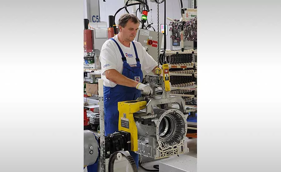

When assessing an assembly line, experts look for flexibility and space utilization. Photo courtesy Behr Group

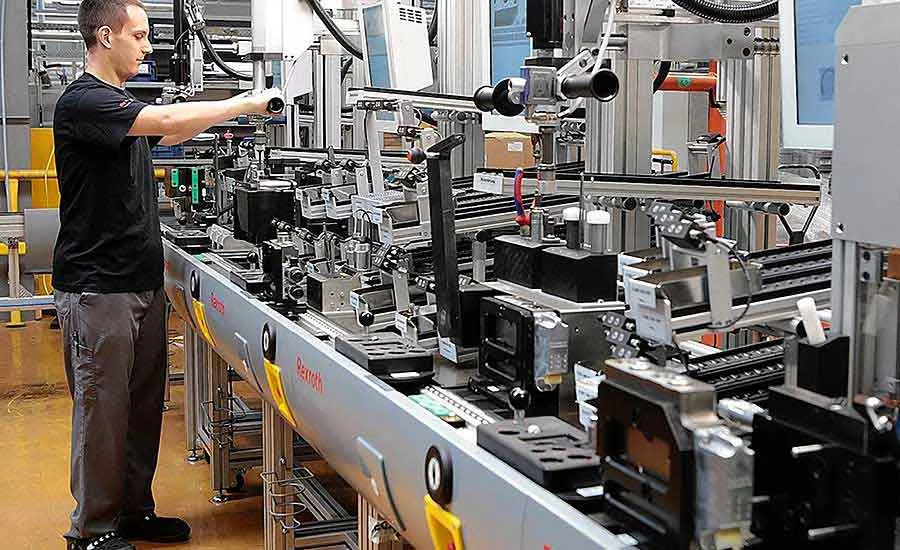

A variety of metrics can help when assessing an assembly operation, including safety, productivity, quality, delivery and lead-time. Photo courtesy Bosch Rexroth

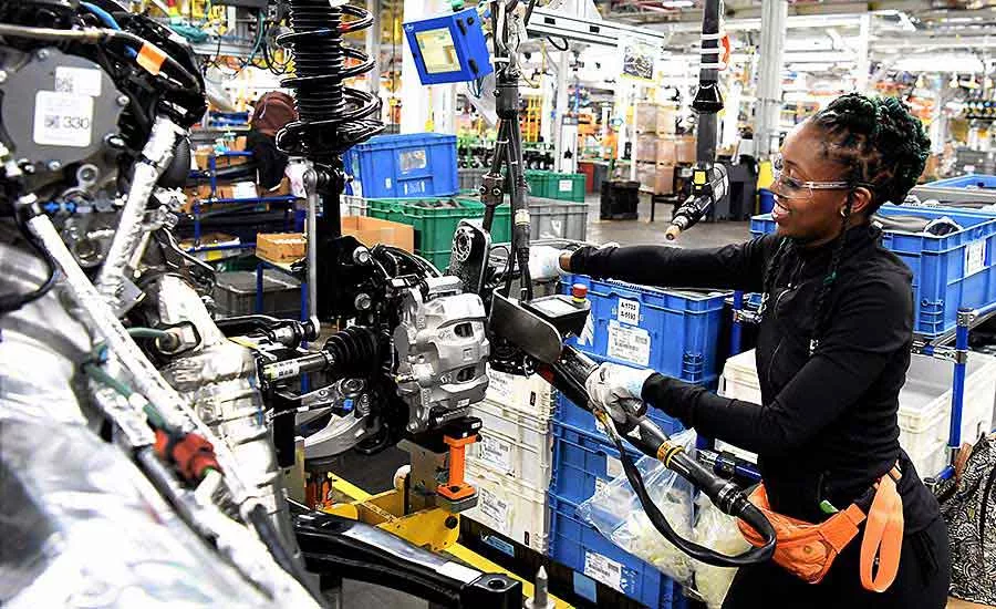

On a well-run assembly line, products flow from raw materials to finished goods without interruption and without going backward. Photo courtesy Ford Motor Co.

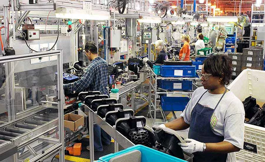

When evaluating a line, engineers would be well-advised to spend time talking to workers. They often have a good idea of how well the line is really running. Photo courtesy Formaspace

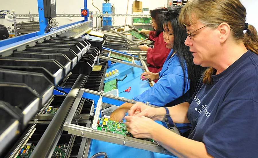

Engineers can get a good sense of how a line is performing by looking at how much time each worker spends actually assembling something as opposed to getting parts or waiting for the next unit to arrive at their station. Photo courtesy Allison Transmission
