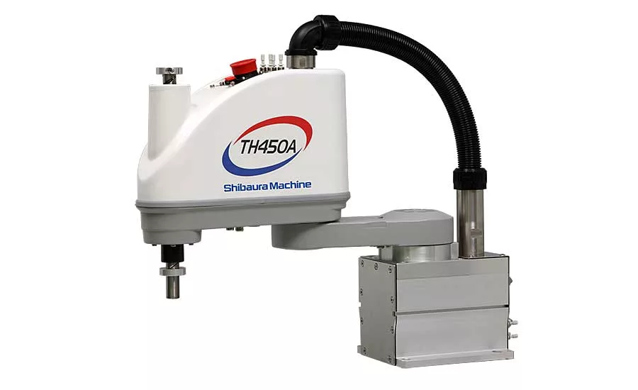

Ideal first projects for automation involve low risk and low cost. That means simple motion, simple tooling and consistent, repeatable positioning. Photo courtesy TM Robotics

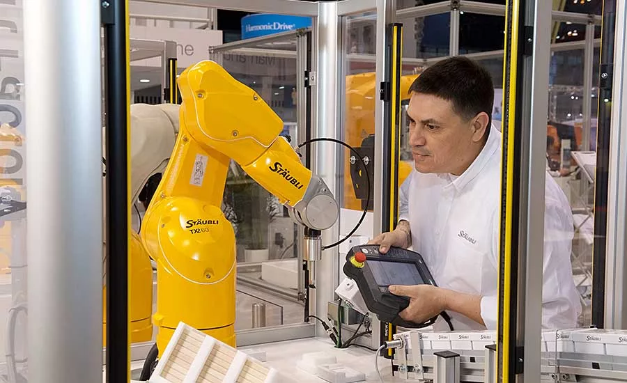

Comparing older generation robots with today’s models is like comparing a rotary dial telephone to a smartphone. Photo courtesy Stäubli Corp.

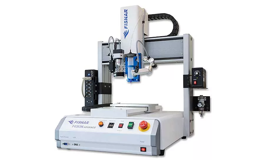

Adhesive dispensing is a good application for first-time automation. For applications requiring hundreds or thousands of parts, rather than millions, a benchtop dispensing robot is ideal. Photo courtesy Fisnar

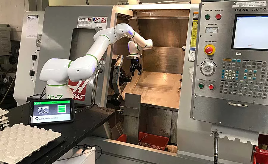

Machine tending a perfect first-time automation project. Cycle times are relatively slow, and the parts are picked and placed in consistent locations. Photo courtesy Productive Robotics Inc.

Dalgliesh says ideal first projects involve low risk and low cost. That means simple motion, simple tooling and consistent, repeatable positioning. A project that needs machine vision to work is not a good application for automation rookies.
He remembers working with a small manufacturer to get a SCARA robot to install caps on small bottles of hardware. A dedicated bottle-capping machine was out of the question. The company is a high-mix, low-volume operation. On the other hand, employing several people simply to install bottle caps was also not very economical. A SCARA solved the problem.
The robot picks up a cap from a vibratory bowl feeder using an off-the-shelf vacuum cup, positions it over the bottle, and tightens the cap with a slight rotation of the Z axis. Simple motions, simple tooling, no integrator required.
“All totaled, that application cost the company maybe $20,000,” says Dalgliesh.
Gilles Le Quilleuc, head of business for general industry and food at Stäubli Corp., agrees. Certainly, a skilled integrator can figure out a way to automate a complex assembly task using machine vision and numerous sensors. But, the project will cost hundreds of thousands of dollars, and the ROI will be measured in years. With a simpler project, engineers can expect payback in months or even weeks.
The fact that robots have become relatively inexpensive and easy to program has put a variety of applications within the “easy” realm. “Comparing the old generation of robots with the robots of today is like comparing a rotary dial telephone to a smartphone,” says Le Quilleuc. “Twenty-five years ago, you had to be an engineer to program a robot. Today, anyone with simple training can do it. And, with simulation software, you can program the next application while the robot is running the current one. There’s no downtime. Our software is able to simulate things like inertia and cycle time, so when it’s time to run the new application, the robot performs perfectly.”

That makes a task such as machine tending a perfect first-time automation project. Cycle times are relatively slow, and the parts are picked and placed in consistent locations.
“We sell a lot of robots to machine shops that use them to load and unload CNC machines,” says Bogart. “That application is a slam dunk. They can get it up and running in a day. That application will pay for itself in less than a week.”

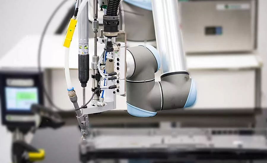

Quality improvement is another way to justify automation, which makes screwdriving a good target for first-time automation.
“It can be very easy for an operator’s mind to wander during the assembly process, especially after he’s driven more than 500 screws in the same manner for a few hours,” says Chris Emanuele, technical automation sales engineer with ASG, Division of Jergens Inc. “That leads to a missed screw or a screw that’s not fully torqued. So, quality improvement is a great way to justify investment in automation.”
Ergonomic improvement can also be used to justify investment in automated screwdriving. “Repetitive motion can lead to stress injuries, like carpel tunnel syndrome,” says Emanuele. “Of course, there are helpful ergonomic aids, but in the long term, the ‘health factor’ could also be used to justify investment in automated screwdriving.”
That said, Emanuele warns that high-mix, low-volume operations might not be the best candidates for a screwdriving robot, particularly if there are wide variations in fastening locations, the size and shape of the parts, or the number of fasteners to be installed. Modular fixtures, quick-change drivers and adjustable screw-feeding equipment can help, but people are ultimately more flexible in such situations.
Adhesive dispensing is also a good application for first-time automation. For applications requiring hundreds or thousands of parts, rather than millions, a benchtop dispensing robot is ideal.
“The price of benchtop dispensing robots has come down so much in the past decade, they really are an attractive option for small and midsized manufacturers or contract manufacturers,” says Robert Campbell, global product manager at dispensing technology supplier Fisnar. “Basic benchtop dispensing robots start as low as $5,000. With that low price point, the ROI is very fast.”
A dispensing robot can decrease labor costs, improve quality and minimize wasted material. “An operator can’t dispense a dot of material in the exact same place every time, whereas a robot can,” says Campbell. “The same is true when dispensing beads or coatings. It’s very hard to move a handheld syringe along a path at the same linear rate of speed, whereas a robot can move at a constant linear rate so you get a consistent bead of material or an even coating.”
However, Campbell cautions engineers that dispensing robots are best for applications that don’t require a lot of dexterity. “Remember, the robot is trying to mimic the motion of a human arm and hand with just three axes of motion,” he says.
