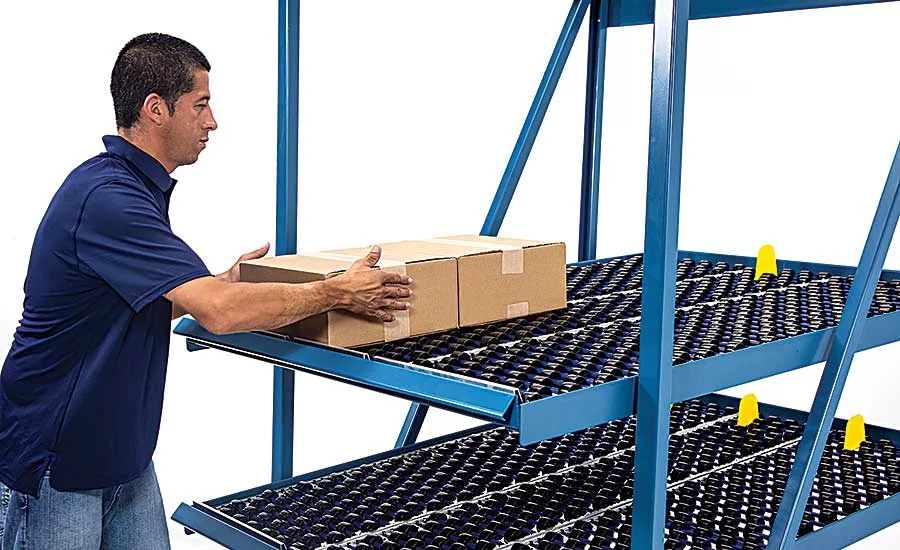

Span-Track and Shelf-Track flow tracks from UNEX make it easy for workers to store and retrieve products from cartons or totes. These modular tracks integrate easily with any new or existing pallet rack structure, enabling engineers to create flow racks tailored to their specific operations. No shelves or intermediate supports are required.
The tracks can be configured for full-case or split-case order picking. The track’s rollers provide a high amount of surface contact, so carton weight is distributed evenly. This optimizes product flow and eliminates hang-ups on the track.
The racks are available in light, standard and heavy duty capacity versions. They come in six widths, ranging from 6 to 24 inches. Racks of various widths can be combined to match a specific need. For example, a 96-inch-wide bay can be equipped with four 18-inch-wide beds and two 12-inch-wide beds. Product can overhang the lane by up to 3 inches on either side and maintain flow.
Various options and configurations are available. For example, a low-profile knuckled track has a short section at the front (12, 16, 20 or 14 inches long) that is angled at 20 degrees to give pickers easier access to a carton’s contents.
