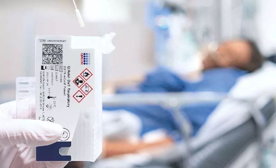

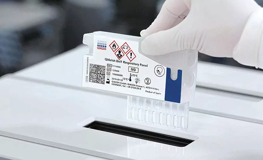

Each small test cartridge contains everything necessary, including solid and liquid reagents, to detect a specific pathogen. The cartridges are simple to handle. A sample is taken from the patient and inserted into the cartridge. Only a few steps are required to insert it into the analyzer. After only one minute, the test can start.
Like all medical devices, the test cartridges must meet high quality standards. To ensure that test liquids do not leak, the cartridges must be absolutely leak-proof. At the same time, production costs must remain as low as possible, since each cartridge can only be used once.

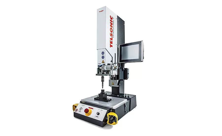

Two USP750 ultrasonic welding systems from Telsonic are now in operation at Qiagen’s assembly plant in Barcelona, Spain, where the test cartridges are made. One of the machines was already in use before the pandemic; the second was added due to increased demand. Both are housed in sound enclosures that provide effective shielding for employees. Each day, the devices assemble some 2,000 cylindrical plastic parts for the cartridges. The assemblies are secure and leak-tight.

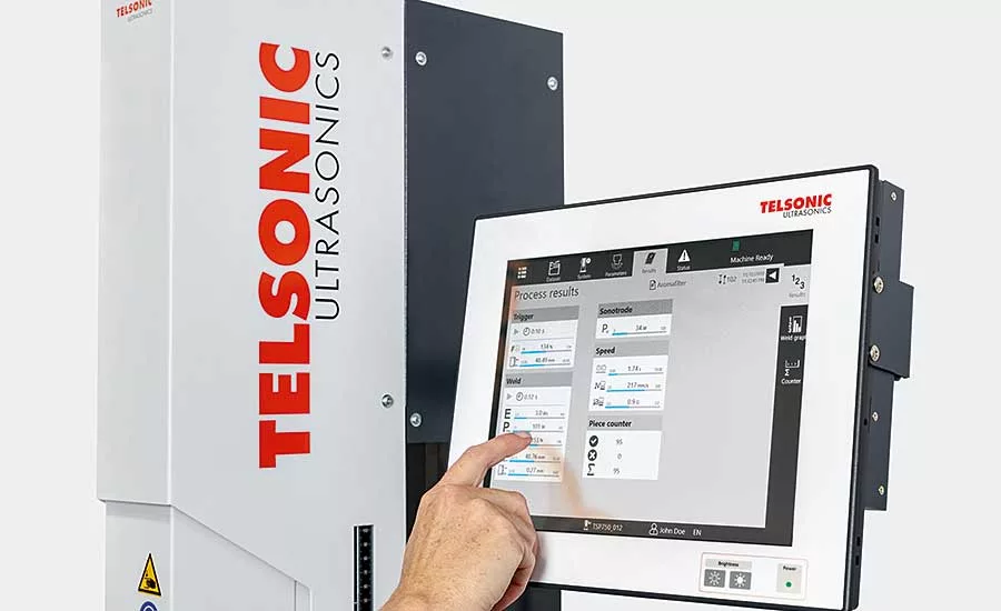

Telsonic’s USP ultrasonic welding systems can be used to join both small and large parts in a variety of industries. The stable press design can be extended with modules and operated in combination with a TelsoFlex controller and MAG generator to provide maximum process control. A range of welding modes and trigger types enable optimum ultrasonic processing of plastic parts. Welding results are monitored in quality windows and automatically evaluated both graphically and statistically. This guarantees that the test cartridges can be manufactured in large quantities with consistent quality.
