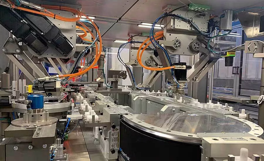

Servo-Driven Modules Simplify Setup of Assembly Systems
Symphoni from ATS Automation is a compact, self-contained, pre-engineered automated assembly cell. Equipped with standard servo-controlled devices, including a high-speed delta robot, the cell can be configured to make a wide range of products, from simple two-piece assemblies to complex products having dozens of components and specialized processes. Systems are easily scaled to meet changing needs as a product progresses through its life cycle: from low-volume samples to high-volume production.
The motions of handling and assembly components are governed by electronic camming and are, therefore, fully flexible and digitally configurable. Adjustments to electronic cam profiles can be made at any time through the HMI. Different products requiring different assembly sequences and different motion profiles can run on the same system with menu-based selection.
A central “master cam” serves as an electronic line shaft, synchronizing motions system-wide, while individual stations in individual modules remain locally configured and controlled. The position, velocity, and acceleration of all devices are specified at 1 millisecond intervals.
Assembly systems can be configured with whatever number of modules and stations are required to assemble the given product. Each module controls its own automation equipment while synchronizing to the system’s electronic master cam.
The coordinated multi-axis motion control is managed by the Symphoni OS embedded in each module. Engineers easily set up station operations through a high-level, Excel-based configuration tool—the same tool used to visualize and validate station operation via Solidworks simulations.
The Symphoni HMI grants password-protected access to qualified users to make system-wide configurations, including configuration and selection of recipes; selection of machine rate; adjustment of pallet and pick-and-place positions (in 0.01-millimeter increments); and modification of tool motions and servo profiles.
The workhorse of Symphoni technology is its versatile, high-speed delta robot. When equipped with servo-driven end-effectors, it can pick up randomly oriented parts and rotate them to a precise radial position with friction-free contact. When equipped with an optional tilt axis, it can invert parts or carry out assembly tasks at selectable angles.
Unlike general-use delta robots, the Symphoni robot can handle high forces. Its arms have been optimized through finite element analysis for minimum mass and maximum strength, giving it the nimbleness to stroke at high rates and the power for heavy-duty operations. The robot is also easy to use. Its motions are configured with selectable profiles preprogrammed for common assembly tasks. Up to two Symphoni robots can be pre-packaged in a module.
Most assembly systems feature pick-and-place stations in which components received from external feed systems are placed onto a pallet or assembled to another component. The robot coordinates its own movements with the numerically controlled movements of other devices, such as ATS’ SuperTrak linear-motor based conveyor or its RSM rotating disc. The robot can cycle at up to 200 strokes per minute.
For ultra-high-output applications, two or more identically configured robots can operate in parallel, achieving production rates of more than 1,000 parts per minute.
For more information, click here or visit ATS Automation at The Assembly Show Oct. 25-27 in Rosemont, IL.

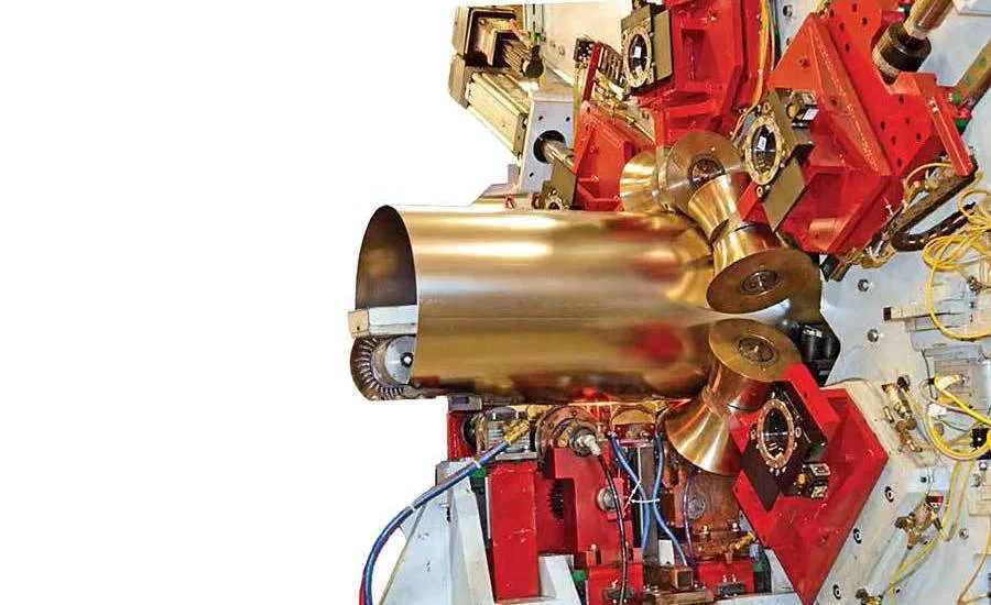

Automated System Welds Seams for Cylindrical Assemblies
Taylor-Winfield Technologies Inc. has developed an automated system for welding long seams in cylindrical assemblies formed from sheet metal.
The system can produce a seam weld via induction forging, resistance welding, MIG welding or TIG welding. The system can weld ferrous or nonferrous metals ranging from 0.052 to 0.077 inch thick. The diameter of the cylinder can be 16 to 20 inches, and seam length can be 20 to 80 inches.
Welding speeds in excess of 325 inches per minute are possible, and the system can achieve a part-to-part cycle time of 15 to 20 seconds. With robotic assistance, changeover time can be less than 5 minutes. The system automatically adjusts weld seam overlap. Weld “overthickness” is 10 to 15 percent or less.
Automated features include servo-controlled diameter adjustment and control; part-to-part machine setup and adjustment; weld parameter storage and retrieval; part positioning and sequencing throughout the system; and system monitoring, fault identification, part tracking and feedback. A poka-yoke system verifies the width and length of incoming parts. Robotic loading and unloading is optional, and the system can be integrated with sheet-metal rolling equipment.

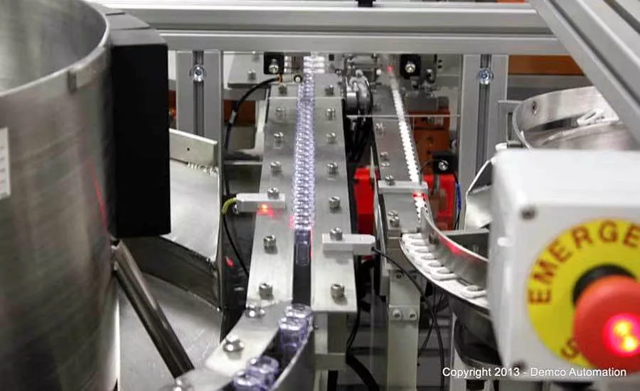

Cooperation Yields System to Assemble Product Variants
Contrary to popular belief, assembly systems can be flexible. East Coast systems integrator Demco Automation recently designed and built a custom automation system to assemble a family of connectors for a medical device. The system can process some two dozen different styles within the family.
To process all the variations, the system was designed to transfer parts using common features. Demco and the OEM worked together to analyze the product offering to determine the maximum number of variations that could be processed reliably and cost-effectively. This approach eliminated low-volume variants with features that would have increased the cost and complexity of the system. By working together, Demco and its customer minimized project risk, increased system uptime, eliminated tooling changeover, and met project cost objectives.
Demco’s system features a walking beam transfer system, two vibratory bowl feeders, a part insertion station, off-loading stations for good and bad parts, and programmable batch counting. Simple and reliable pneumatic mechanisms ensure easy maintenance. Cycle time is 1.7 seconds.
The system includes a programmable batch-size feature to prepare work orders for downstream packing and shipping. Parts are queued in a containment area and dropped into production totes when ready for removal by an operator.
