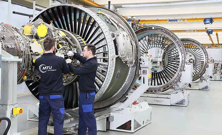

MTU Aero Engines has set up a comprehensive RFID-based system to track and trace parts, equipment and subassemblies. Photo courtesy MTU Aero Engines

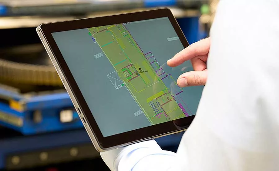

All information can be accessed and managed from a standard internet browser, which means users can see data on their desktop PCs, but also on tablets or smartphones on the shop floor. Photo courtesy Kinexon Inc.

Track and trace caters to many different applications, but at the heart of all of them is the Kinexon operating system. This operating system integrates all location data and combines it with floor plans of the production facilities, maps of the company’s premises, and any production data and rules that have been stored in the system. All this information can be accessed and managed from a standard internet browser, which means users can enjoy all the benefits not just on their desktop PC, but also on a tablet or work smartphone on the shop floor itself.
“You can carry around all these features in your pocket without needing some kind of special industrial device,” says project manager Martin Roth, who is responsible for the IT aspects of the Kinexon OS implementation.

At MTU Maintenance, engines are regularly disassembled into thousands of individual parts before being repaired and reassembled into a functioning engine. “Right now, this process relies on a lot of analog, paper-based methods,” Dix says. “The first thing we decided to do was to track the material-handling equipment that we use to transport and deliver picked engine components to the assembly area.”
In the future, this process will also incorporate automated guided vehicles, which will be equipped with vehicle tags. Later on, the company also plans to tag commonly used tools as well as some of the larger modules of dismantled engines to help workers find what they need quicker.
