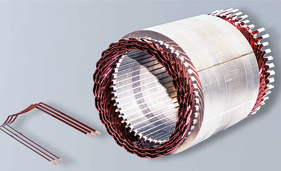

GROB’s electric motor stators (right) contain several winding rims made of individual hairpins (left). Photo courtesy GROB-Werke GmbH & Co. KG

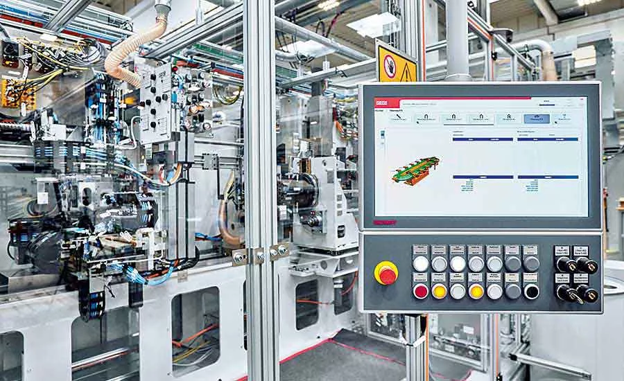

The CP3918 multi-touch control panel, together with an application-specific push-button extension and a user interface created with TwinCAT HMI, enables optimum use of all GROB machine functionalities. Photo courtesy Beckhoff Automation

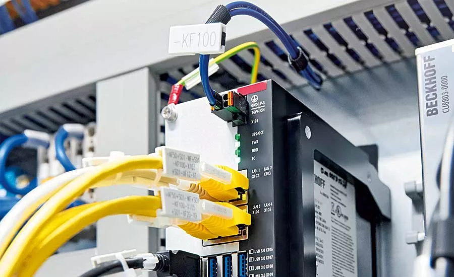

A C6030 ultra-compact industrial PC provides optimal computing power for central control of all process sequences. Photo courtesy Beckhoff Automation

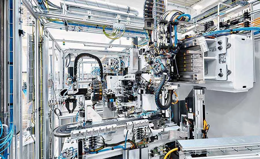

A look inside the machine gives an idea of the complexity and variety of the motion sequences. The XTS linear-motor transport system is in the foreground. Photo courtesy Beckhoff Automation

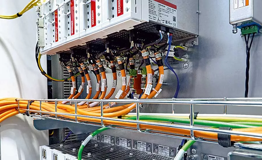

AX5000 servo drives are primarily used to control AM8000 servomotors. Beckhoff’s One Cable Technology minimizes installation space and cabling effort. Photo courtesy Beckhoff Automation

Around 200 hairpins in approximately 50 different designs are required to build a stator winding. These are produced one after the other in the order required for placement in the pre-insertion nest. Inline error detection is therefore important.

Using a C6030 or C6032 ultra-compact Industrial PC (IPC) and TwinCAT 3 automation software as the control core, the machine achieves a high output rate based on a cycle time of just 2.3 seconds per hairpin. This is even more impressive due to the complexity of the machining process and the number of control tasks involved, such as wire feeding, bending, stripping and positioning. The control tasks include:

Beckhoff’s ultra-compact industrial PC, the C6030 (or the C6032, if more interfaces are required), is used in connection with a CP3918 multi-touch control panel with customer-specific push-button extensions. “The PC provides sufficient computing power to reliably achieve our target of a 4-millisecond PLC cycle time,” says Glöckler. “As an added benefit, it has a compact design and variable mounting options.”
For convenient and error-free machine operation, Grob relies on Beckhoff’s TwinCAT HMI. “Close cooperation with Beckhoff…was important at the beginning to implement such a large HMI project,” says Glöckler. “This worked very well, for example, with the automatic coupling between HMI and PLC and the implementation of multiple languages. It resulted in an HMI tailored to our requirements with a focus on intuitive usability, clear parameter display and exceptional diagnostic depth. The result is a uniform and innovative operating concept for all of our systems.”

The numerous rotary axes are implemented with AX5000 servo drives, EL72xx and EP72xx compact drives and AM8000 servomotors. Ellenrieder sees a particular advantage in motors and drives with Beckhoff’s One Cable Technology (OCT).
“OCT results in significantly less cabling effort and minimizes potential sources of errors,” he says. “Other important factors when using the AX5000 are the covered encoder interfaces and the safe motion functions of the AX5805 TwinSAFE option card.”

The rotary motion axes are supplemented by an XTS linear-motor transport system. An oval, 3-meter-long track system with 12 movers transfers individual hairpins to a linear portal for the final insertion process. According to Gugenberger, the XTS offers application advantages, particularly flexibility for adding new functions.
“In addition to classic transport tasks, we use the XTS for flexible positioning at different processing steps, such as the bending and camera stations. We benefit from the system’s compact design as well as its modularity, which makes it easy to integrate different stations,” he explains. “The transport system yields further advantages through flexible distance control according to the component status (no component, first bend, second bend); the reduction of cycle times; and the decoupling of individual processes so that, for example, varying process times do not directly affect the machine as a whole.”
