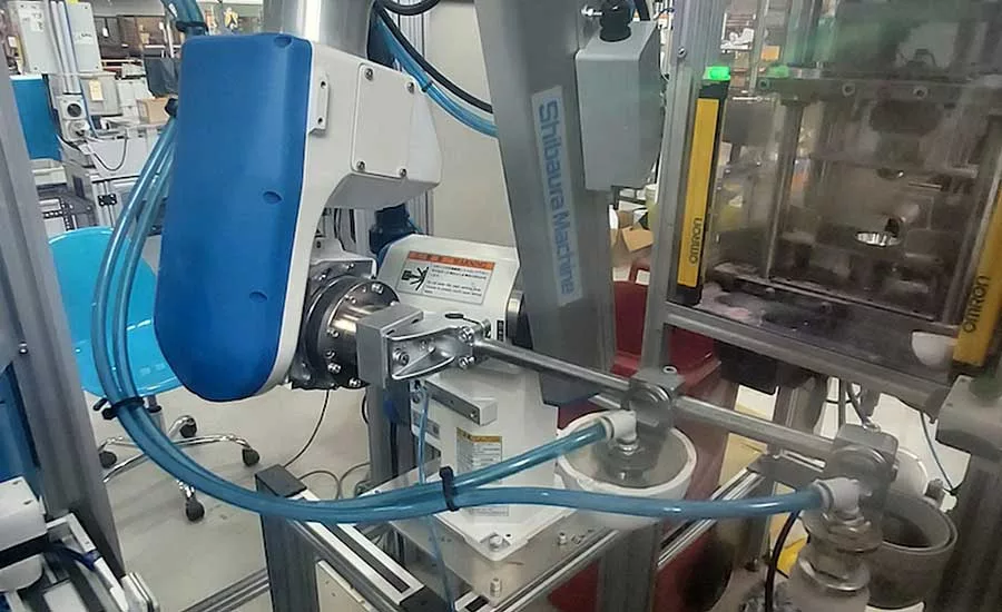

This six-axis robots loads and unloads leather ball covers from a trimming machine. Photo courtesy TM Robotics

To automate this process, M.A.P engineers suggested using a robot and an automated tray handling system to load and unload the trimmer. Full trays of covers are placed into the handling system, which automatically supplies the trays to a TVL 700 six-axis robot, which loads and unloads the trimming machine. With this setup, only one worker is needed to load a set of trays every 20 to 25 minutes.
M.A.P designed an automatic racking system, in which six trays carrying 80 to 90 covers are placed onto a conveyor. Because the covers are scattered on the trays in random locations, a vision system is required to ensure that the robot can accurately decipher where each cover is and how to pick it up.
The vision system uses high-speed cameras to continuously capture 3D images of the covers. Using intelligent software, the system can process these images and identify the exact position of each cover. The system then determines the most logical order to pick up each cover and with submillimeter accuracy.
M.A.P engineers suggested the TVL 700 robot for this application due to its high speed and articulated movement. These features ensure easy changes of direction, without limiting the range of motion.
