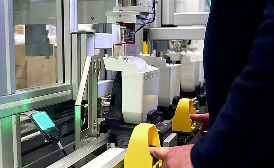

At this station, a press installs a clip into the cartridge housing. The press measures the force applied with reference to the distance travelled by the ram to ensure the waste bag has been loaded and fitted correctly. Photo courtesy RNA Automation Ltd.

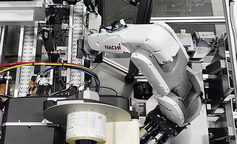

In RNA’s cartridge assembly system, robots handle some tasks, while people handle others. Photo courtesy RNA Automation Ltd.

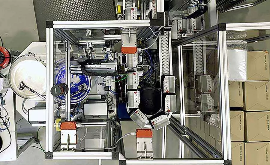

The pallet-transfer conveyor is a recirculating loop. Various mechanisms ensure that the pallets are precisely located at each assembly station. Photo courtesy RNA Automation Ltd.

At the start of the line, an operator loads cartridge bases through a poke-yoke aperture onto a two-lane declined conveyor. The cartridge bases are taken down a track to a stop, where they are picked and placed into a nest on a pallet-transfer conveyor. The vertical axis of the pick-and-place unit is pneumatic actuator, while the horizontal axis is a servo-driven actuator.The pallet-transfer conveyor is a recirculating loop. Various mechanisms ensure that the pallets are precisely located at each assembly station.
At the start of the line, an operator loads cartridge bases through a poke-yoke aperture onto a two-lane declined conveyor. The cartridge bases are taken down a track to a stop, where they are picked and placed into a nest on a pallet-transfer conveyor. The vertical axis of the pick-and-place unit is pneumatic actuator, while the horizontal axis is a servo-driven actuator. The pallet-transfer conveyor is a recirculating loop. Various mechanisms ensure that the pallets are precisely located at each assembly station.

An operator manually loads and fits a waste bag before pressing a two-finger start, which enables a press to extend and push a clip into the cartridge housing. The press measures the force applied with reference to the distance travelled by the press to ensure the waste bag has been loaded and fitted correctly.

At the next station, lids are loaded by an operator into one of two magazine drawers. The magazines can be topped up independently. The magazine, once returned within the cell, is picked from the top of the stack by a six-axis robot and placed into a datum station. Once the lid is accurately located it is picked again by the robot and assembled to the cartridge base. Once fitted, a presence check for lid ‘tabs’ is completed.
Assembled cartridges arrive underneath a label applicator, where a label is printed and applied to the cartridge. The sides of the label are wiped down, and then a vision sensor performs an OCR check and a test scan to check the bar code.
