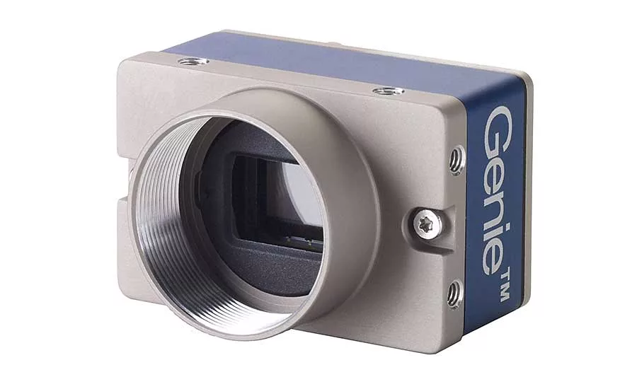

The Genie Nano M4020 camera offers a resolution of 4,112 by 3,008 pixels and image capture rates of up to 20 frames per second. Photo courtesy Teledyne DALSA

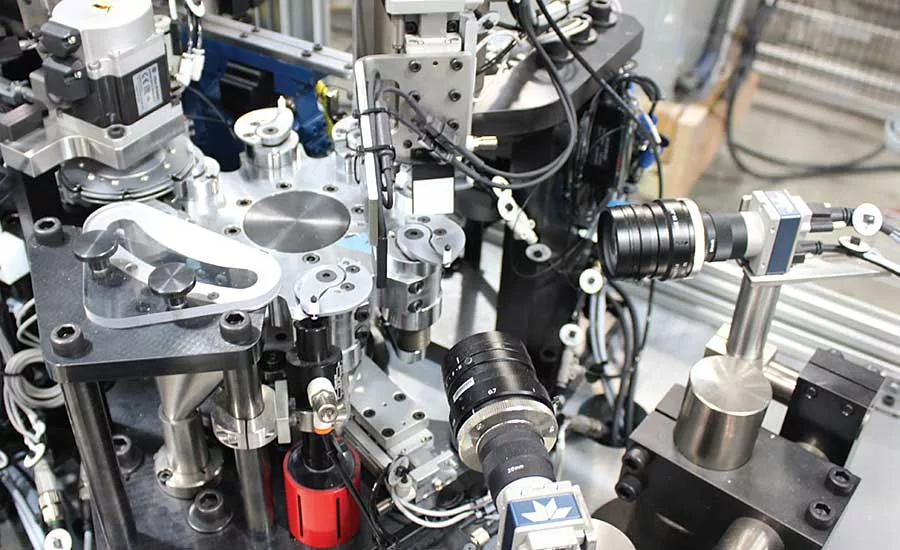

The main dial rotates so that each valve is moved in view of two vision cameras, which check the assembly for height, alignment, concentricity and run-out. Photo courtesy Teledyne DALSA

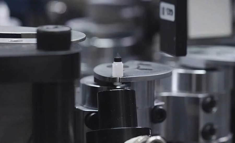

One Matrix customer produces valve assemblies designed to regulate the flow of gasoline into a carburetor. The assembly consists of two parts: a valve body, which the manufacturer produces, and a specialized rubber tip designed to withstand contact with fuel, which is produced by a third party.

“Our goal was to design a comprehensive system that seamlessly combined assembly with inspection,” explains Pascal Agneray, the Matrix mechanical engineer who conceptualized the system. “In the automated system we built, valve bodies move along a gravity track to a small, servo-driven dial, which feeds them onto a larger, eight-station main dial. On this dial, each valve body is held in place by a set of cam-operated jaws. The rubber tips move in a similar manner to a second servo-driven, singulating mechanism that grabs each tip, then pushes and rotates it onto the top of the valve body.
“The main dial operates in a fast indexing motion via reducer and servomotor setup, so once each valve body and rubber tip is assembled, it moves in view of two cameras, which capture images of the assembly to be analyzed for height, alignment, concentricity and run-out. The entire cycle takes just 1.5 seconds with tens of thousands of parts assembled and inspected each day.”

The inspection system incorporates two Teledyne DALSA Genie Nano M4020 cameras that offer a resolution of 4,112 by 3,008 pixels and image capture rates of up to 20 frames per second. With a small form factor that allows them to be placed even in confined spaces, the two cameras are positioned at right angles to allow for images of the valve assembly from two sides.
As each object crosses the field of view, the cameras are triggered automatically. Embedded iNspect Express software assesses each image to ensure that all measurements meet critical dimension standards and are within a tolerance of 0.08 millimeter. At the same time, the software analyzes each image for irregularities in the assembly itself, such as deformities in the valve or rubber tip, which may have occurred in earlier phases of production.
Statistical inspection data is sent through an interface to the PLC. After the main dial rotates past the cameras, assembled parts that pass inspection are sent down a chute to a container. Any parts that don’t meet customer standards are ejected through a vacuum and discarded.
“We chose Teledyne DALSA’s Genie Nano camera because it provides the high frame rates and resolution needed for this application,” Agneray continues. “With a tight tolerance of 0.08 millimeter, we wanted high resolution and superior image quality to ensure the greatest possible accuracy, and the Genie Nano delivers a 9 megapixel resolution, far better than the 3 megapixels offered by a competitive system.”
