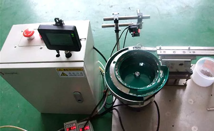

This bowl feeder supplies pins to an automated assembly system at a rate of 30 parts per minute. Photo courtesy Suzhou Huilide Machine Co. Ltd.

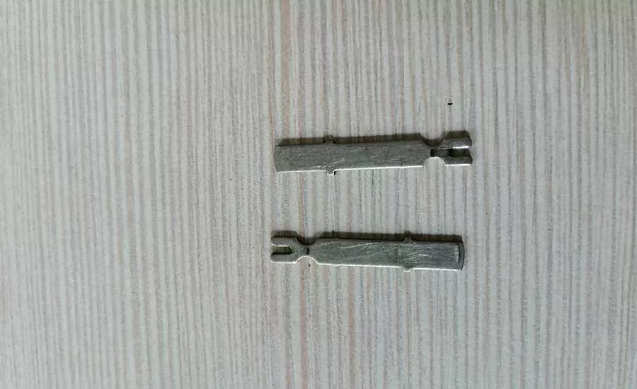

These pins are difficult to feed. Both ends are the same width, but one end is U-shaped while the other is rectangular. Photo courtesy Suzhou Huilide Machine Co. Ltd.

A customer needed to feed flat pins to an automated assembly system at a rate of 30 parts per minute. The pins were difficult to feed because of their shape. The pin has two ends. Both ends are the same thickness and width, but one end is U-shaped while the other is rectangular. That made it difficult to sort with conventional mechanical methods.
To solve the problem, Huilide engineers designed a vibratory feeder bowl. Fabricated from 201 stainless steel, the bowl is 330 millimeters wide and the drive is 250 millimeters wide.
A vision system inspects the pins as they reach the top of the bowl. When a pin passes a certain point, a sensor triggers the camera to take a picture of the pin. The camera then compares the picture with an image of a correctly oriented pin stored in memory. If the pin is positioned correctly, it exits the bowl feeder. If it is wrong, the part will reject and return to the bowl.
After testing, the bowl met the required feed rate.
