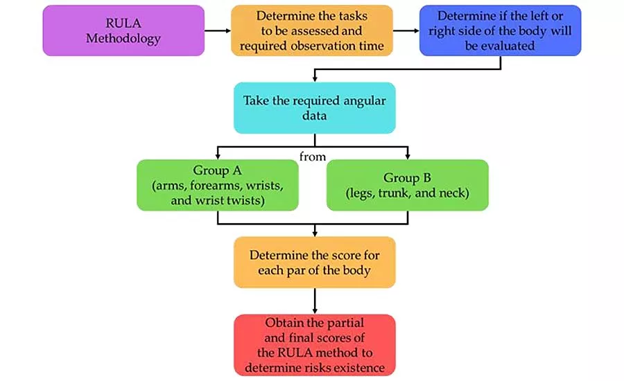

RULA helps identify the risk factors associated with high postural loads. Illustration courtesy Tecnológico de Monterrey

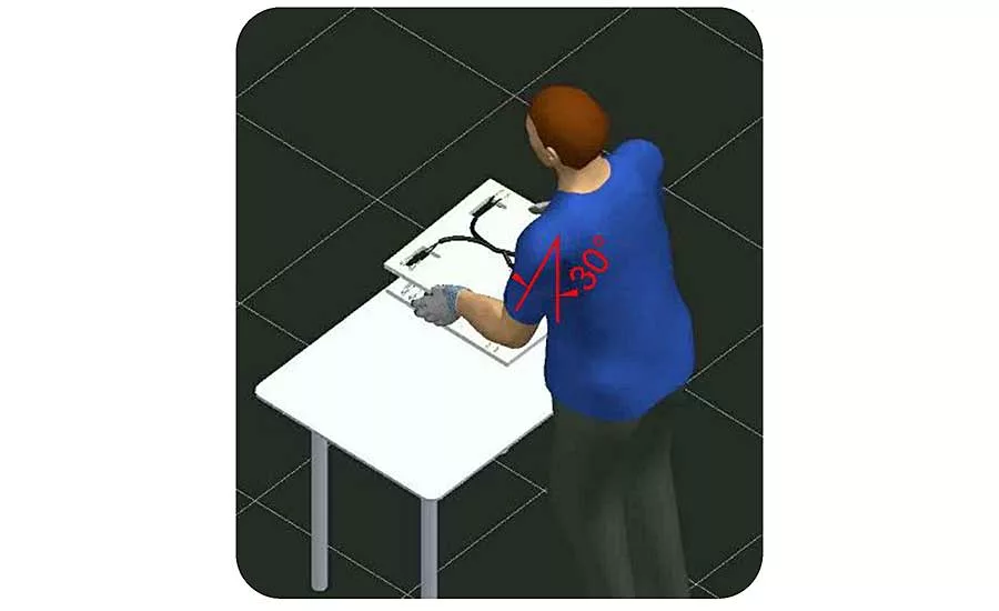

Among other variables, RULA measures the angle of arm positions during an assembly task. Photo courtesy Tecnológico de Monterrey

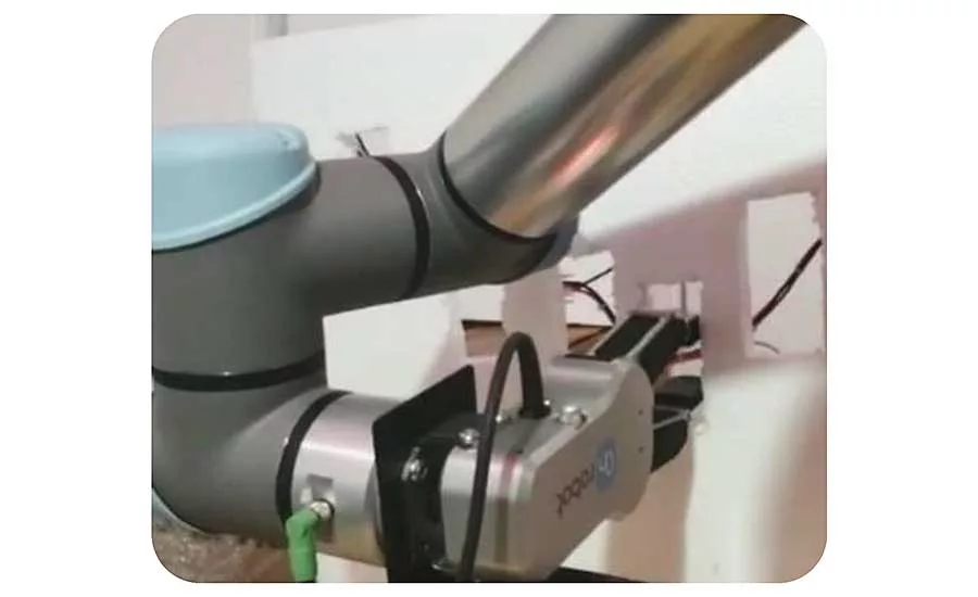

For a real-world application, engineers will need to develop a specialized end-effector for installing cable ties. Photo courtesy Tecnológico de Monterrey

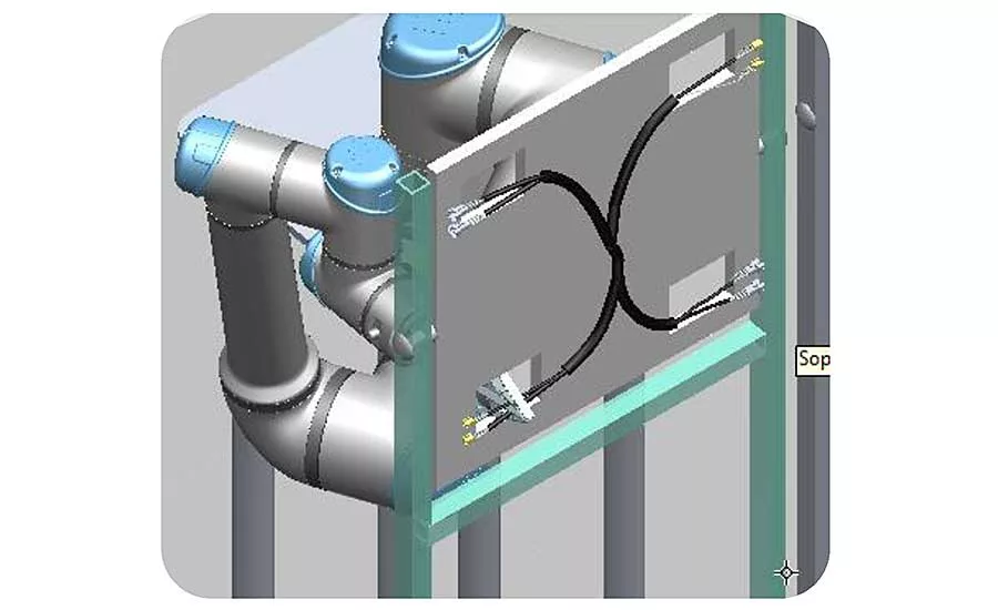

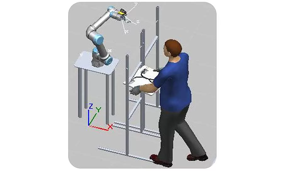

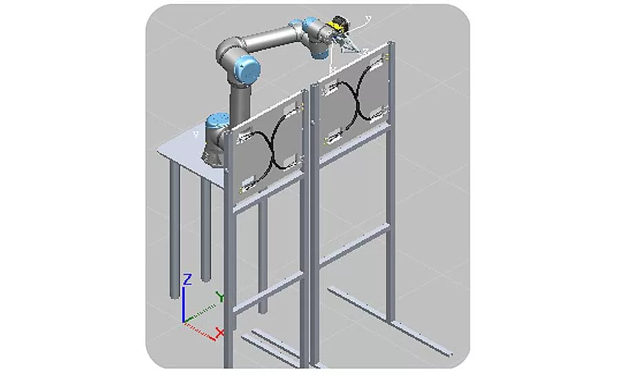

The researchers designed a workstation with a cobot at the back of the assembly board. This arrangement eliminates the risk of collision between the worker and the cobot. It also allows completion of two boards simultaneously. Photo courtesy Tecnológico de Monterrey

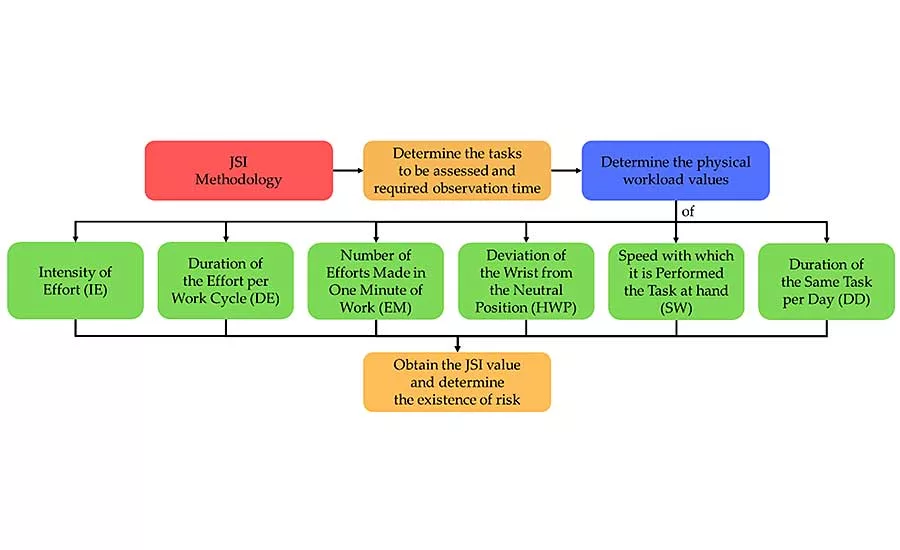

The JSI complements RULA, considering additional factors such as time and speed. It can predict whether workers will develop injuries due to repetitive motion of their upper limbs. Illustration courtesy Tecnológico de Monterrey

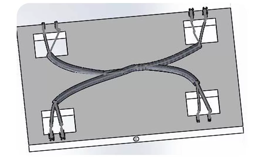

The researchers’ experimental wire harness required four cable ties to be installed in opposite corners. Photo courtesy Tecnológico de Monterrey

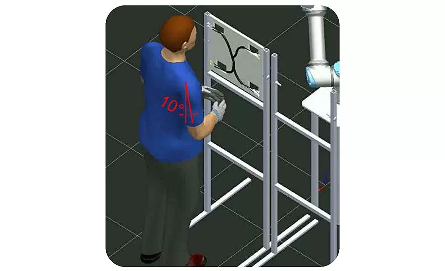

An assembler loads a harness assembly board onto the workstation. Photo courtesy Tecnológico de Monterrey
A cobot installs a cable tie onto a harness. Photo courtesy Tecnológico de Monterrey
RULA and JSI scores show that the human-robot collaborative process is more ergonomic than a purely manual one. Photo courtesy Tecnológico de Monterrey

Our study uses two methodologies to evaluate the ergonomics of a harness assembly task: the Rapid Upper Limb Assessment (RULA) and Job Strain Index (JSI). RULA is a robust ergonomics evaluation method. It measures all upper body limb angles and considers other factors, such as muscular activity and applied forces. The JSI complements RULA, considering additional factors such as time and speed. Moreover, the JSI can predict whether workers will develop injuries due to repetitive motion of their upper limbs.
RULA helps identify the risk factors associated with high postural loads. It also recognizes ergonomic problems due to excessive postural load on the upper limbs of a worker. RULA provides a score that determines if the work postures are acceptable or require changes, or even a complete redesign of the task.
RULA only evaluates individual postures and not a sequence of postures in a job routine, so it’s necessary to determine which postures should be considered. First, it has to be specified which postures will be evaluated. These are selected by looking at those tasks with a more significant postural load based on their duration, frequency and deviation from the neutral position.
Postural load measurements are completed by calculating the angles of different body parts with their determined reference. The tool RULER from the Ergonautas Research Group of the Polytechnic University of Valencia conducts these angle evaluations using photographs.
To calculate the RULA score, the body is divided into two groups: Group A consists of arms, forearms, wrists and wrist twists. Group B consists of legs, trunk, and neck. A RULA score is assigned to each body part using scoring tables. Then, general values are calculated for each group using the scores of each body part.
The musculoskeletal injury risk is determined with levels from 1 to 4. The final scores of each group are adapted according to muscular activity and the forces applied in the task. With these scores, the final values are calculated. “1” is an acceptable posture, and “4” shows that a change is urgently required.
In a complementary way, the JSI evaluates whether a worker could develop repetitive motion injuries in his upper extremities due to work activities. The JSI measures six physical workload variables: the intensity of effort (IE), the duration of the effort per work cycle (DE), the number of efforts made in one minute of work (EM), the deviation of the wrist from the neutral position (HWP), the speed with which the task is performed the task (SW), and the duration of the task per day (DD).
The final JSI score is calculated by multiplying the variables: IE x DE x EM x HWP x SW x DD.
If the JSI is less than or equal to 3, it indicates that the task is probably safe. A JSI greater than or equal to 7 indicates that the task is likely dangerous. Scores higher than 5 are associated with musculoskeletal disorders of the upper extremities.

The RULA and JSI scores for installing cable ties indicate that the task is ergonomically risky.
After measuring the angles of various body parts during installation, the values of Groups A and B were calculated. The value for Group A was 5 and the value for Group B was 8, for a final RULA score of 7.
For the JSI, we obtained the following values: IE = 1, DE = 2, EM = 3, HWP = 2, SW = 1, and DD = 1. The JSI is therefore 1 x 2 x 3 x 2 x 1 x 1 = 12.
Next, we designed a workstation with a cobot at the back of the assembly board. For our design, we needed to make some holes in the assembly boards so the cobot could install the ties from behind. This arrangement eliminates the risk of collision between the worker and the cobot, since they do not work side by side. It also allows completion of two boards simultaneously. While the assembler is working on Board 1, the cobot can be working on Board 2, and vice-versa.
Our experimental process worked as follows: First, the assembler places the harness onto the assembly board. Next, the camera photographs the board to identify the number and positions of the holes and sends this data to the cobot. Then, the cobot will install a cable tie one by one at each hole position. Meanwhile, the worker places the other wire harness into the second assembly board. Lastly, the cobot installs the cable ties in the second board before going to a waiting position to repeat the task.
The interaction between the cobot and the worker is sequential, because they perform their assembly tasks independently and in sequence. They work on the same wire harnesses, but at different moments.

Our project is a functional prototype of a human-robot collaborative workstation for cable tie installation. For real-world operation, a specialized end-effector for cable tie installation would need to be developed.
To program our system, the first step was to teach the camera to identify the holes in the harness board. The camera software can only transmit the position of each hole one by one, rather than as a group. As a result, it was necessary to use Modbus communication to send the number of holes found by the camera to the cobot.
The cobot program for installing the cable ties was designed in Polyscope, Universal’s programming software. The program works for two different harness assembly boards.
Finally, we did an ergonomic analysis of the new cable tie installation process using RULA and JSI. After measuring the angles of various body parts, the values of Groups A and B were calculated according to RULA. The value for Group A was 3, and the value for Group B was 4, resulting in a final score of 4. This score is significantly lower than the original manual operation.
Similarly, the JSI for the automated station was 4.5, which is lower than the risk level for the manual operation.

Our biggest technical problem was related to programming the vision system. The camera could not work on the Z axis of the workspace of the workbench; this was from the Cartesian coordinate system perspective of the cobot. This is why the calibration process had to be carried out in the X-Y plane of the cobot. To correct this issue, it was necessary to generate two planes in the cobot program code and transform the coordinates that are in the X-Y plane to the Y-Z plane.
