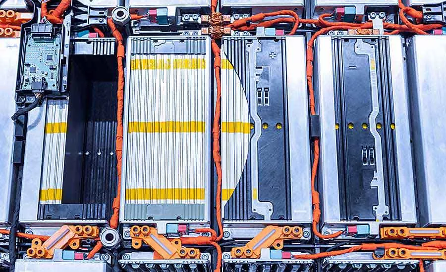

The need to extend the range of electric vehicles is pushing automakers to adopt higher battery voltages. Most passenger EVs are powered by a 400-volt battery pack, while electric buses and trucks are powered by 600-volt battery packs. Now, OEMs are starting to adopt 800-volt battery packs for passenger vehicles.
An EV battery pack consists of many individual cells connected in series. Each cell supplies 3.1 to 4.2 volts. A nominal 800-volt system contains approximately 198 cells in series, giving an overall pack voltage of 610 to 835 volts. In contrast, a lead-acid battery for a gas-powered car contains six cells in series, for an overall voltage of 12 volts.

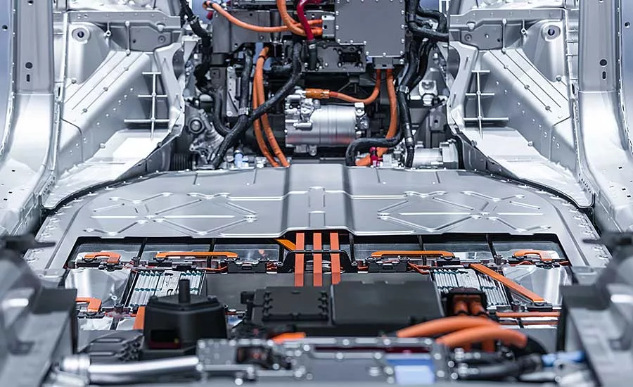

Up to 33 battery packs—each slightly larger than a shoe box, but significantly heavier—are individually inserted into welded aluminum car bodies. This is done by a robot at a fully automated workstation. Each pack is then fixed with four screws. Since speed and quality are critical, the screws are installed by a fully automatic system designed by Desoutter.
Four connected screwdriving spindles install the screws simultaneously, applying up to 20 newton-meters of torque. The screws are automatically fed from a hopper by a step feeder and blown through a hose to each spindle. When they arrive at the component, they are then automatically set at the same time and tightened synchronously to reach the final torque.

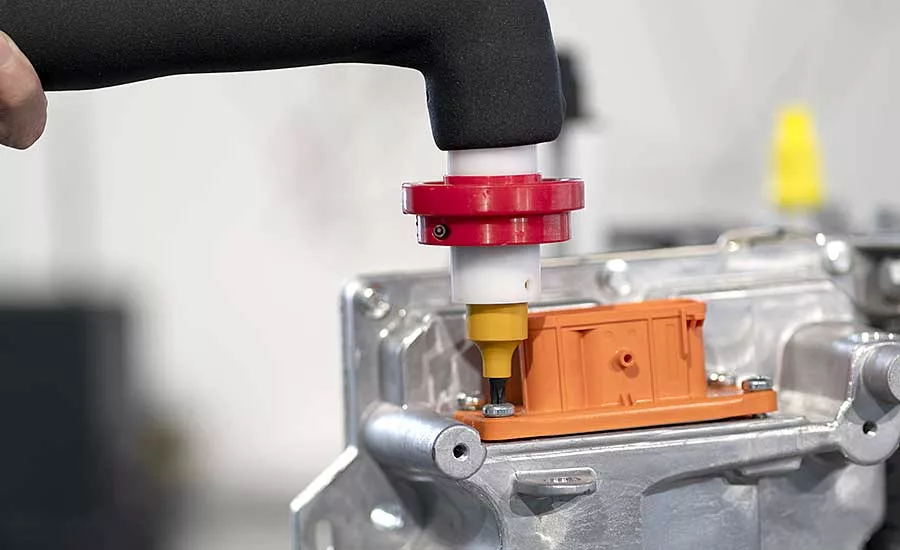

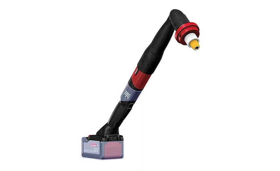

Rework of the battery connections and manual assembly of bus bars are carried out with Desoutter corded angle screwdrivers. “To protect workers, we use galvanically isolated screw chucks,” explains Wien. “The metal surfaces of the screwdrivers are also given a plastic coating. Because if the worker puts an uninsulated screwdriver on the component, it might bridge two poles and cause a short circuit. To prevent this, everything that conducts electricity is covered.”

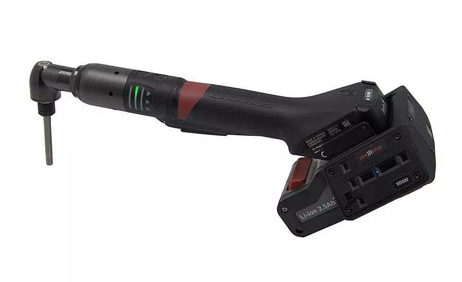

In addition to occupational safety, quality assurance at the rework stations is a major issue. Nexonar positioning technology from Desoutter helps. The system uses infrared technology to identify exactly where the fastening tool is in space. The only requirement is visual contact between a specially equipped camera and an infrared tracker on the tool. The tracker emits an unmistakable LED signal that is recognized by the camera.
The system’s software stores the spatial coordinates of the station, so it can determine the position of the tracker in relation to the fastening locations at the moment of assembly. Reference trackers attached to the component also transmit its exact position. The software then ensures that the worker can only use the screwdriver at the desired fastening location. In addition, the software guides the employee through the assembly process step by step, increasing efficiency and preventing errors. The software also documents the position of each part during assembly, providing full traceability.

Another tracker is permanently installed on each of the three screwdrivers, which is used to determine the precise position of the tool. This is supplied with power via the eLink system from Desoutter. The reference trackers on the workpiece are equipped with an 18-volt battery that ensures a running time of three to four weeks per charging cycle. The positioning is completed by Desoutter’s Assembly-Scout software and a stand-alone controller that manages the cameras independently of the customer’s system.
