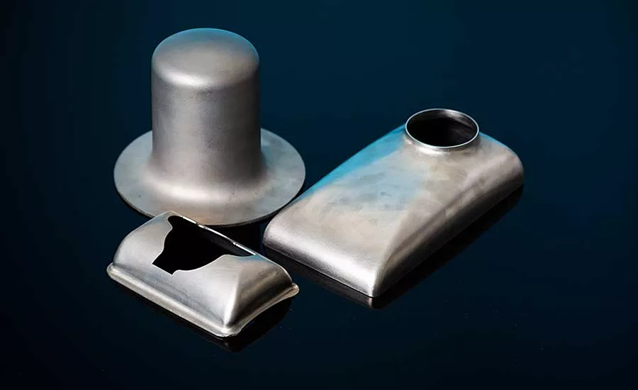

Hot forming was used to create these titanium aerospace components. Photo courtesy MSM Aerospace Fabricators

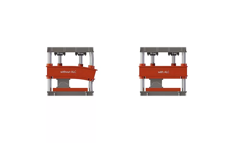

The intense heat generated by hot forming often causes die warpage. To counteract this effect, Beckwood has developed active leveling control (ALC) technology. Using a closed-loop monitoring system, ALC maintains bed-to-ram parallelism of ±0.004 inch. Photo courtesy Beckwood Corp.

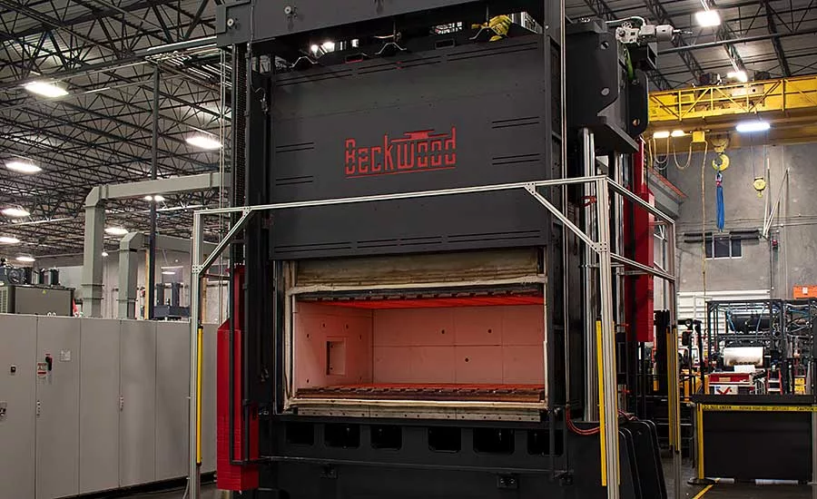

Beckwood built this 400-ton hydraulic hot forming press for a major supplier of titanium aerospace structural components. The press features 48 by 96 inch platens capable of reaching temperatures up to 1,800 F. Photo courtesy Beckwood Corp.

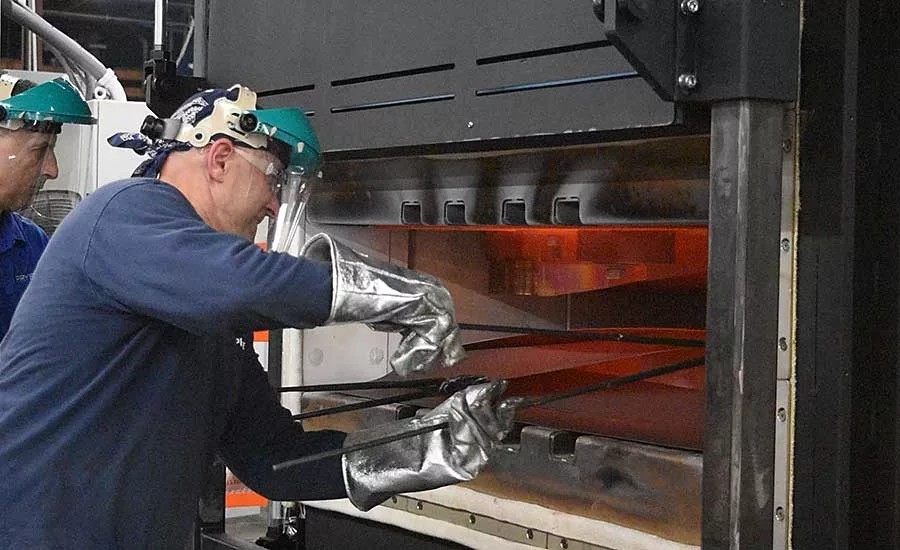

Automated insulated door systems contain heat within the forming chamber while allowing access for loading and unloading parts. Operators need personal protective equipment, including heat-resistant gloves, arm coverings and eye shields. Photo courtesy Beckwood Corp.

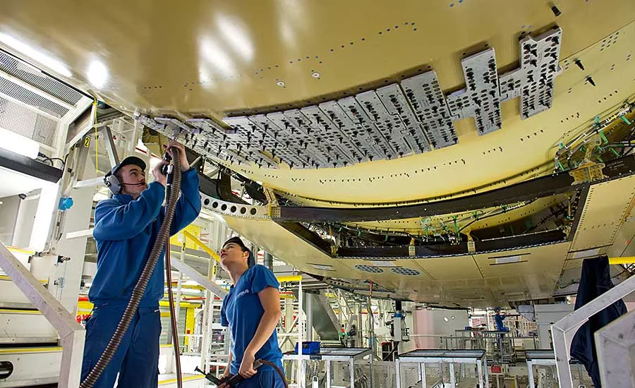

Approximately two-thirds of all the titanium produced each year is used in aircraft engines and frames. Photo courtesy Airbus
The finished parts are not soft. Typically, engineers do not need to worry about imprinting material handling features onto the part when removing it from the press. Because the change in temperature between the machine and the plant floor is so significant, the part cools to a non-soft state almost immediately when the door opens.

The machines are equipped with multizone electric cartridge heaters installed in gun-drilled passages. Embedded thermocouples provide temperature feedback and measure atmospheric temperature, and thermocouple receptacles can be used to measure and record tool temperatures. This controls temperature to within ±10 F and enables engineers to program temperature off-sets across the length and width of the platen.
Special components and materials are needed to handle the extreme temperatures inherent to these processes. Platens are fabricated from ceramics, stainless steel or other exotic metal alloys, depending on the application requirements.
Platen boxes have ceramic insulation and are isolated from the press frame with a thermal break consisting of water-chilled platens and a closed-loop chiller. This resists premature cracking and provides for long-term reliability.
Heat control is critical in hot forming, since it affects system efficiency and operating costs. Radiant heat is managed via heat shields. Air-conditioning units cool electrical panels, and thermocouples monitor operating conditions in critical areas. Heater life can be monitored via individual current monitors or by groups.

The intense heat generated by hot forming and SPF often causes die warpage. To counteract this effect and protect the structure of each press, Beckwood has developed active leveling control (ALC) technology. Using a closed-loop monitoring system, ALC maintains bed-to-ram parallelism of ±0.004 inch throughout the cycle despite off-center loading or die warpage.
