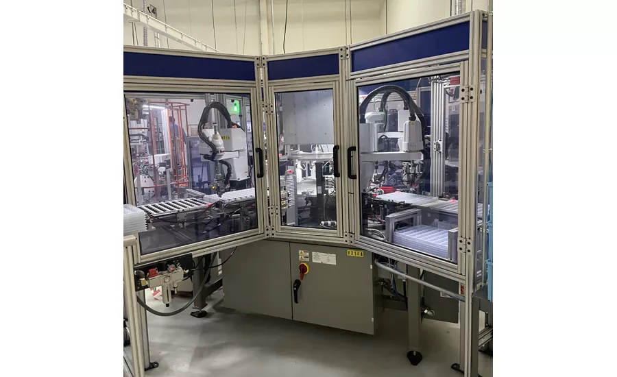

Today, Delta Systems uses more than 20 Epson robots for pick and place, assembly, dispensing and soldering operations. The company has also integrated an Epson IntelliFlex parts feeding system to move parts into a system that assembles key switches for lawn tractors, producing almost 2 million switches each year.

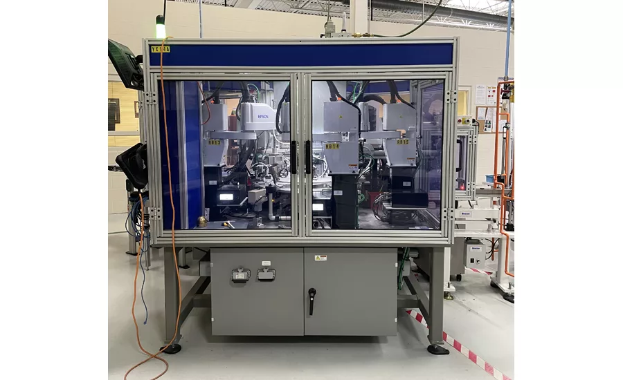

To assemble these meters, Delta employs two Epson T6 SCARA robots to pick and place parts and three more to solder them together.

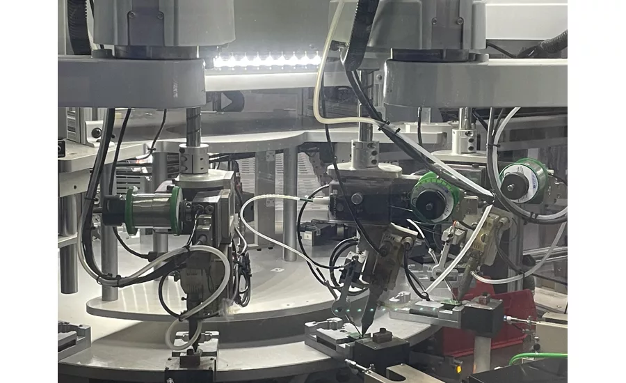

“One T6 robot places the parts onto a large dial, which rotates them over to the soldering robots. All three robots work on solder joints at the same time,” says McArthur.
Next, another T6 robot removes the finished assembly from the dial. Depending on the being assembled, each robot may create three or four solder joints on a board.
The challenge in this operation is speed and precision, with the robots working together to complete 750,000 meters per year, with at least 2.25 million solder joints.

Yet he felt that, with the company’s industrial automation experience, it would be better off building its own system. It took about six months for the engineering team to design and fabricate the new soldering setup, with about one week devoted to installing and programming the new robots, each with a commercially available soldering head.
“The most difficult part of the process was to get the different parts to communicate,” McArthur says. “And when I say difficult, that was mainly because we had never done it before.”
While the Epson robots began talking to the soldering heads immediately, the “handshake” was challenging because the soldering system uses proprietary communications protocols. “We worked with Epson on the issue, and I have to say its support is every bit as good as its equipment,” says McArthur.
In the end, merging the Epson robots with the soldering heads in-house saved Delta Systems about half the price of an off-the-shelf soldering system. “Typically, we save at least 35 percent when we integrate an automation system ourselves, but in this case it was more like 50 percent,” says McArthur.
There were additional savings as well. One common difficulty with robotic soldering is the need to frequently adjust the movement of the robot, as the attached soldering tool changes shape with wear. “Over the course of a week, we might do 50,000 solders,” McArthur notes.
With the previous system, making the adjustment was complicated enough to require an automation engineer. If it was needed when an engineer was not available, say, on an overnight shift, then the operation would have to shut down.
To address the problem, the team purchased an Epson TP1 teach pendant, which makes it easy to teach the robot the various points it must navigate to perform its functions.
“With the teach pendant in hand, an operator can move the robot to a point, check the alignment, adjust it as needed and then save the adjusted point into the program,” says McArthur.
Not only are operators avoiding downtime with the teach pendant, but they’re able to save 10 to 15 percent of the cost of expensive soldering heads, because they’re using them longer with the simplified adjustments, McArthur points out.
