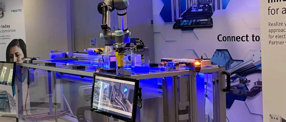

Multi-Axis Motion For Universal Robots
Festo Motion Control Package
The Festo Motion Control Package (FMCP-UR) is a complete motion control panel for up to four axes motion to complement the operation of a six-axis collaborative robot from Universal Robots (UR). The FMCP is fully integrated with UR’s cobot control panel and HMI and features an enhanced safety I/O handshake and communications interface.
The FMCP-UR can control turntables, gantry systems, conveyors, transfer tables, and any combination of linear and rotary servo axes up to the 10th axis.
Streamlined axis configuration allows for less engineering, integration and troubleshooting during setup and can be easily done through the UR HMI. The Multi-Axis Drive controller is a URCap software that allows engineers to set position, peed, and acceleration on the HMI or use the toolbar to jog the axes in manual mode to configure motion.
