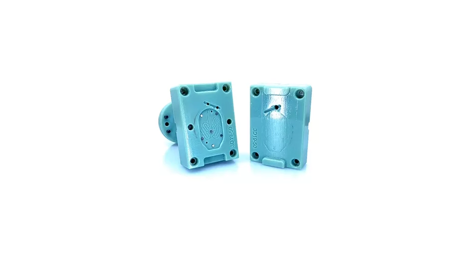

rosti 3d printed mold
Rosti can use 3D printing to create tooling for injection-molding prototype plastic parts. This is much faster and less expensive than creating metal molds.

ASSEMBLY: How has 3D printing affected your business?
Stillman: It’s had a huge impact. 3D printing can get designs from the screen into the designer’s hands quickly and cost-effectively.
However, that’s just the tip of the iceberg. We have learned from past experience that part designs do not always behave the same way when we transition from printed prototypes to molded parts. There are a number of reasons for this. The print material does not behave the same as the molded resin. The layering process results in anisotropic properties, which are not as homogeneous as molded parts. The molding process results in shrinkage and molding stresses in the parts.
That makes creating molds for prototype parts a gamble. It can take four weeks and tens of thousands of dollars to produce traditional molds for prototype parts. As a result, engineers must be confident in their designs before committing the time and resources to make molds.
That got us thinking: How could we get molded parts quicker and cheaper in the development phase? The answer was to print the mold, as well! It took a lot of development work, but we have perfected the process of 3D printing mold tooling. As a result, we can take a customer’s design from print to part in 72 hours. That includes design analysis, mold-flow analysis, part prototyping, tool prototyping and injection molding.
This is a critical success factor when engineers are trying to push design limits. We live in a world where if you are not progressing, you are going backwards. This process allows designers to “fail forward,” to iterate designs quickly and at a fraction of the traditional costs for molded parts.

Rosti’s Digital Innovation Laboratory used 3D printing to create prototype injection-molding tools, which allowed engineers to have prototype parts for the test within 72 hours. Production tooling—32-cavity molds—was ready just five weeks later, and the diagnostics company began serial manufacturing of the test under ISO-13485 conditions.
“Solving the problem of quick COVID diagnostics testing is one of our priorities at Rosti,” says Karl Stillman, regional sales director at Rosti Group. “We are delighted that our 72-hour 3D printing capabilities made it possible for our customer to produce test kits quickly and cost effectively.”
