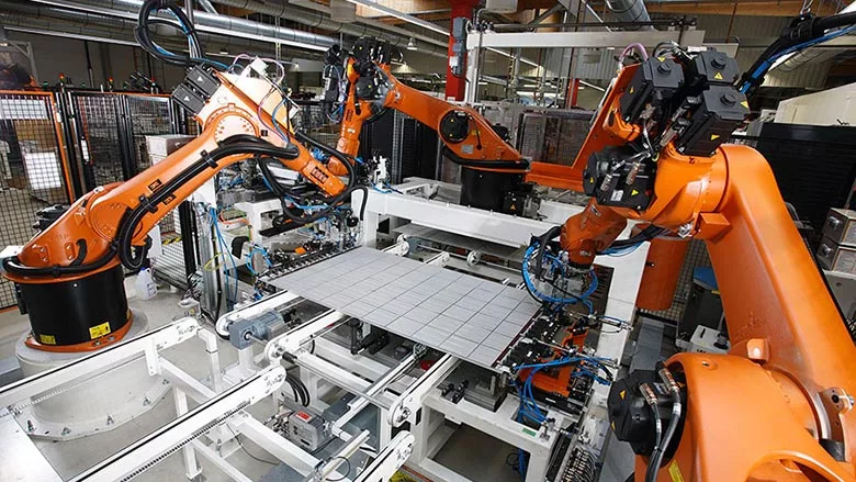

Six-axis robots are ideal for soldering large parts, such as solar panels. Photo courtesy Kuka Robotics Corp.
