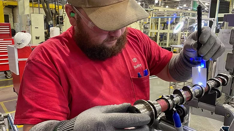

A key component of any engine is the camshaft, which must be machined to very tight tolerances to function properly. If the camshaft’s lobes aren’t spot on, it can result in unacceptable chatter noise when the completed engine is powered up. At that point, the only way to fix the problem is to shut down the production line, deconstruct the affected engines and replace the faulty camshafts.
“Just one failed test can cause a quarter of production—or about 135 engines—to be placed on hold,” says Cheryl Rollins, team leader in quality control at the plant. “That almost always requires scheduling weekend work to fix the problem.”
To prevent that from happening, Rollins and her team set out to come up with a way to identify cam chatter earlier in the production process.
The Kaizen
By applying Toyota Production System principles, the team drilled down to the root cause of the problem and came up with an elegant and affordable camshaft chatter checker tool. It’s comprised of an LED stream light, a small white board, and a bit of nylon to hold it all together at the required angles. The worker conducting the inspection simply aligns the tool with the camshaft, turns on the LED and examines the pattern that appears on the whiteboard when the light reflects off a specific lobe.
tool for inspecting camshafts
Engineers at Toyota have invented an elegant and affordable tool for inspecting camshafts. It’s comprised of an LED stream light, a small white board, and a bit of nylon to hold it all together at the required angles. Photo courtesy Toyota Motor Corp.
If all is well, the light will bounce off the lobe and onto the white board in one continuous flood of light. But if there are imperfections in the machined surface, a radial pattern of shadows will appear on the board—what the team refers to as “fanning.” The more prominent the shadows, the more significant the flaws. And, in turn, the louder the resulting engine noise if that camshaft were to find its way into production.
Workers don’t check every camshaft, only a representative sample. But since the checker has been put into use, the plant hasn’t had a single shutdown requiring extra work shifts due to this problem. All of the flawed components have been identified and replaced earlier in the production process.
