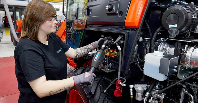

ground screw on the engine main switch is tightened with a digital torque wrench

The ground screw on the engine main switch is tightened with a digital torque wrench. Here, the screw must be tightened to 8.8 to 11.8 newton-meters. Photo courtesy Desoutter Industrial Tools

Another interesting screw connection is the steering wheel nut on the wheel loader. This is tightened to 40 newton-meters (± 5 newton-meters) using a shorter Q-Shield torque wrench. The ground screw connection on the engine main switch, with which the battery can be disconnected, is also made with the torque wrench. Here, the screw must be tightened from 8.8 to 11.8 newton-meters. Both screw connections are safety-relevant, just like numerous hydraulic screw connections on construction machines.
