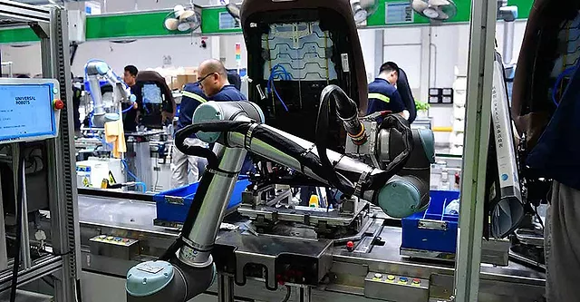

Automotive assembly lines will be a growing market for collaborative automation. Photo courtesy Universal Robots A/S

According to Hughes and other observers, automotive final assembly lines will be a growing market for collaborative automation in the near future.
One groundbreaking application involves Stellantis, which has equipped several assembly plants in Europe with cobots that perform various types of nutrunning and screwdriving applications. On one line building electric vehicles, six machines are mounted on a movable fixture. They’re used to automate several assembly tasks that are traditionally performed by humans.
