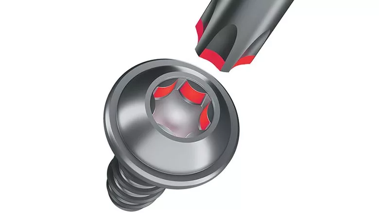

The design of the TOBI drive is based on a combination of large concave and small convex radii, resulting in a vertical wall recess whose six sides are gently curved until they intersect with the opposing wall in a relatively sharp, but radiused intersection.

Just such a recess is available: the TOBI drive. The TOBI drive is a lobular, vertical wall recess that is visually like other hexalobular designs. However, that is where the comparison ends. The design of the TOBI drive is based on a combination of large concave and small convex radii, resulting in a vertical wall recess whose six sides are gently curved until they intersect with the opposing wall in a relatively sharp, but radiused intersection. When paired with the mating driver bit, this configuration provides users with several important advantages: “bit stick,” improved bit-to-recess contact, bit strength and durability, and bit-to-recess alignment.

Bit stick refers to the capability of the recess-and-bit combination to securely hold the screw in a set orientation while it is presented for assembly. The most challenging presentation is when the screw must be retained on the bit as it is advanced horizontally or vertically into a workpiece without additional holders or constraints. Such presentations often occur when screws are either manually or robotically driven from the side or from below. In fact, the scenario presented in the introduction illustrates a challenging vertical presentation and an example of why some of the most successful construction screws have bit stick capability.
The TOBI drive achieves this bit stick capability by combining a unique recessed drive geometry in the screw with a specially designed tapered tip at the lead end of the bit. The result is a strong bit stick capability, making screws with this drive well-suited to unsupported screw assembly from any direction. It’s also ideal for installing screws made from stainless steel and other nonmagnetic materials. Like other recess drives that exhibit bit stick, a genuine TOBI drive must be paired with a genuine TOBI driver.

The gently radiused sides that comprise most of the recess profile allow for increased contact area with the mating bit both in radial profile and longitudinal depth. In fact, finite element analysis has shown that the resulting interface between the bit and the recess lobe walls imparts an even and low stress distribution over almost the entire contact area. This is a critical attribute, because with more engaged contact area than other lobular, vertical wall and cruciform recesses, the efficiency and potency with which it transmits torque is improved. Improved torque transmissibility is a strong function of a drive system’s ability to be driven or removed without damaging or “camming out of” the recess. It is also an important advantage when the recess is partially filled with paint or other contaminants.
