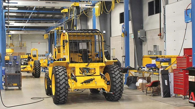

workstation crane
The assembly line is equipped with a 140-foot free-standing workstation crane with four aluminum bridges; two 2-ton cranes; and two 1-ton cranes. Photo courtesy Sellick Equipment Ltd.
Productivity has increased because workers are able to freely move the product down the 140-foot long, 20-foot wide assembly line without restrictions. This has opened up areas for part storage and has helped to smooth out the workflow processes for the assembly operators. During assembly, two speed hoists are used to position parts.
Assemblers at Sellick Equipment are pleased with the Gorbel systems’ ease of use under load. They are especially pleased that the load stays where it should with no drift or slide in the aluminum bridge to make precision part placement easier.
