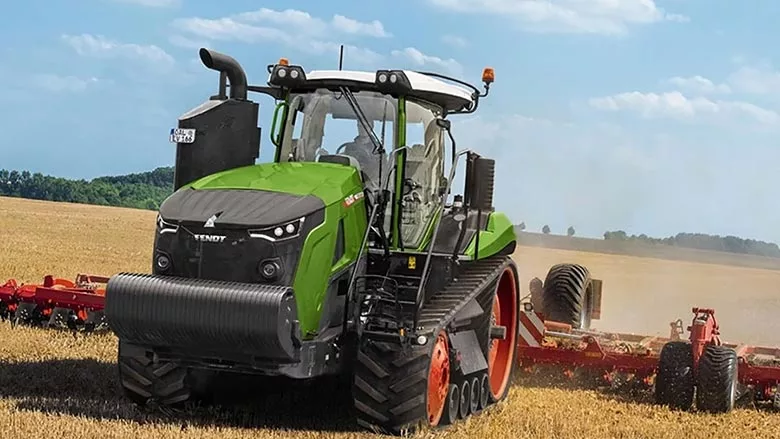

Fendt 1100 row crop tractor
AGCO’s factory in Jackson, MN, makes high-horsepower row crop tractors such as the Fendt 1100.
