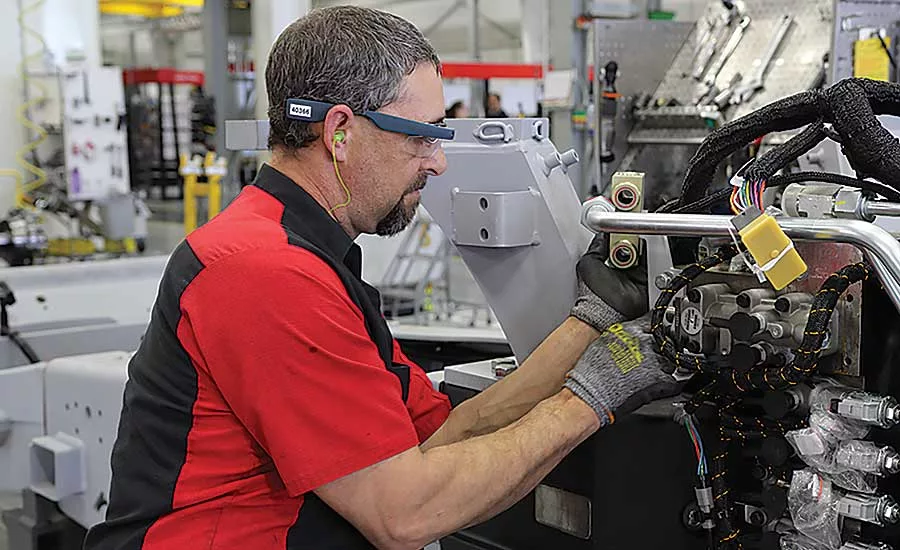

By investing in Google Glass technology, AGCO’s Jackson, MN, plant has seen over a 30 percent reduction in inspection times and a 25 percent reduction in production time. Photo courtesy AGCO Corp.

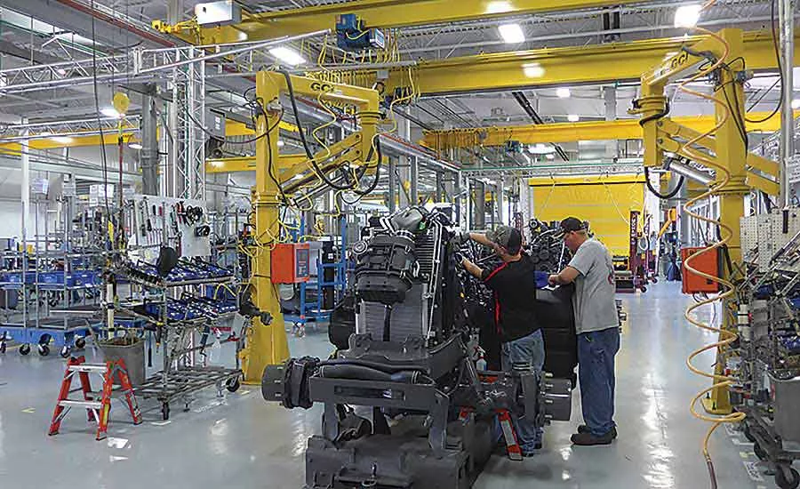

The tractor assembly line enables operators to easily switch back and forth between tracks (foreground) and tires (background). Photo by Austin Weber

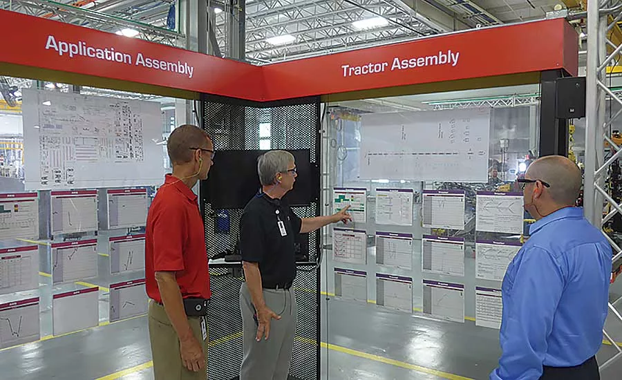

Every morning, the AGCO Jackson management team reviews key performance indicators, such as cost, delivery, quality and safety. Photo by Austin Weber

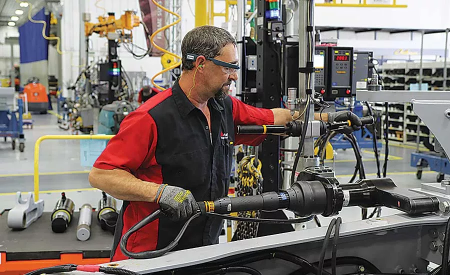

Assemblers use DC-electric fastening tools to attach all critical components. Photo courtesy AGCO Corp.

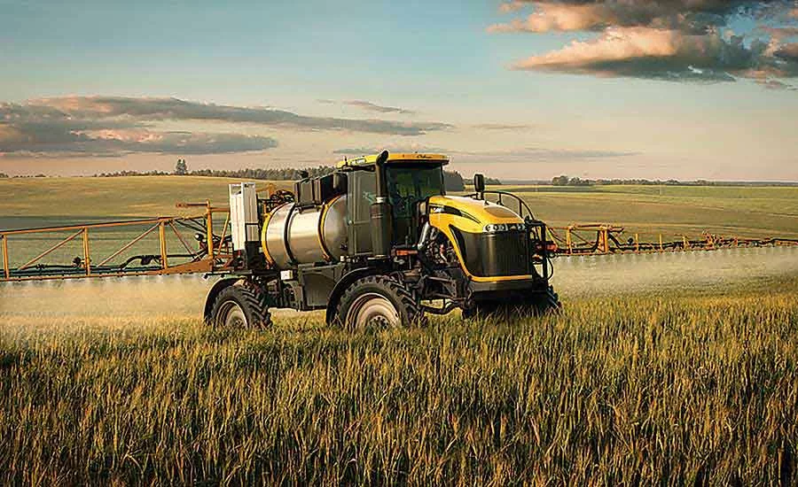

All products made at the 2017 Assembly Plant of the Year, such as this RoGator sprayer, are built to order. Photo by Austin Weber

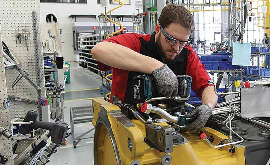

Assemblers use a wide variety of cordless fastening tools throughout the factory. Photo courtesy AGCO Corp.

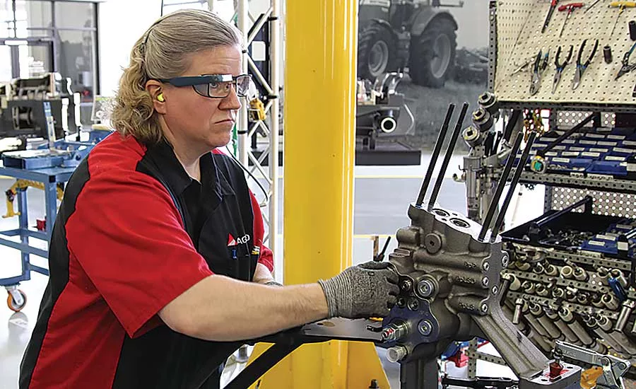

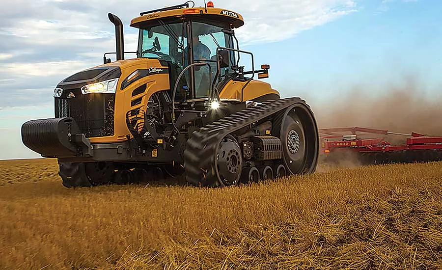

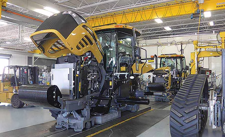

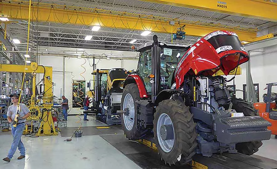

A wide variety of tractors are assembled at AGCO’s state-of-the-art factory in Jackson, MN. The facility is home to Challenger and Massey Ferguson high-horsepower wheeled row-crop tractors, as well as articulated and tracked Challengers.

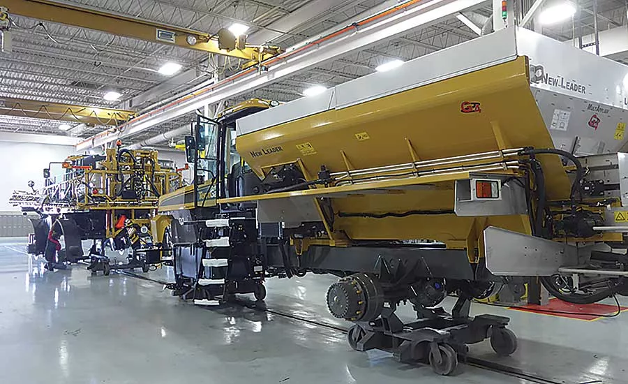

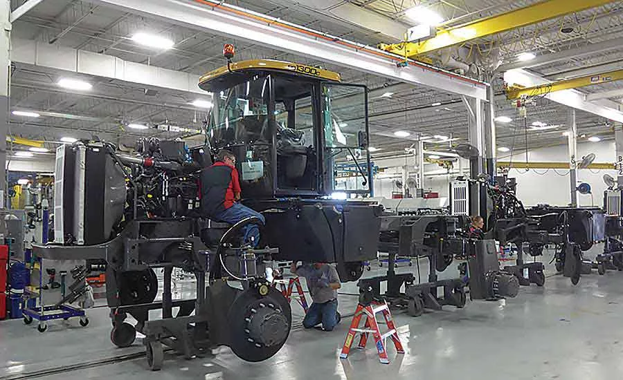

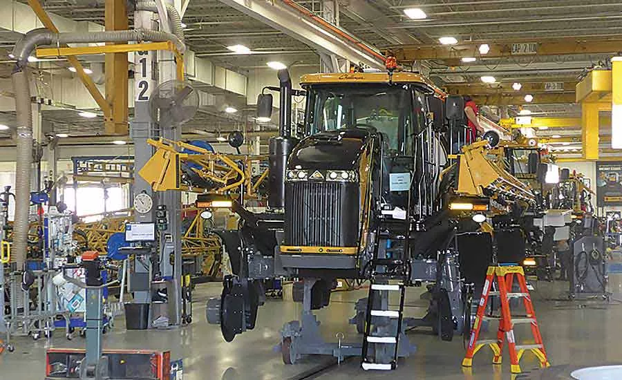

In addition to building multiple types of tractors, the flexible factory assembles three- and four-wheeled applicators. The self-propelled RoGator and TerraGator vehicles are used by growers to spread many types of dry fertilizer and liquid chemicals.
The 1-million-square-foot Jackson facility is the recipient of the 2017 Assembly Plant of the Year award sponsored by ASSEMBLY Magazine. The world-class plant was chosen for the 14th annual award because of the way it has applied cutting-edge technology to build complex products better, faster and more efficiently.
During the past five years, AGCO has invested more than $50 million in the Jackson factory to increase production capacity and efficiency. The 52-year-old plant embraces plant floor innovations ranging from automated guided carts to cordless screwdrivers.

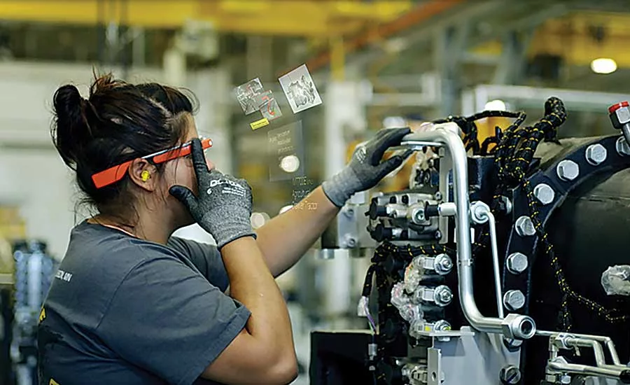

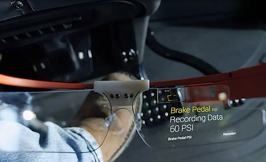

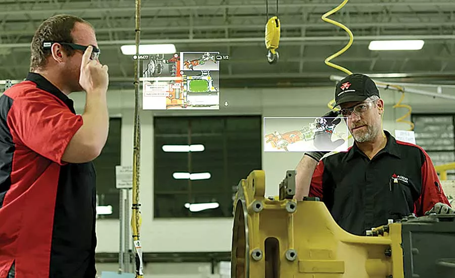

AGCO Jackson also recently launched a wearable technology initiative that uses augmented reality tools to enable assemblers to work more productively. More than 100 pairs of Google Glass are being worn by employees for quality inspections and assembly work. And, the plant has applied cutting-edge lean manufacturing principles to boost quality and drive continuous improvement efforts.
“As an industry built on technology, the Jackson plant has embraced innovation on the plant floor,” says Eric Fisher, director of operations. “We have led the world in Industry 4.0 and Internet of Things solutions.
“Farmers expect the best when they purchase AGCO equipment, and we intend to beat those expectations,” adds Fisher. “With the continuous improvements we’re making here, we provide our dealers and farmers the highest-quality agricultural equipment available.”

Previously, the Jackson facility was building Challenger MT700C and MT800C track tractors, as well as Challenger MT900C articulated four-wheel drive tractors, TerraGator and RoGator applicators and SpraCoupe self-propelled row-crop sprayers. Since then, several other products have been added to the manufacturing mix at the Jackson facility.
The expansion included a complete overhaul of the tractor assembly line, which now encompasses 16,000 square feet, including state-of-the-art testing equipment at the end of the line. Application equipment, the other half of the Jackson plant’s output, is assembled on a separate assembly line in a nearby building.

The newest product in the Challenger line is the MT700 track tractor. The next-generation machine features new styling, as well as a new engine, transmission, undercarriage and hydraulics that have been improved to provide a smoother ride for operators. It is equipped with continuously variable transmission technology, which was pioneered in the wheeled Challenger 1000 and modified for track use.
“This innovation allows the tractors to run in the maximum torque range, while delivering low fuel consumption to help increase productivity and reduce costs,” says Richard Kohnen, director of tactical management for application equipment and high-horsepower tractors. “The AccuDrive system allows full output at 1,700 rpm.
“Not only does this allow for the tractor to run in the peak torque range of 1,200 to 1,600 rpm, but it does so more efficiently with less engine wear,” adds Kohnen. “This system also results in a quieter working environment for the operator.”
Tracked machines, such as the MT700 Series, appeal to farmers because they provide a much smoother ride on rough surfaces. “They also reduce soil compaction,” explains Kohnen. “That’s important, because some soils are more prone to compaction than others.”
The other new Jackson-built product is the RoGator C Series self-propelled row crop applicator.
“With the prevalence of herbicide-resistant weeds throughout the country and the introduction of new herbicide systems to control these weeds, greater management and attention to detail will be needed for anyone applying herbicides,” says Kohnen. “The new machine is equipped with recirculation
plumbing and self-priming booms that keep product moving through the system to reduce chemical buildup and help eliminate plugged spray tips.”

AGCO Jackson’s assembly lines are extremely flexible so the plant can quickly respond to sudden downturns or spikes in demand. Challenger and Massey Ferguson tractors are built on the same assembly line with variable line speeds that ensure that the operators’ work load remains constant. RoGator and TerraGator applicators are also assembled on a mixed-model line in a nearby building.
All products built at the 2017 Assembly Plant of the Year are built to order. Dealer requests are electronically transmitted to the factory. Andon boards located throughout the plant include each dealer’s name and location so that assemblers know where each product is headed.
All products move down the assembly line attached to an in-floor towline conveyor that indexes forward. Sequenced kit carts are positioned on both the left and right side of the line to reduce operator movement.
The tractor assembly process starts with the power train and frame, which forms the core structure on all machines. Engines and transmissions are transported from the warehouse on automated guided vehicles and adjustable tugger carts, then lifted into place using overhead gantries and jib cranes.
Next, all hydraulic lines and electrical wiring harnesses are routed and attached. On a typical tractor, there are 30 to 40 different hydraulic lines alone. The tractor assembly line features an in-line paint system. The manual process takes approximately 40 minutes.
After a tractor emerges from the paint booth, assemblers attach the cab and various exterior components, such as hitches, hoods, radiators and tanks. Finally, either tires or tracks are attached to the machine.
The tractor assembly line enables operators to easily switch back and forth between tires and tracks. That’s because no two machines on the line are ever alike. For instance, the build sequence can call for a Challenger on wheels, followed by a Challenger on tracks and then a Massey Ferguson with a dual set of rear tires for extra traction. Factors such as track type, track width, track spacing and bogie wheels can also vary.
“Work content on the main assembly line is very similar,” says James Croxton, director of manufacturing. “However, there is more work involved in assembling track units. That added work is isolated and done in a subassembly area so the main line stays balanced to takt time.”
Other components, such as frame rails, pumps and valves are also built up on subassembly lines and moved to the final assembly line with tuggers. In addition, cabs are built in a separate area of the plant.

The application equipment assembly line operates similar to the tractor line. For instance, booms, tanks and hoppers are built up on subassembly lines.
“Tractors and applicators are basically produced the same way,” explains Croxton. “However, application equipment is more complex, because it has a system that gets integrated with the chassis. It’s like building a tractor with an implement on the same line.”
Fastening plays a critical role on both assembly lines. Assemblers use multiple sizes and configurations of screws, nuts and bolts.
“We use 1,800 different fasteners at the Jackson plant,” says Croxton. “The tractor assembly line has 819 individual torque tools in our calibration system, with 2,100 newton-meters being the highest torque value.”
Assemblers also use a wide variety of fastening tools throughout the factory, which has made a concerted effort to go cordless whenever possible.
“Battery-powered tools have proliferated throughout Jackson,” Croxton points out. “But, assemblers use DC-electric fastening tools to attach all critical components, such as marrying the engine to the chassis. We are currently transitioning to wireless torque tools that tie into torque management software.”

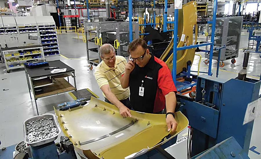

Quality Assurance
At the end of each assembly line, tractors and applicators undergo a rigorous two-hour series of tests. It’s part of AGCO’s end-of-line quality assurance process, which ensures that every machine is ready to hit the ground running after it’s delivered.
All products built in Jackson must pass five quality-assurance tests before being delivered to dealers and farmers. Each product coming off the line goes through quality-check gates to verify proper functioning of the hydraulic system, cab electronics, overall fit and finish, and tire or track width.
A jounce test rocks each machine side to side, mimicking a drive across a rough field. The speed and intensity of the rocking are varied throughout the test to simulate farming conditions from every day to extreme.
“All hoses, fittings and electrical connections are monitored throughout the test to verify there are no leaks or electrical issues,” says Croxton. “The lights, wipers and other switches are manually verified again after the test to ensure everything works correctly for new owners.”
A power take-off (PTO) dynamometer measures rated horsepower and torque output. PTO performance is checked at a variety of speed and load levels to ensure farmers get the productivity they expect.
Every machine must pass a chassis dynamometer test that verifies proper functioning of the steering, brakes and suspension system, as well as transmission shift quality and engine performance. Machines are held in place on a bed of rollers and run at various speeds and resistance levels to simulate conditions above and beyond what they are likely to encounter in the field.
And, before they leave the Jackson factory, all machines are also driven on an outdoor test track.

The 2017 Assembly Plant of the Year has applied a wide variety of technology on its plant floor to reduce errors, address quality and boost productivity—everything from ring scanners to tablet computers. Its latest initiative involves lightweight, optical, head-mounted displays.
Several years ago, AGCO Jackson was an early adopter of Google Glass wearable technology. Today, it’s one of a handful of manufacturers, including Boeing and General Electric, using the next-generation of the device, now officially called Glass Enterprise Edition. So far, the results have been impressive.
The ability to have access to instructions in quality, assembly and paint prep has led to reduced processing times, reduced defects and reduced training costs. AGCO has seen over a 30 percent reduction in inspection times, a 25 percent reduction in production time and the ability to train staff 300 percent faster.
AGCO refers to the technology as “informed reality.”
“It’s different than augmented reality or virtual reality,” explains Peggy Gulick, director of business process improvement. “The goal of virtual reality is to transport you, making you feel like you are in another physical space. Assisted reality keeps you in your present environment, but provides additional information to your line of sight.
Up until a few years ago, the Jackson factory was using tablet computers to conduct in-depth quality inspections at the end of the tractor assembly line. But, the devices were easily broken and expensive to replace.
“In 2013, the simple, yet chronic problem of rugged tablets being broken on the floor during quality inspections led us to seek a wearable technology solution,” says Gulick. “We wanted a way for employees to easily access all the information they need to get the job done right in their line of sight.
“Glass was introduced as a solution to make employees’ jobs easier and safer, while driving higher quality to our product and our processes,” explains Gulick. “In the end, we have accomplished both.
“Quality checklists are now being done on Glass, with nonconformance workflow built in and quality teams getting real-time issue reports,” adds Gulick. “We no long need to use $3,000 tablets, and employees’ hands have been freed up.”
Glass has also enabled assemblers to scan a machine’s serial number to instantly bring up a manual, photo or video they may need to build a tractor or applicator. In addition, employees can use voice commands to take notes and leave them for the next shift worker, allowing for a more seamless transfer and increased productivity.
Assemblers begin each task by saying, “OK, Glass, proceed.” Or, they can swipe along the right side of the frame and proceed to the next image.
Assembly steps or quality checklists appear in the upper right corner of the tiny screen. Glass tells them things such as what kind of bolt is needed, which fastening tool to use and how much torque is required. If they encounter a problem, such as a damaged part, employees can take a picture of it and ask for help.
“We have been using Glass with a solution called Proceedix for the past two years,” says Gulick. “We found the greatest value from using Glass has been in the assembly and quality areas, through the easy and quick hands-free access to the instructions and checklists necessary to assemble our products.
“In addition, we have discovered that training with smart glasses is a grand slam,” claims Gulick. “New product launches and new hire training are easily administered and audited for success.
“Staff is trained faster on cross-functional operations using Glass, reducing the average learning curve time from 10 days to three,” Gulick points out. “Knowing that smart glasses are a lean tool, and not an industry requirement or cool factor, we have achieved a 30 percent reduction in processing times and a 50 percent reduction in new hire and cross-functional employee training time.”

In addition to applying state-of-the-art technology, the 2017 Assembly Plant of the Year has implemented numerous lean manufacturing initiatives. Continuous improvement is practiced daily to improve throughput, reduce operating costs and boost quality.
In addition to communicating policy deployment initiatives and statuses, the plant uses a lean daily management system to ensure that critical information is communicated in timely, proceduralized forums.
Every morning at 9:30 am, the AGCO Jackson management team meets on the plant floor to review key performance indicators, such as cost, delivery, quality and safety. They spend about 20 minutes discussing standardized control point sheets and metrics posted on centrally located boards and revolving kiosks.
“Problem-solving tools, such as 3SP, 5 Why and fishbone diagrams, play critical roles in these discussions and follow ups,” says Rick Reuter, continuous improvement manager. “In addition, all employees are encouraged to participate in daily meetings.”
Shop floor meetings are built around the pyramid structure. Shift start up meetings take place at 6:30 am at team kiosks. Later in the morning, team leaders, supervisors and production managers meet to discuss issues, assign remediation or address long-term prevention.
Every Thursday afternoon, the plant shuts down for one hour to address continuous improvement. Employees focus on a suggestion program that’s based on a two-page kaizen action sheet (KAS), which is available in both a paper and online version.
“Three-step problem solving is a way of life at AGCO Jackson,” explains Reuter. “Our employee KAS tool has created incredible value and engagement. Employees are encouraged to enter ideas that will add safety, quality or cost reduction to their work function or area of the plant.”
