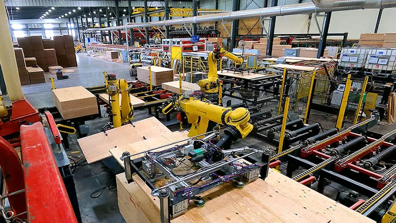

a pair of robots feed panels into the cutting system
A pair of robots feed panels into the cutting system. Each robot picks and lifts a panel with a specially designed end-of-arm tool.
Photo courtesy FANUC America Corp.

At Frere, panel units are fed into the system in two locations—one for each robot presenting panels to the cutting system. Each robot picks and lifts an engineered wood panel with a specially designed end-of-arm tool (EOAT).
“The end-of-arm tool will vacuum pick the plywood panel that’s going to be scarfed,” says Mark Matteson, sales and marketing operations analyst at PRE-TEC.
Before presenting the panel to the cutting head, the EOAT squares and clamps the panel. An on-board thickness measurement system ensures the panel is within a target thickness range. If it is not, the robot places the panel on a reject conveyor to be double-checked by plant personnel.
If it meets thickness requirements, one end of the panel is inserted between a hold-down mechanism and an anvil. Once the panel is in the desired position, the clamping mechanism activates, holding the panel down against a machined surface to reduce vibration and effects of cupping in the wood on joint quality. When the cutting cycle is complete, the robot flips the panel over to present the other end.
“The benefit there is that we’re having the same cutting head cut both sides of the panel, so we know we have a balanced scarf joint on both ends of our panel,” says Freres. “We could not do that without having a robotic application.”

Meanwhile, as the first panel is being cut, the second robot goes through the same picking, squaring and thickness checks before staging a second panel below the one being cut.
This system has significantly improved the quality of the panels’ joints, which benefits their strength and performance. Moreover, the automated cutting system has doubled production capacity, because two robots now continually feed the same cutting head. This helps optimize the manpower and floor equipment to support growth in future demand.
“We’re using two robots in a very tight space to work together, without collisions, to fully utilize a cutting head system,” he says. “With the FANUC robots, you can really control the scarf-cutting process to make sure that we are within tolerances.”
