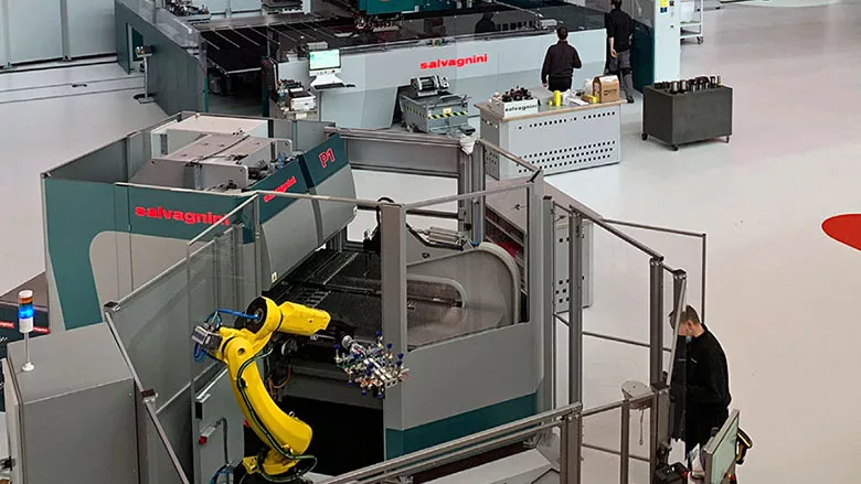

The idea of a connected, integrated factory is a pillar of Salvagnini’s approach to processing sheet metal. As early as the 1980s, Salvagnini began developing the concept of the Automatic Job Shop: a lights-out factory with interconnected, automatic machines that communicate directly with a customer’s enterprise resource planning system.
“Our aim is to create a cooperative, integrated ecosystem where machines work in synergy,” Bonuzzi says. “This reduces the occurrence of errors while optimizing the performance of the entire plant.”
To ensure seamless collaboration among operators, machines and instruments, Salvagnini prioritizes the use of IIoT, cloud software, big data and interconnectivity.
“We must guarantee high connectivity standards and secure communications between on-site sheet metal machining systems and servers in the cloud,” says Bano.
High-speed connectivity is essential for exchanging data with factory-floor systems and smart sensors. It also enables a wealth of information sharing. “Today, our machines [send production data] to the cloud, and they also transfer real-time information to each other and with ERP systems,” explains Bonuzzi. “The feedback from our customers on these initiatives has been very positive, both in terms of greater possibilities for services and the opportunity to boost productivity of the whole process.”

Another example of teamwork is a system for the cameras on Salvagnini’s L3 and L5 laser cutting machines. These cameras acquire the image of a piece of sheet metal on the worktable and transmit it via software as a drawing exchange format (DXF) vector file to display the starting format for a new cut.
“These cameras have to be powered continuously,” adds Bano. “You also need real-time communications to send video data to the system for rapid processing.”
Molex designed a new system, consisting of a single cable that connects the cameras to an electrical power supply via a switch and an RJ45 connector.
“Delivery times for this new product were very fast,” notes Bano. “In addition to reducing the size and number of cables, we also improved the speed of communications between the camera and our system.”
